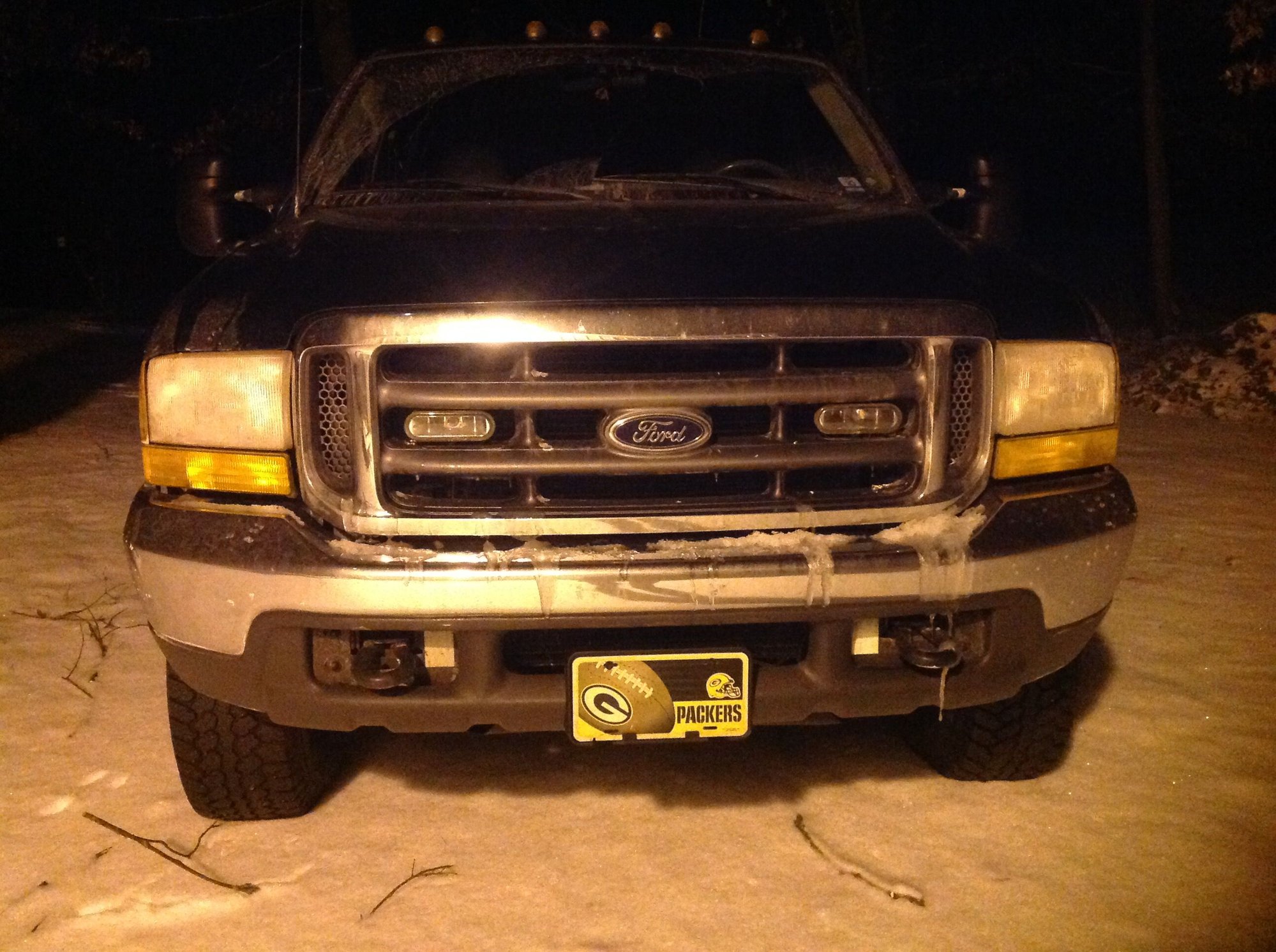

I put the Hella FF75 halogen driving lights (not fog) on my 2000. Gave a good focused beam that most oncoming traffic would not flash me if I did not turn them off. I aimed them to be just above the low beams. Very happy with them. Perfect for the dark country roads. I am going to put them in the same spot on my 2016. They fit nice in the grill on my 2016. I bought them for my 2016 but have not had time to install them yet.
