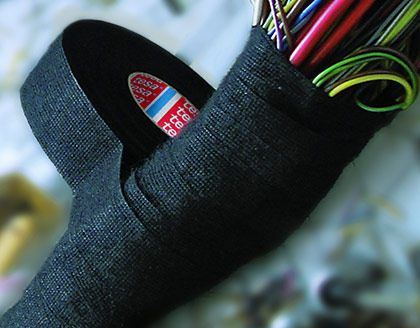

With Hartwig asking the question, there is another post somewhere where I had a table of different products. It's a deep rabbit hole within just the two most used companies in the automotive field.
I don't know if Mac used one of these two easy to acquire Tesa offerings.
But Tesa has a lot of them, and there are just the high temp ones.
On the Elliot side, again many tapes, but not the chart I had posted.
This is what the Tesa 51036 tape I have looks like. It's not the look I wanted for my harness. It ain't no friggin Audi.

51036 is what I used. It is awesome stuff, I use it on boat wiring too.

It is, just not the look I wanted. Although I had given it some thought.
How has it been with dust holding, Mac?

thanks, should be the same stuff, that I use,
https://www.kramp.com/shop-de/en/p/f...m--EM2041LT155
(english language version)

It’s slick, nothing really sticks or is attracted to it. I even stuck a piece on my vise and tried to melt it with my torch and it just stuck even better. I don’t care how it looks, I got ten rolls for $40 and it has been awesome. I even wrapped my fuel lines and power steering hoses with it.
