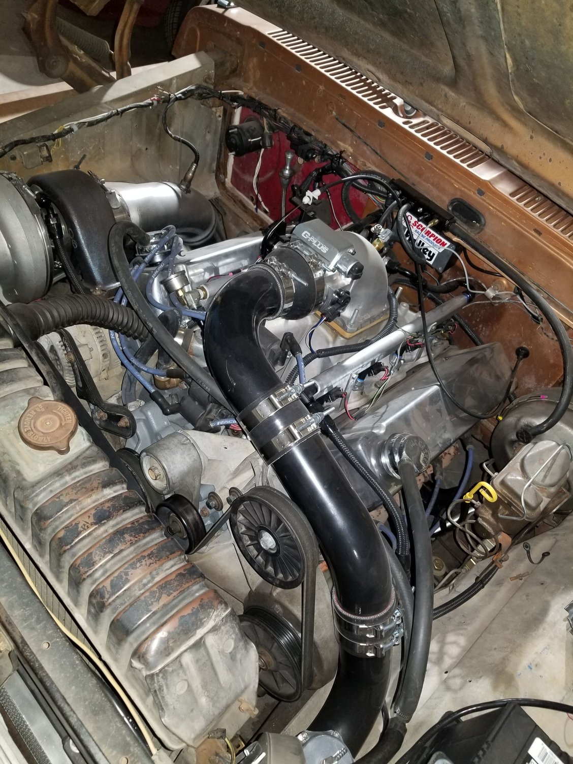

Originally Posted by jgavac
What size intercooler is that?
It's a 31x13x3
Not sure if I could fit one any bigger in there. It took some trimming to make this one fit. No a/c stuff in this truck but there was enough space behind it that I put the trans cooler between the rad and the intercooler.
