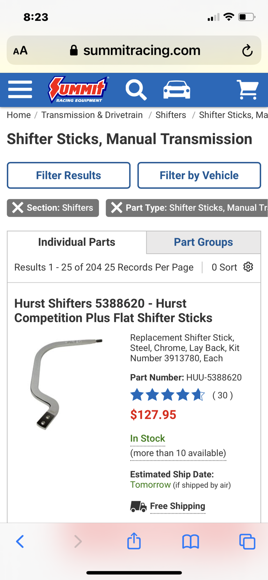

How about this shifter?
thanks
jerry

You may have seen this picture in the buyer reviews on that page on Summit's website. This guy had a 65 Ford pickup with a T5 transmission. He was happy with the way it worked out for him.
https://www.summitracing.com/parts/huu-5388620
