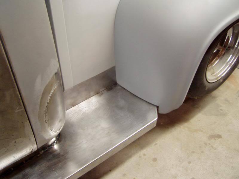

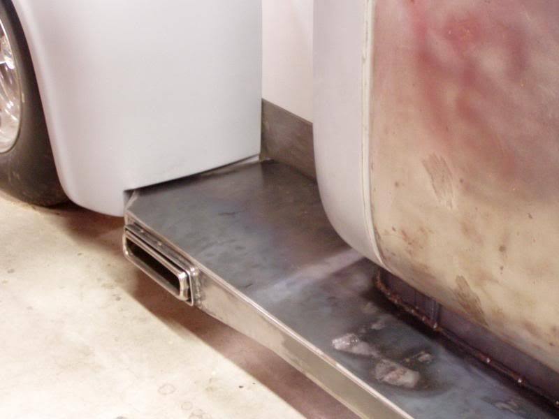

I built mine out of 14 gauge steel. I made patterns out of wood and masonite, cut my steel to the patterns and had a local metal shop do all my bends on their hydraulic brake.

Yes that is what I will be doing. I love the look of the smooth running boards, exp. what Drewski has done. Someone else here has done it as well, don't remember his name. Red and black truck, long box. Putting in an LS this winter. Going to copy some of that plus my own ideas. Copy is the best for of complement, isn't it?
Will get a local shop to bend up the metal and then start welding.
Thanks guys

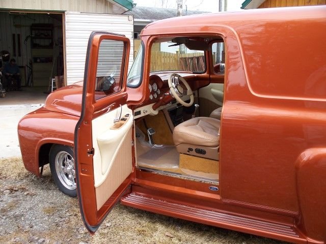

That wasn't me Ted, I like the ones on my panel but I did have to put my own supports on them.

This is the only picture I can find at the moment but yes I installed Smart Strips. They are sold in 3 different profiles and have evenly spaced ( 8 inch apart ) set screws and nuts. They are made of aluminum .
