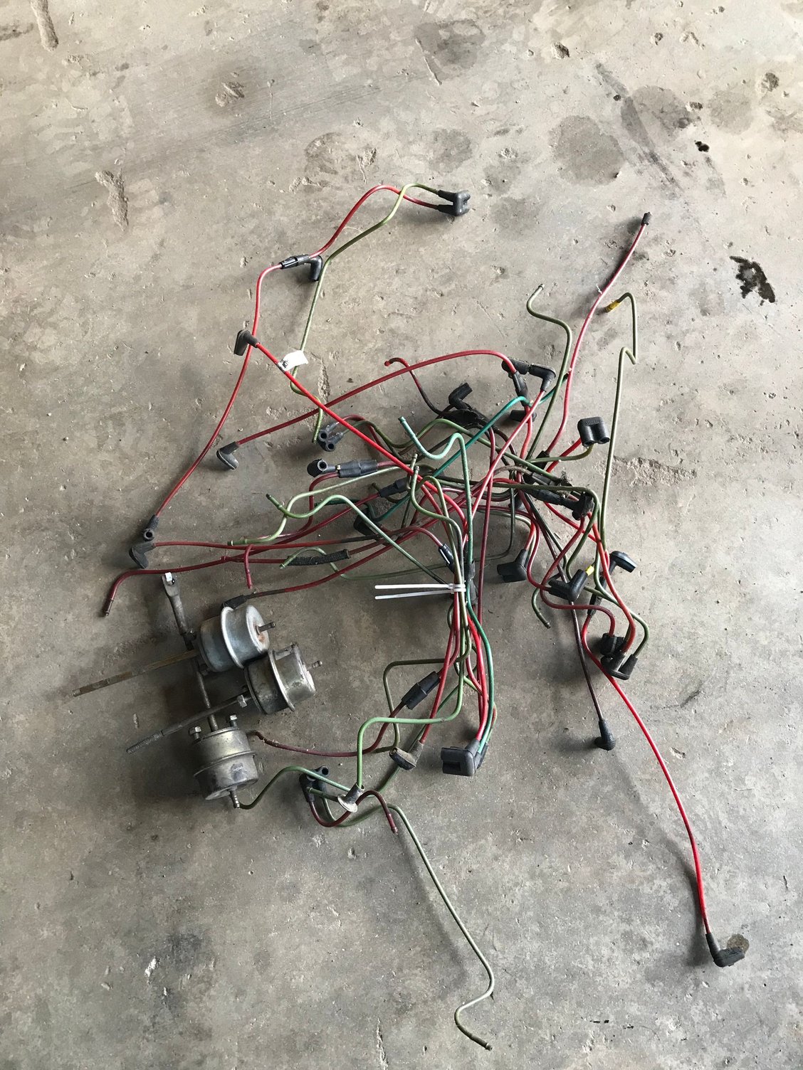

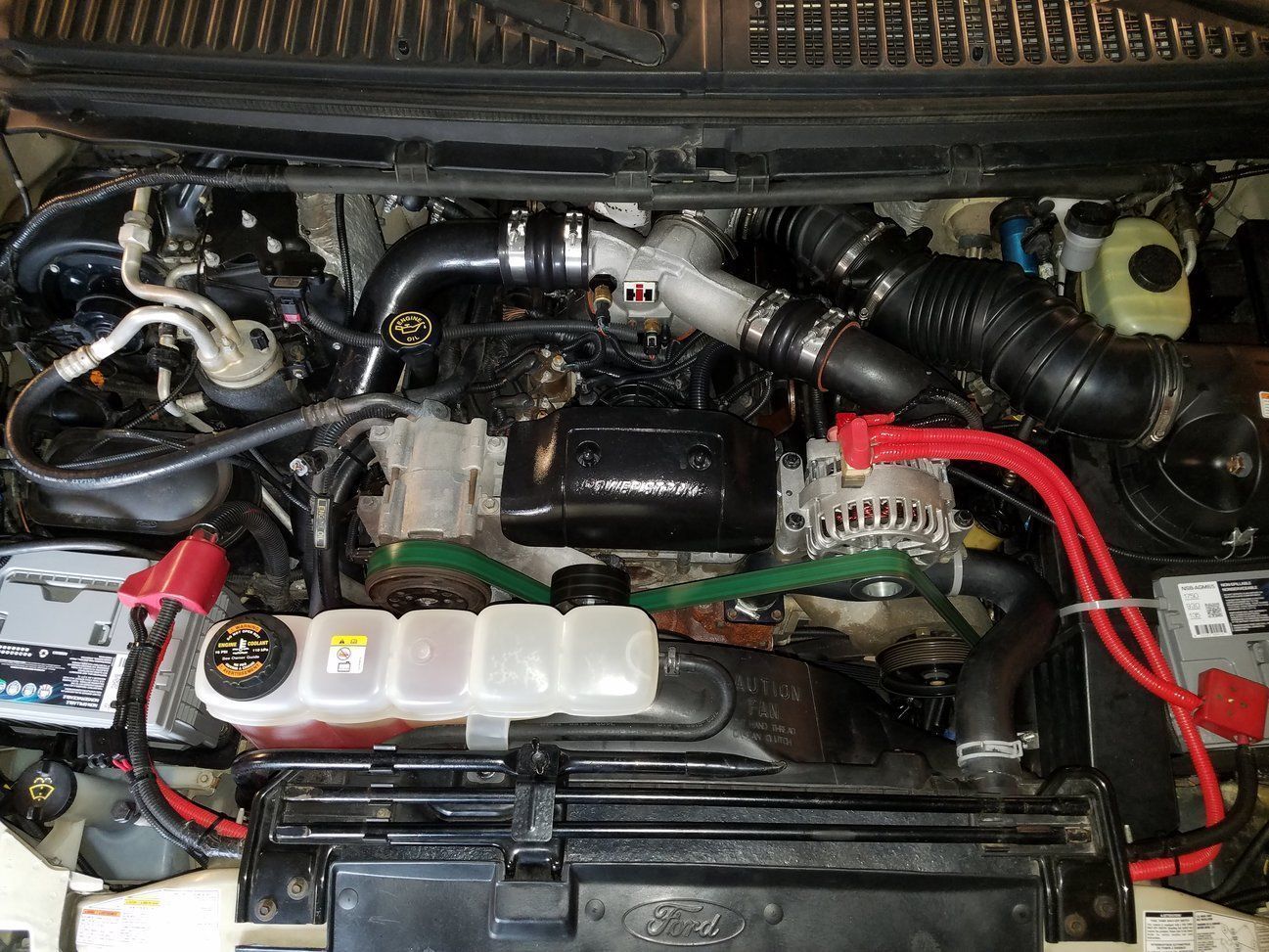

Years ago when I still had the OEM spider and removed the red/green lines, I dressed the spot up a bit with a 2"x2" IH hat pin as seen in the picture below.
