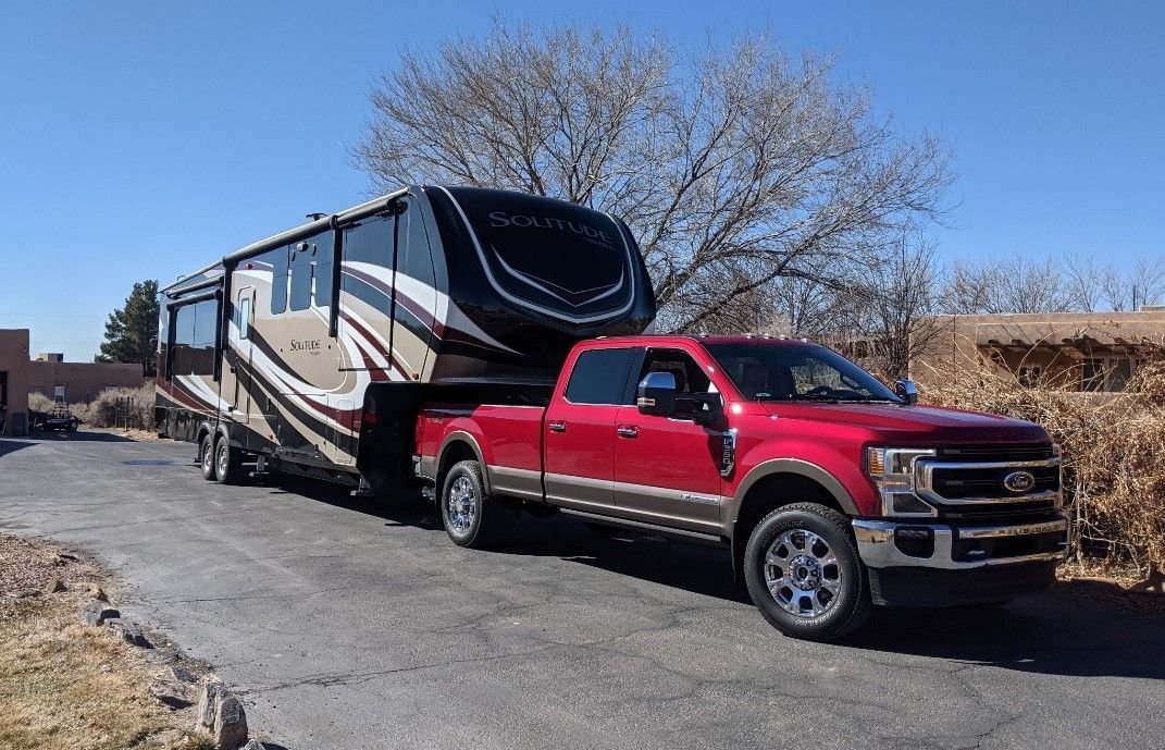

Originally Posted by Blkdane
Had my new truck a few weeks. Had airbags installed. Tow a large 5th wheel. Downsides to installing a front leveling kit ? Or leave it alone.....??
How level is your current setup right now? Can you post pics of your trailer hitched?
Old Feb 15, 2021 | 09:25 AM
Blkdane's Avatar
Blkdane
Joined: Dec 2020
Posts: 207
Likes: 39
From: Corrales, NM

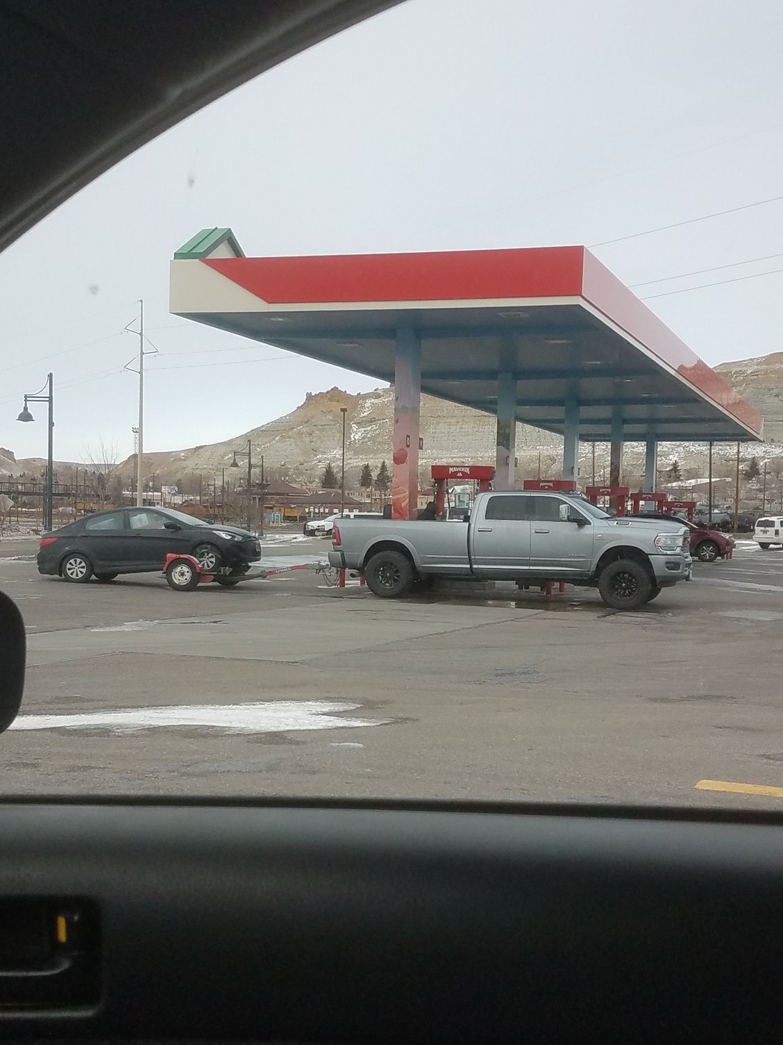

Originally Posted by muhford
If you level it and then tow a 5th wheel your truck will look silly. It's supposed to have some rake while unloaded. Engineers didn't want it to be level. Leave it alone.
im seeing this nonsense quit a bit. this guy has only a uhaul dolly and the truck sags atleast a 1in or more. whats most shameful is uhaul dollys have almost no tongue weight by design
Old Feb 15, 2021 | 08:55 PM
muhford's Avatar
muhford
Joined: Mar 2014
Posts: 1,268
Likes: 127
From: Missouri
A Dodge towing a Prius with a rented dolly? That man has no shame.
