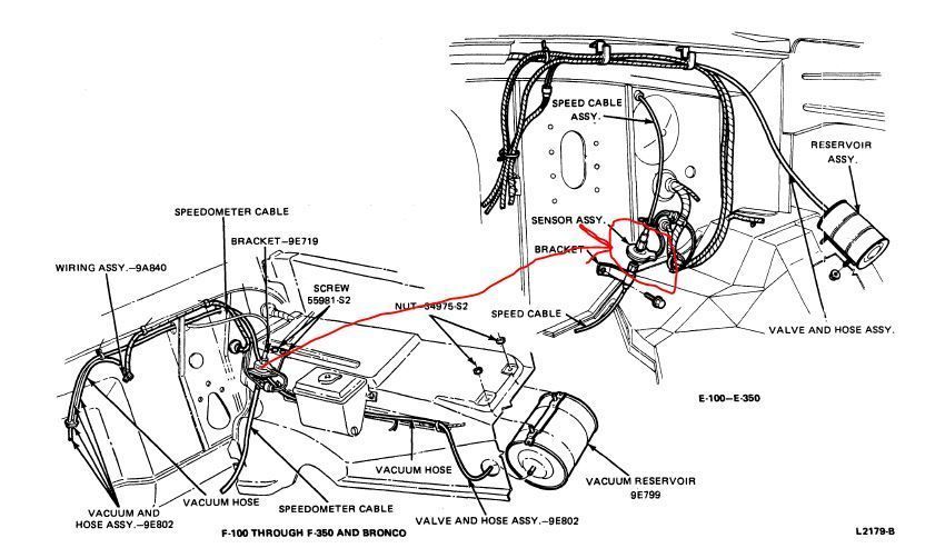

If you can not get the one to go from the cruise control round piece (under the hood with a 2 wires sticking out it) then here is a way to research just a whole cable. Nice truck BTW.

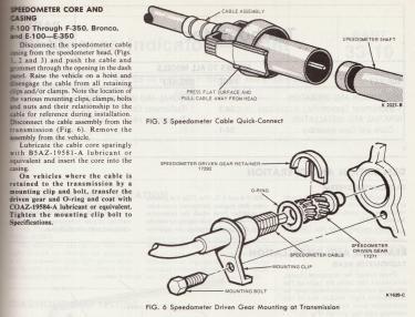

Maybe some help?

So you have the lower half and just need from the speed sensor to the cluster...
