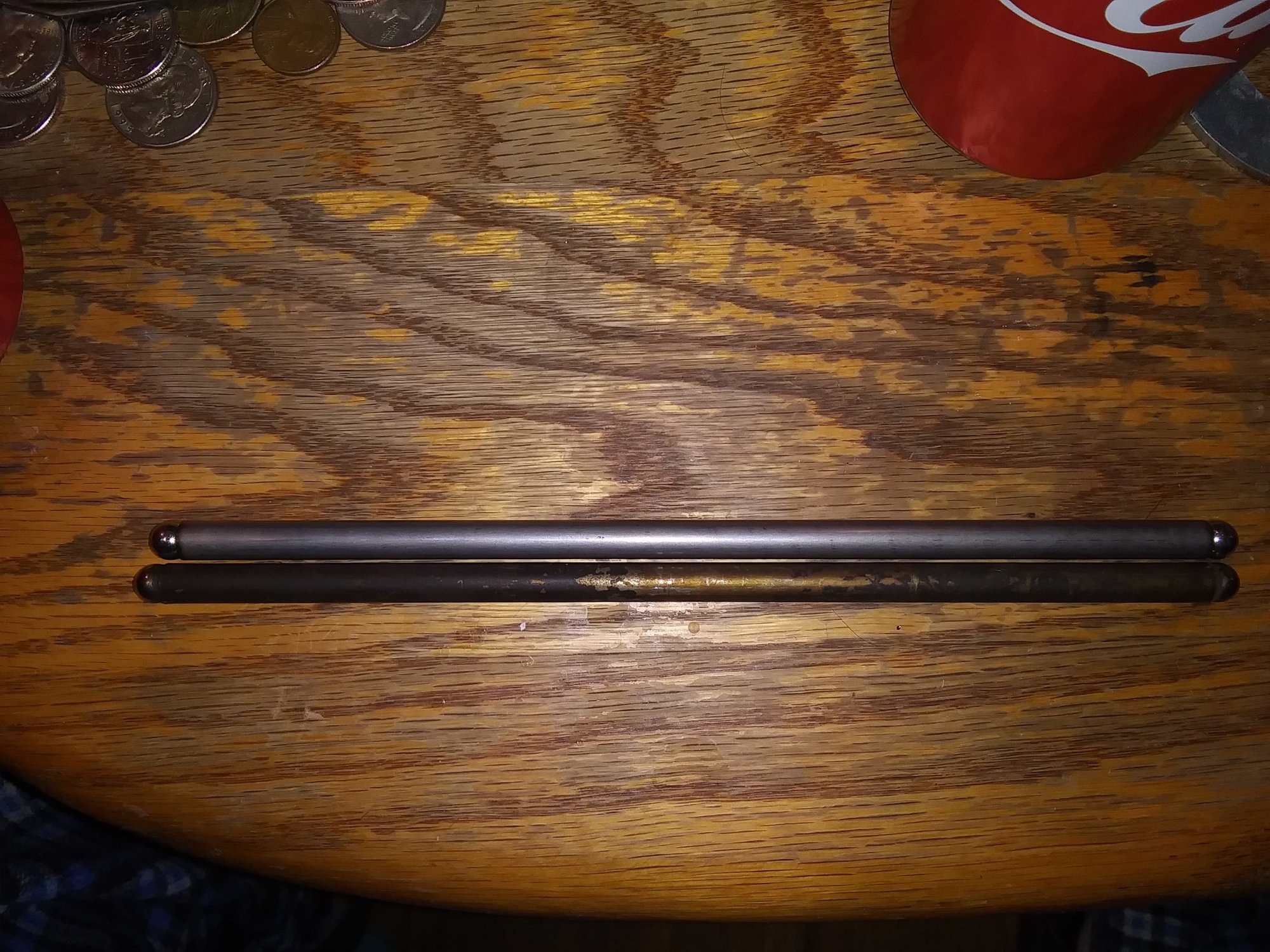

This is a comparison between a pushrod from the engine and a melling MRP-274 8.55" pushrod.
Yeah, I think I'm going to go with the 8.67s I ordered from summit. They should be delivered today, I'll have the weekend to mess with it.
As said, engine now turns over fine after lubing and new battery cables. I think the ratty battery cables were the main culprit as to why it wouldn't turn over by the key, but I would not doubt if the cylinders used to have a rust ridge. After all, it sat for 30 years in a driveway. The engine may have been over revved due to losing the transmission, the atf doesn't look great. Only way to know for sure is to fire it and after letting it warm up a bit see if it will move. If not, since the trans may have to come out the engine will as well. Its a very clean car for being in the rust belt, only needs 1/4s. Floors, frame, doors, and front clip are 100% rust free.

It seems that the pushrod length is different with different rocker arms.Base "Thunderjet" engines use cast iron "rail" rocker arms and 8.67 pushrods.(some were listed as 8.70). CJ/SCJ/PC engines used stamped steel"conventional" rocker arms and 8.55 pushrods with guide plates..All these rockers were stud mounted. In1972, they changed to a pedestal mounted bolt on rocker,which shows a pushrod length of 8.60.

It runs.
8.67 seems to work.
