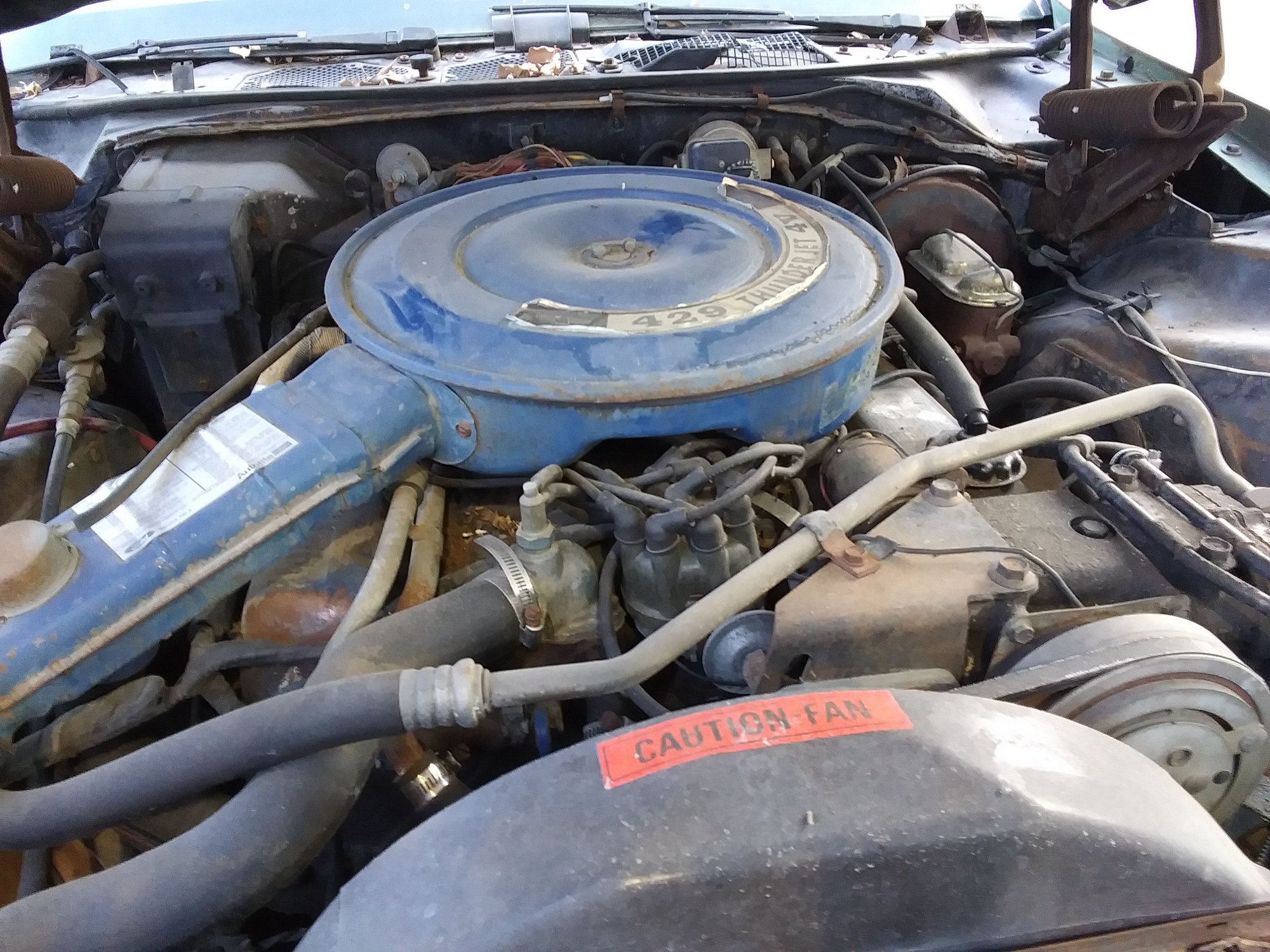

1 - I still say that the 1971 429 engine had original factory length 8.55 inch pushrods...(as stated that the cylinder heads on this engine do show D0VE-C casting)...The two pictures shown seem to look as if everything is very original (and engine dry and not ran in a while)
