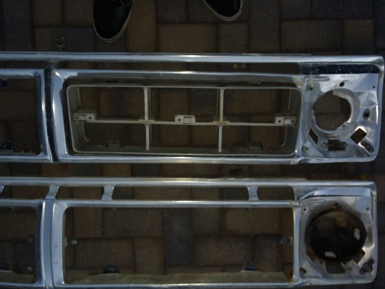

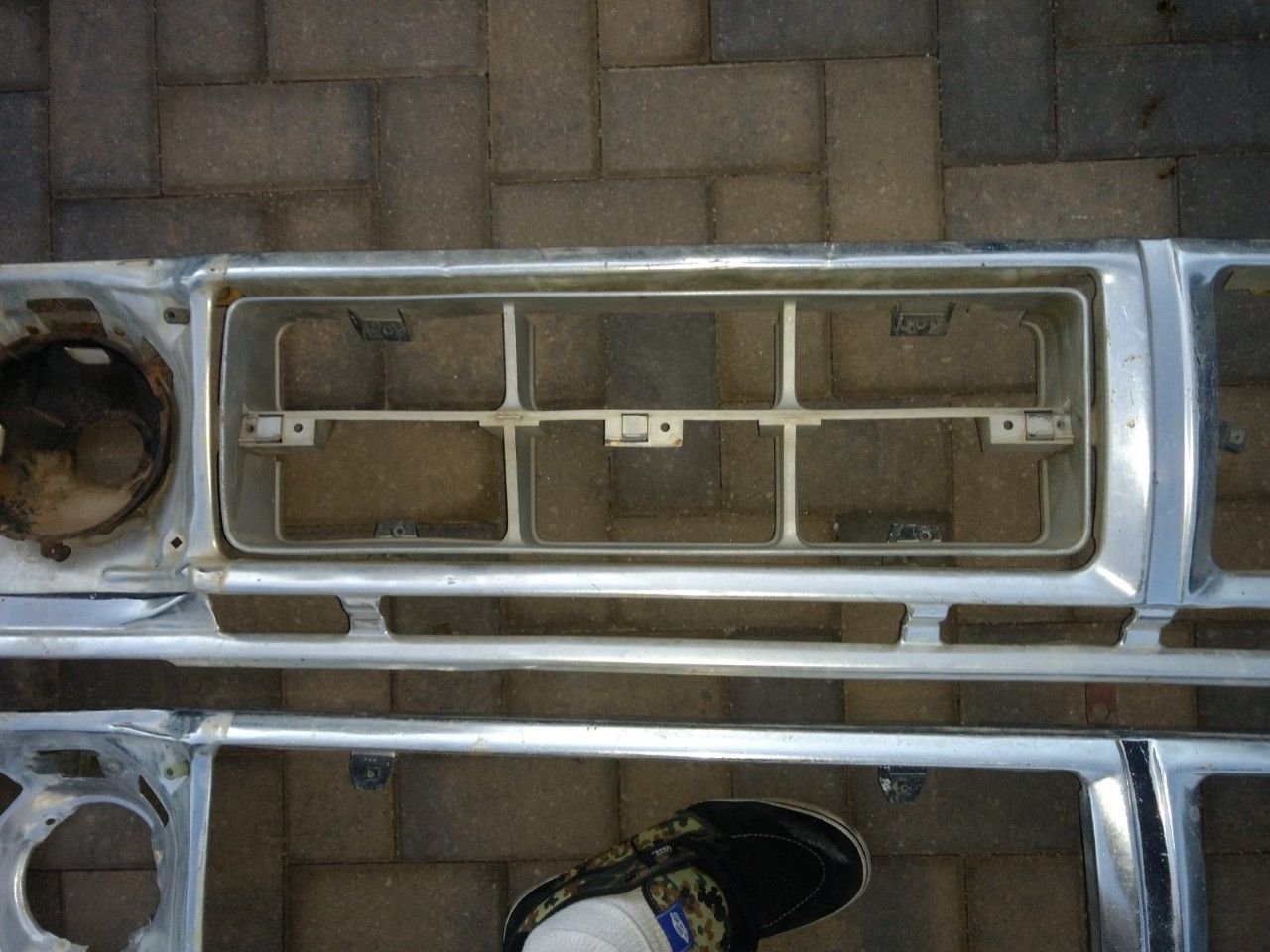

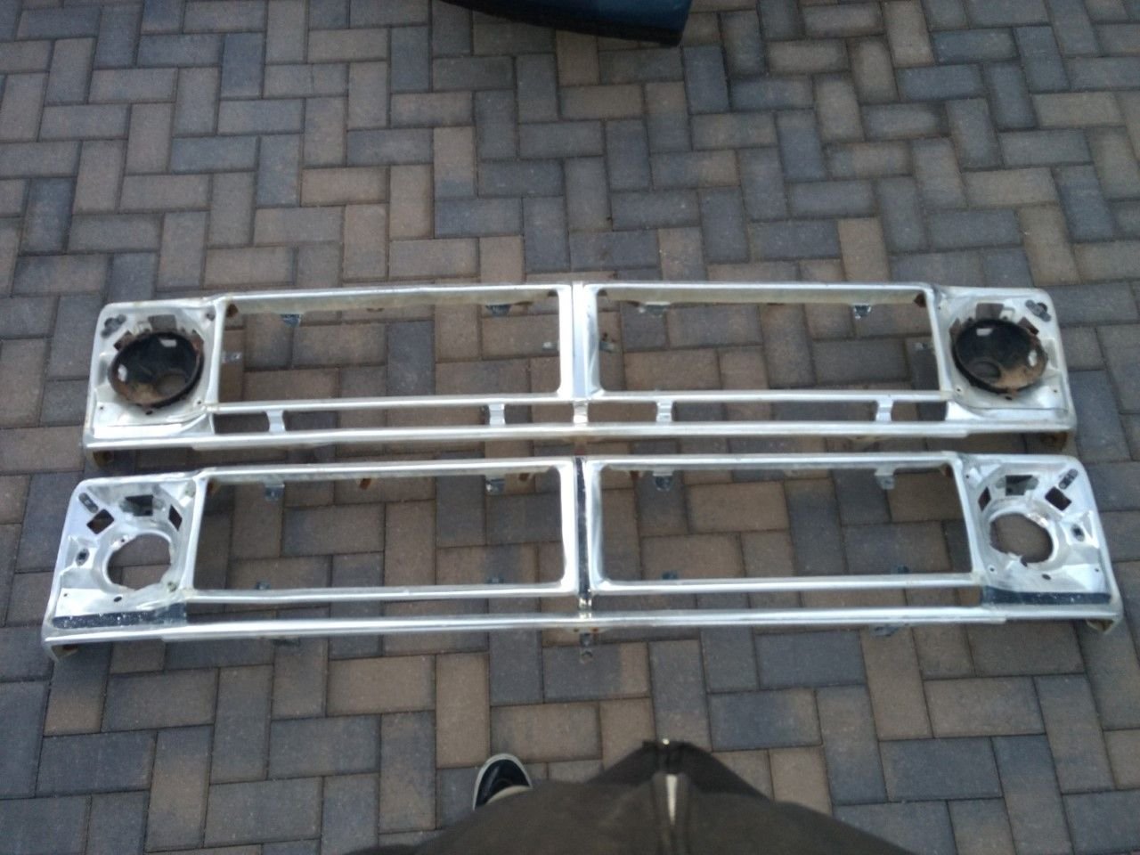

After saying it sounded like it wouldnt work, I dug out my two grilles.
I thought I had a 72 and 70 grille but it is a 71 and 70. Same difference. 71 on top and 70 on bottom. I measured the insert openings and they are basically the same. The 71 is deeper and has one mounting tab on each side of the inserts additional to the regular four tabs as seen on the 70 grille.
The second pic has 71 insert in the 71 grille.
This pic below has the 71 insert in the 70 grille. Not sure why it went upside down but the insert sticks out. The main four holes line up as well. I imagine if you tried to adjust the tabs out for 70 inserts you would have to re drill holes or let it set in deep.
Thanks for taking those pics! Based on those, seems to me there’s no reason 70 inserts can’t work with a little persuasion. I’m going to give it a try and post how it goes here.
