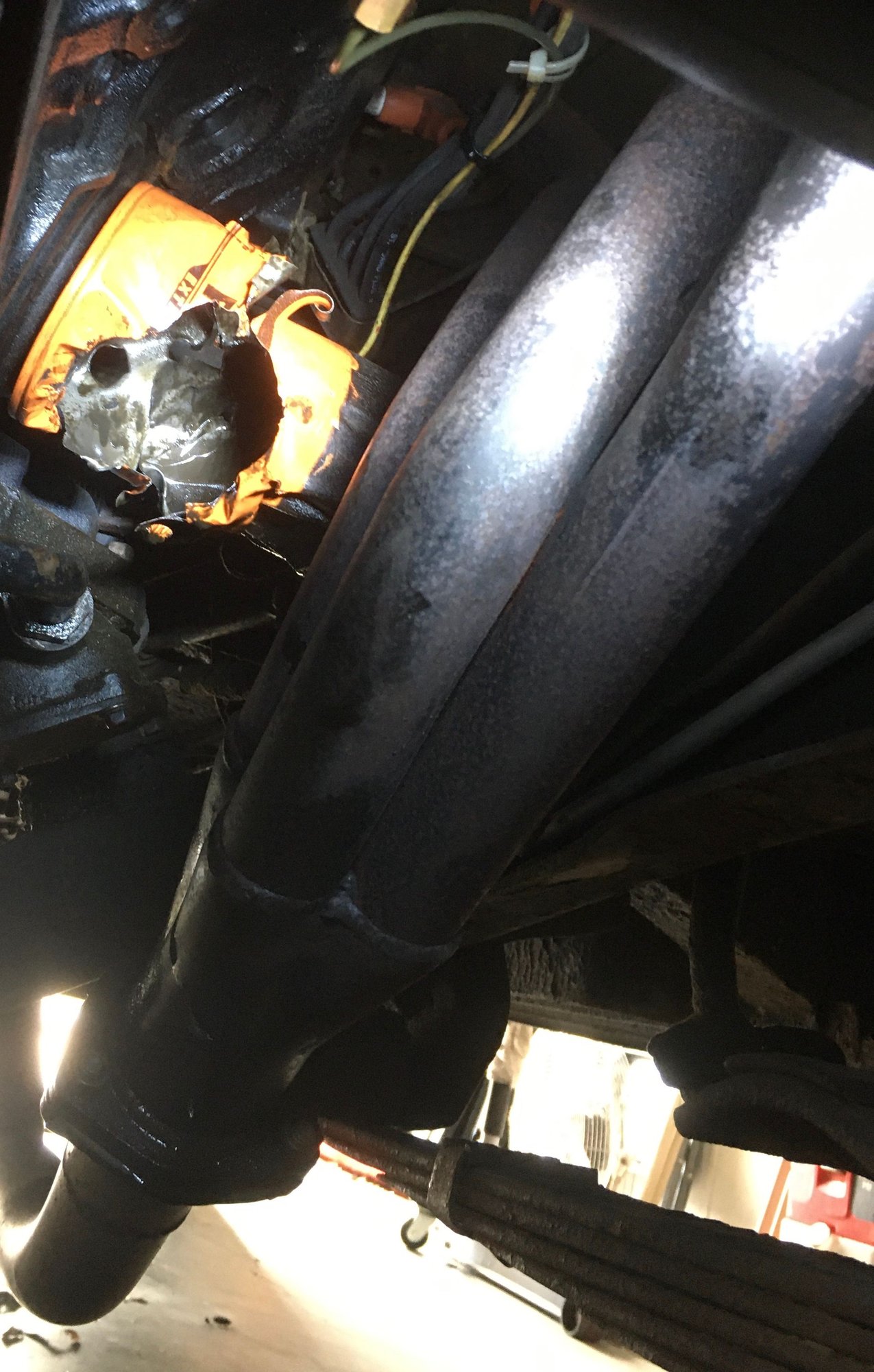

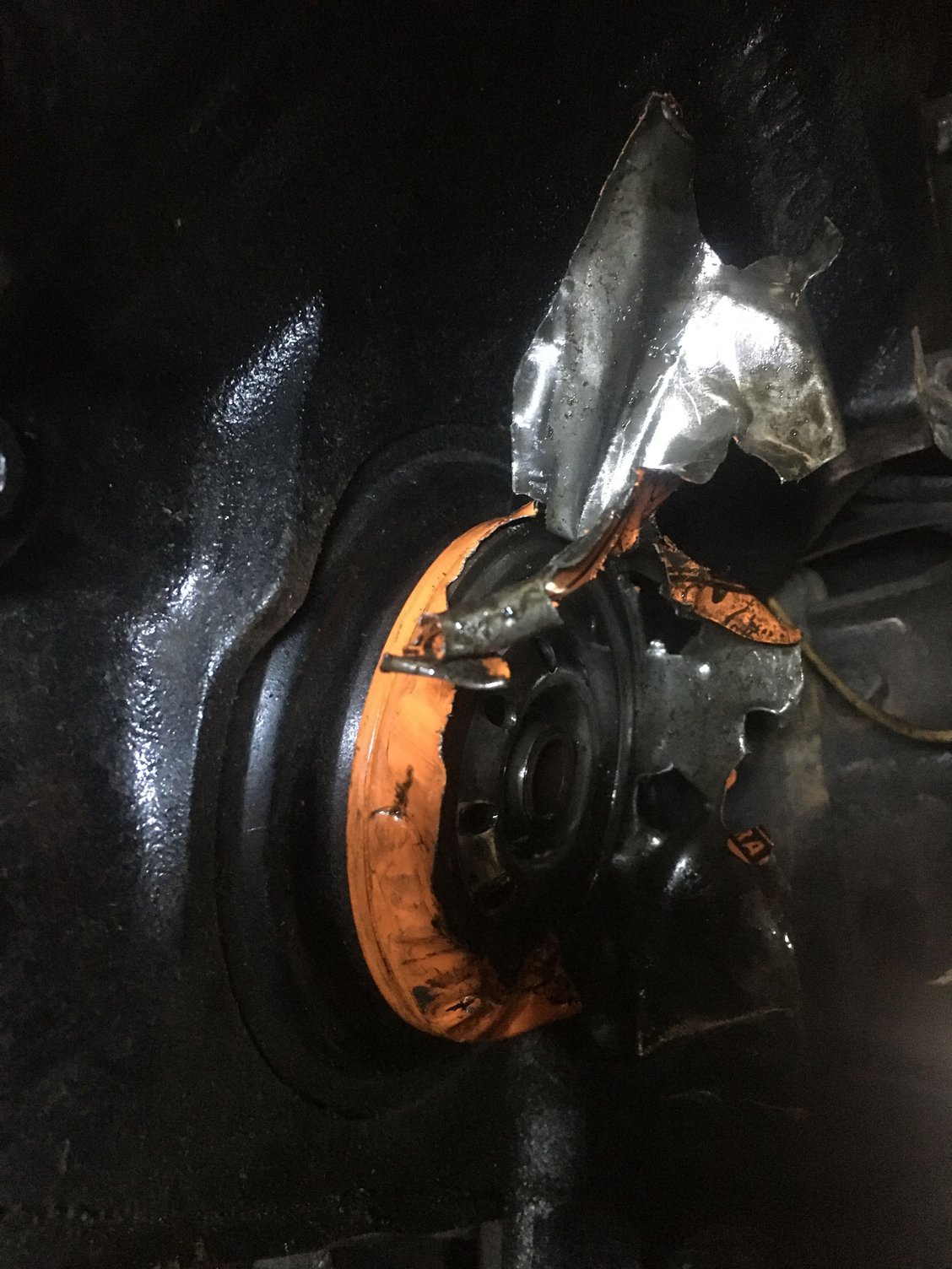

Originally Posted by wtx66f100
What tool did the mobile mechanic use to remove it?
it looked like a “castle” top tool, to grab the top holes? . It looked home made but I’m not sure, does a tool like that exist? It might help the next guy!
I am thinking it may have been a perfect storm, a low quality oil filter and a low quality oil filter adapter?
Thank you for everyone’s help!!
follow up pictures!
enjoy!
