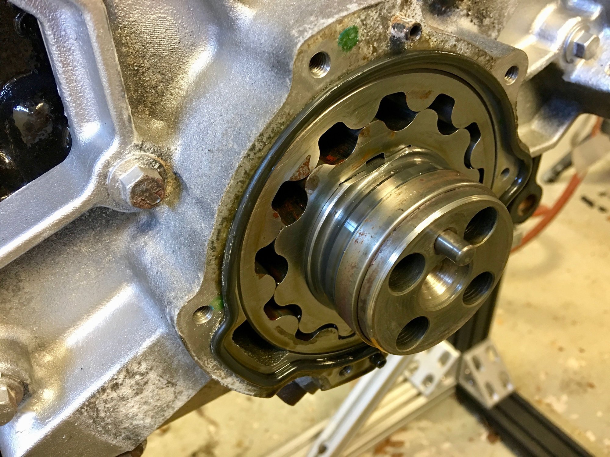

This is how mine was and what the used crank surface looked like underneath.
Using a sharp chisel is not the way to take it off. I did what I've seen done for 30 years on axle shafts in fleet garages, and what we did in my test facility. Use a flat hammer, ball hammer, or a rounded surface to tap (I'm using the word tap) around the ring to dimple and expand the sleeve enough to slide it off. It took me about 5 minutes.
