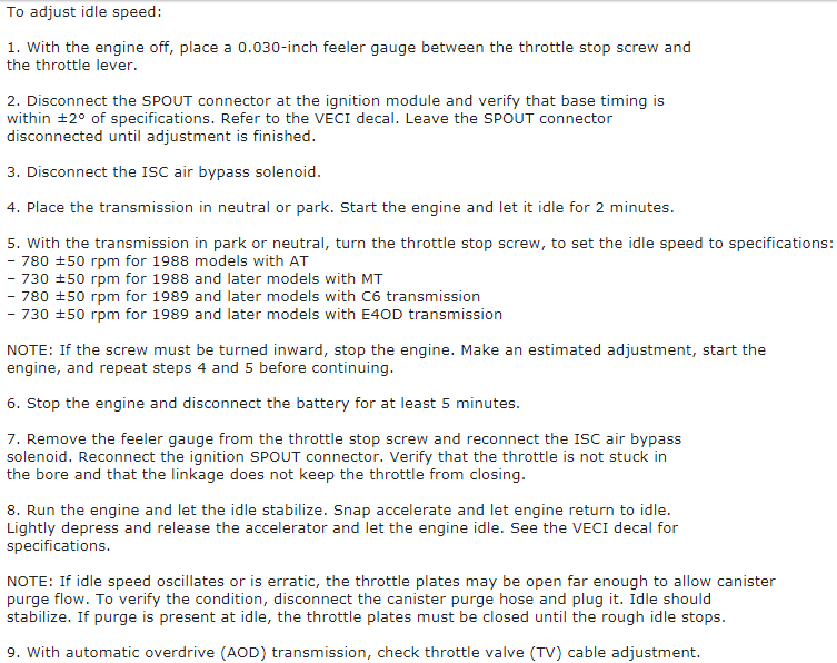

You did pull this? (not my pic)

for future reference
When I set the base timing,yes.
