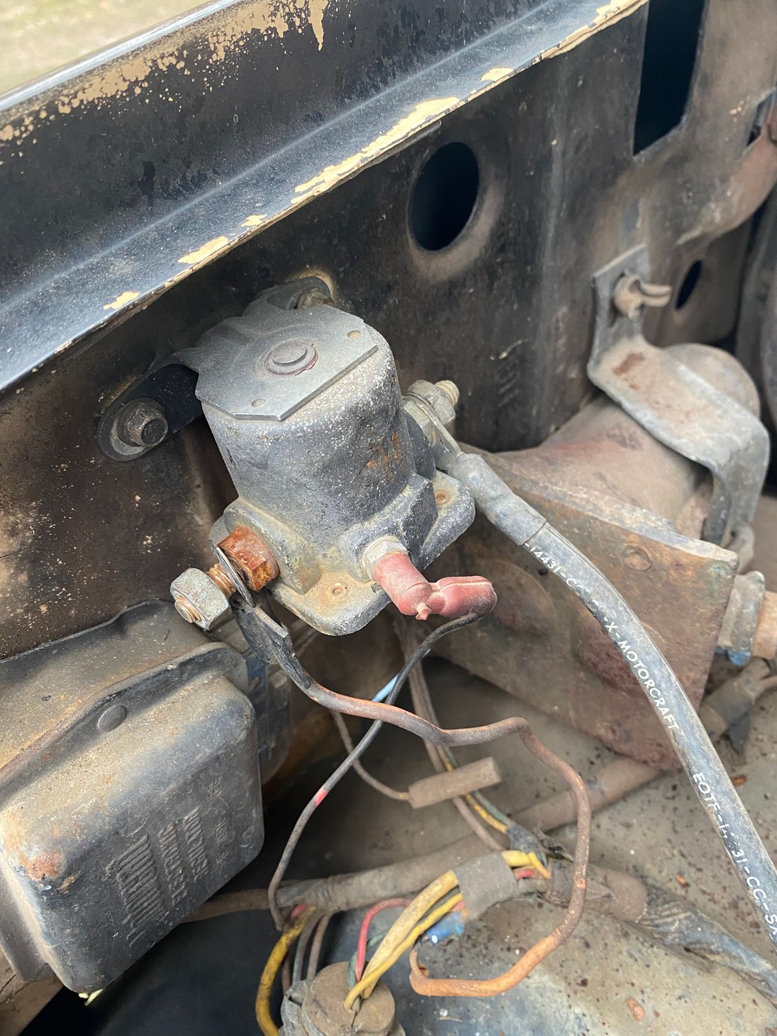

This is what I have it would make sense maybe for the high torque starter the person who found me the same starter said it was off a 1975 460
You do not have enough wires on the solenoid. Where does that big fat black wire go ? To the battery +? If it does, you need to go buy another big fat wire and hook it to the other large post and run it down to the starter.
