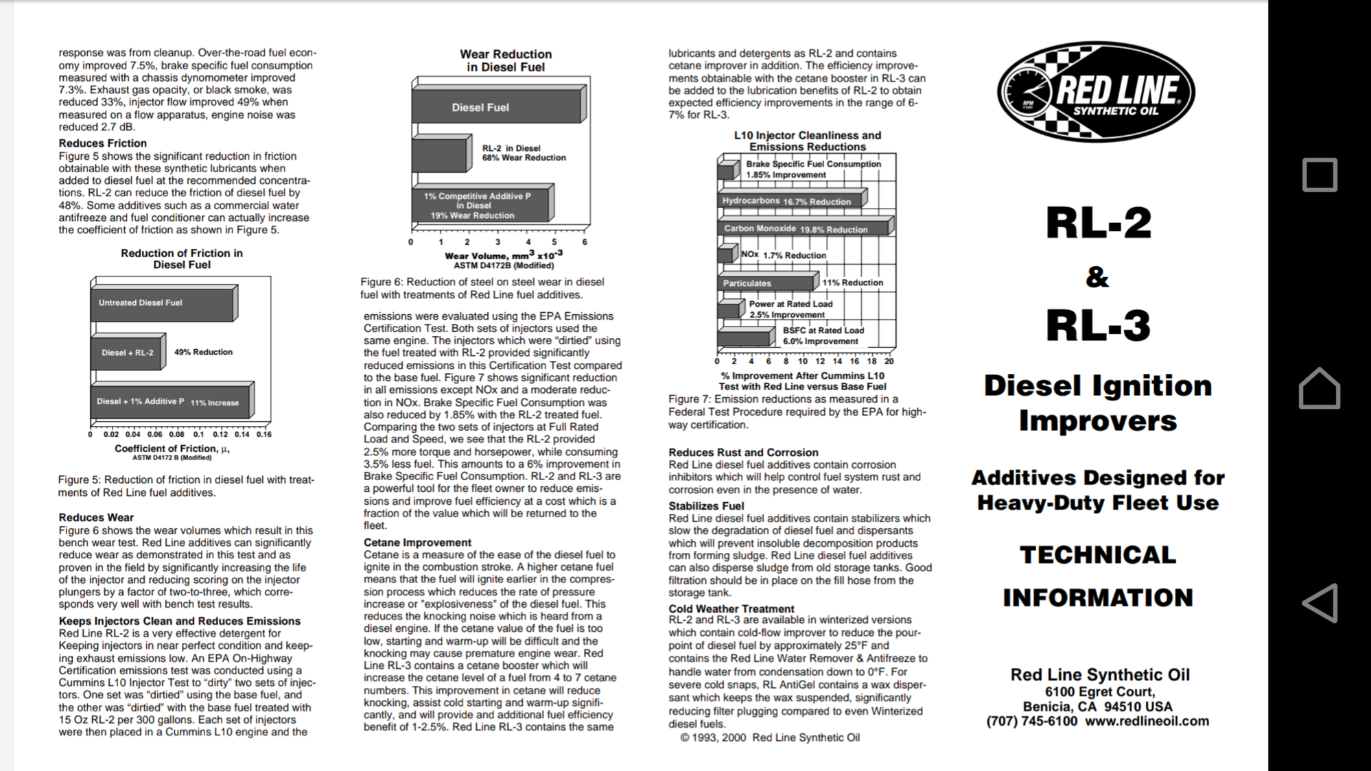

Also there's been talk about OptiLube etc..
I tried to search but i don't have an access to OptiLube from Europe.
But RedLine RL-2 is what i can get from nearest Motonet store,for example..
Don't really expect to gain any "noise reduction" or fuel mileage..
Just trying to compensate the filling from fleet container..??
All opinions and experiences are very welcome!

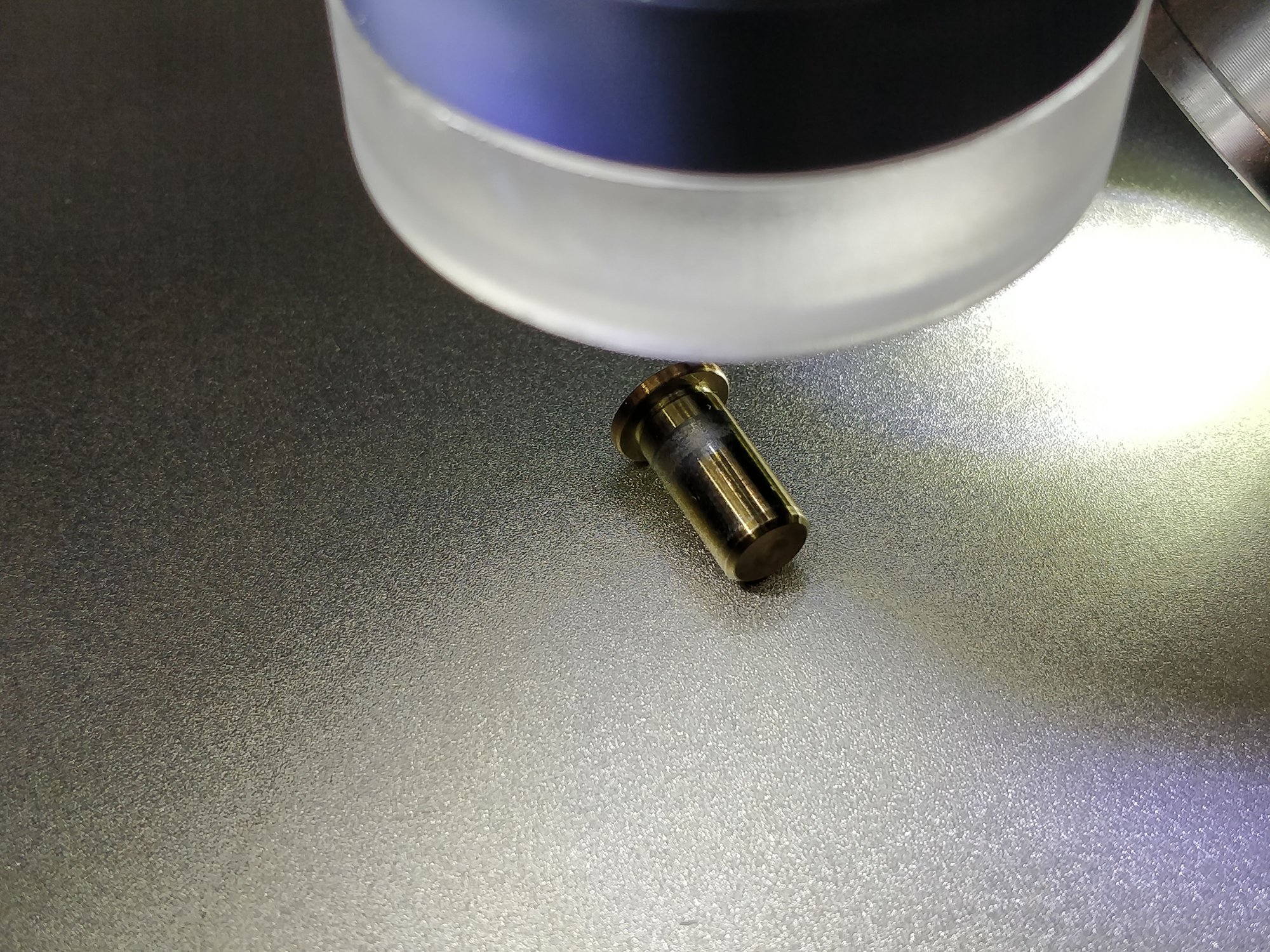

The FACTS about ULSD and lubricity are presented based on scientific and laboratory testing in post #56 in the form of "Diesel Fuel Lubricity Additives Study Results". These results were not gathered or identified based on personal opinion, hunches or feelings. I too am skeptical of what benefit a fuel additive can have on our 7.3L PSD's, but no one can deny the results gathered and presented to us in the spreadsheet, which I have linked again below.
I will take a moment and go through a couple of the details and what the results of the study are telling us, the layman. If you are interested in broadening your knowledge base instead of surviving on internet myths and what someone told you one time online, read on.
Looking at the spreadsheet below, the first three rows set the stage with "Desired, Standard and Baseline". Looking to the right to the "comments" section, you can clearly see what these three are identified as. Moving further down the spreadsheet, the heavy hitter and what focus should be applied to is "HFRR Score".
HFRR refers to a device used to measure lubricity and stands for "High Frequency Reciprocating Rig". Basically, the lower the number in the HFRR column, the better the lubricity properties are of the additive.
Looking back at desired which is < 460 and Standard which is < 520, you can start to get a gauge of what the ULSD in the pump you are getting is rated at in regards to lubricity. Turns out that the tested and baselined ULSD in the study came up with 636 as an HFRR score. 636...
That means that the ULSD used in the test was nearly 200 points above what the "desired" HFRR is score set by the Engine Manufacturers Association and over 100 points above "standard" is for ULSD.
Looking further down the spreadsheet, still in the HFRR score column, we start to see products sold by companies that seemingly make outlandish claims at times. I ran Stanadyne Lubricity Formula for years. I did NOT notice a difference in the way the engine ran between when I used it and when I forgot to use it. I did this over thousands of miles and years of time while traveling the country towing heavy at 18,000 lbs or more GCVW. It is what it is and I stopped using Stanadyne because I am lazy and it was better for my budget. Hearing about the XPD and Stiction RX has peaked my interest though, and clearly a few others interest has been peaked as well.
Some people take action based on internet lore and myths. Like low and high voltage IDM's from the factory... Myth...
HPx is a great modification to install... Myth...
Etc...
If you are one of these people, ride on and do what makes you feel at peace. You are the most important person when considering what to do, or not to do about your 7.3L and the condition of which it is in.
Other people enjoy learning about the details and differences between various choices and making informed decisions based on facts and analysis.
If you got this far and are interested in learning about facts and analysis, the HFRR score column is what you should be focusing on. The LOWER the number in the HFRR column the BETTER. Clearly you can see Stanadyne Lubricity Formula down there at #8 with a HFRR score of 479. Looking up to position #2, you can see Opti-Lube XPD with a HFRR score of 317. As Matt at BDP said earlier, Diesel Kleen is middle of the road and is at position #10. Diesel Kleen is worse than Stanadyne based on facts and analysis.
Opti-Lube in position #2 is at 317 for an HFRR score. Since that is the topic of discussion of this thread, well the new topic of discussion based on the results from jstihl and RyeThomas. The other columns now come into play when considering an additive. The blend ratio is related to diesel fuel : additive. Opti-Lube claims 256:1 for a ratio of diesel fuel to additive. This is important because you want a high ratio in order to keep costs down based on relative cost of the fuel additive. If the cost for the additive is less than the competitor, but the ratio is more, then the cost may actually be more. If cost is not a factor for you, then roll on with whatever you want, or don't want to use.
The next column is does oz per 26-Gal tank which is fairly self explanatory. 13 oz of XPD, seems easy enough. The next column is MSRP and I don't know for sure when this study was completed, so that is an N/A column in my opinion. The last column is comments, which is just quick notes or details about the additive. So, based on facts and analysis, not personal opinions or hunches it is clear that XPD will greatly enhance the lubricity of the fuel. So much so that it brings the fuel to better than TWICE the lubricity of the DESIRED and nearly THREE times the lubricity of the BASELINE tested.
The kicker is the "additive" in the #1 spot... Biodiesel is not federally regulated or mandated at this time though, so observations may/will vary.
What does this really mean? I don't know for sure other than the Opti-Lube XPD does a good job of providing lubricity, which the Engine Manufacturer Association sees fit to set a minimum of 460 in the HFRR scale. What was the 7.3L PSD designed to have as an HFRR score? I don't know...
Does this mean that adding Opti-Lube XPD to a truck running Wal-Mart SuperTech diesel oil turns it into a better oil than Schaefer's, Triax or Rotella, I don't know... Maybe that is a discussion for the Stiction RX additive... Maybe Stiction RX is a better choice than the all mighty Archoil 9100 (or whatever it is), I don't know... Does this mean that XDP is worth the cost of admission, I don't know...
What I do know is that without dissecting these facts and analysis results, I would never even have the chance to know.
