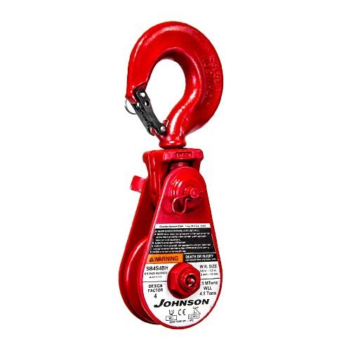

Carry a "****** Block" with you. Rig a "2 Part Line" and this will almost double the capacity of your winch.
Hobo

For your use 8k with a ****** block, high quality screw pin shackle and some extension rope would be fine. Don't cheap out on the ****** block,

Don't forget winch ratings are with only one layer of cable on the drum. Another good reason for using a ****** block.
