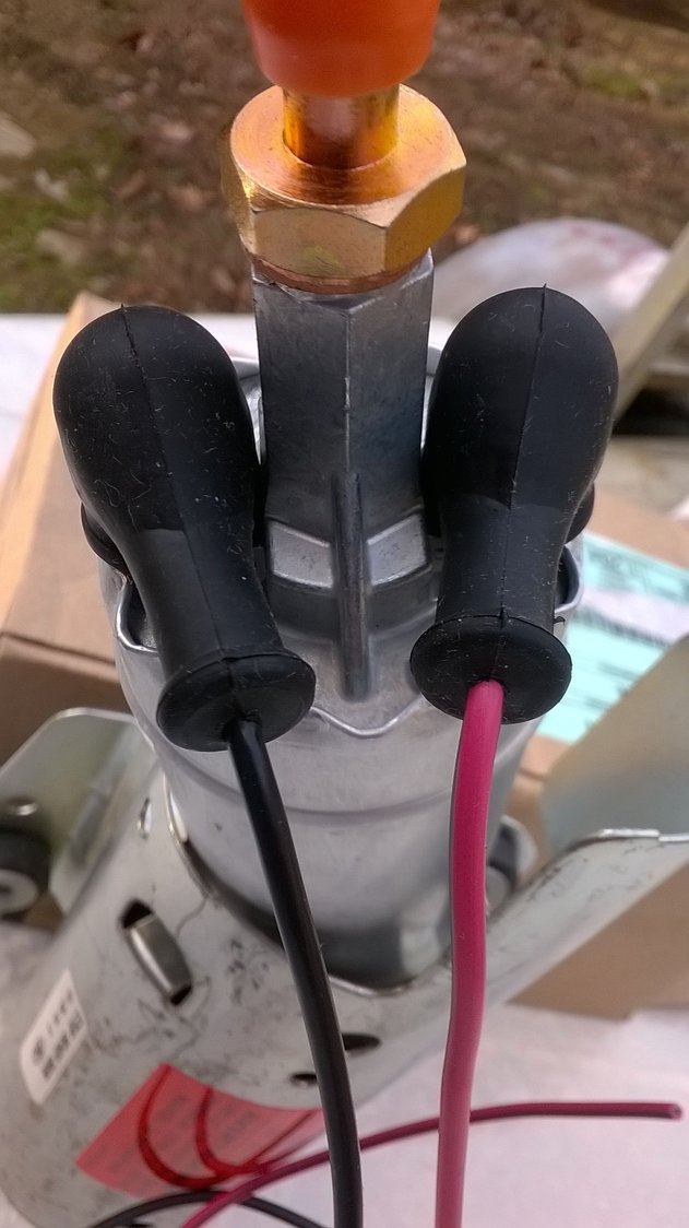

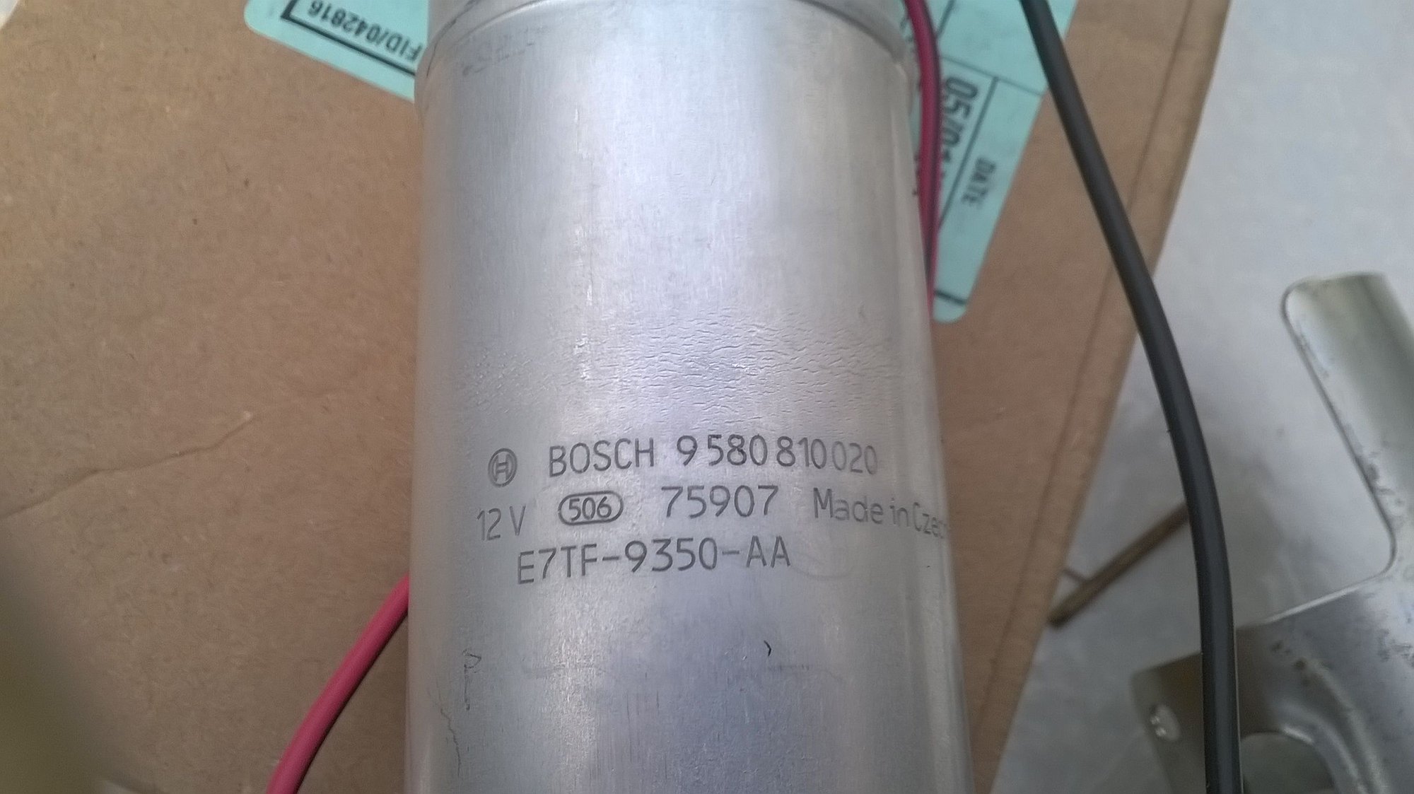

I came across the original Motorcragt PF-5 pump which is normally over $300 but I found it for around $100. Being that it was cheap I contacted Ford and sent pics to their counterfeit group. They told me it appeared to be real. I discovered it too is a Bosch pump.
Here is a pic of my pump out of the housing so you can see the pump part numbers stamped by Bosch
I suspect that if the pump is leaking, it would be around the crimped housing.

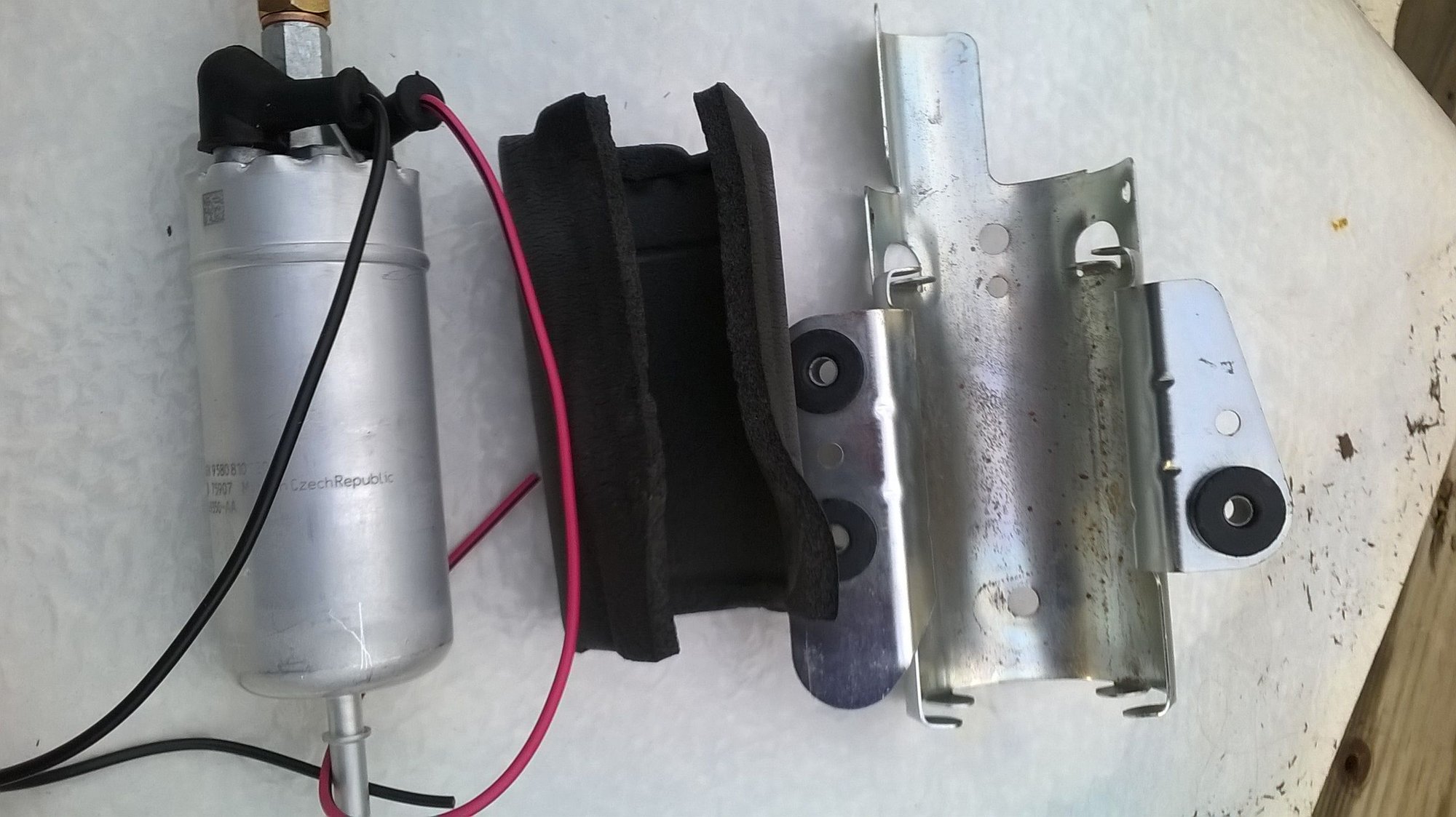

a couple more pics for you
And the Bosch pump can be bought on RA for a lot less then the Motorcraft pump but it is a different part number. I remember trying to trace the ford/Bosch part number an it didn't match anything aviable

I guess fuel pumps are one of those things everyone on here says to not cheap out on. Should I play it safe with the Bosch or is Delphi a fairly reputable brand as well? I thought it was interesting the padding that's included with the bosch pump seems so small and thin compared to the one that comes with the Delphi pump I linked to. I suppose I could potentially use the old padding on my current pump if the Bosch one is too thin.

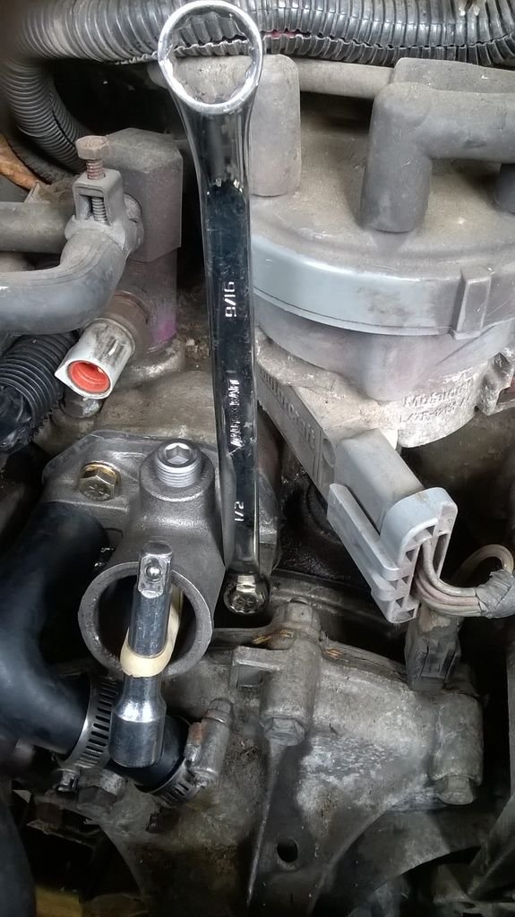

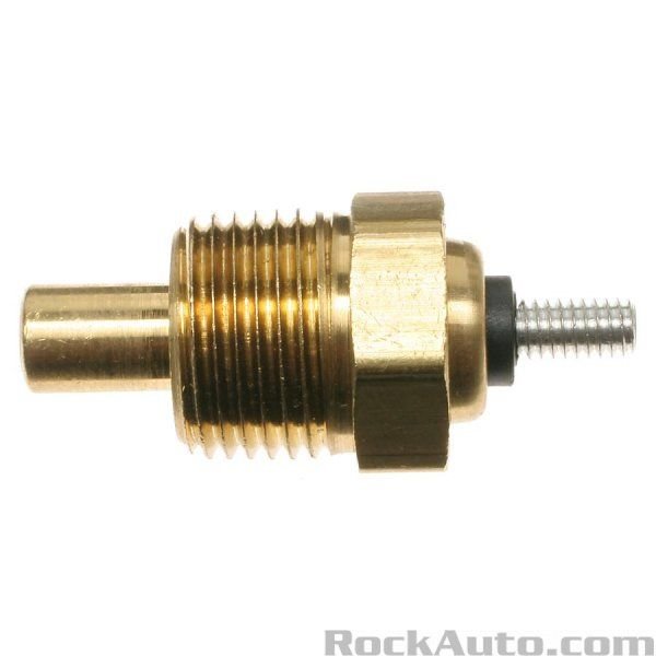

This pic is from when I broke a bolt while changing my thermostat. The ECT sensor is the disconnected sensor with the white plastic housing and orange rubber seal just below the heater hose. The ECT sends the engine coolant temperature to the ECM.

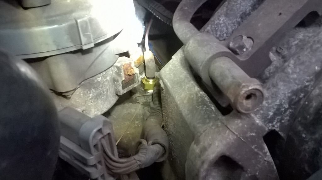

here is a pic of the gauge temperature sending unit just to the right of the distributor and behind the AC compressor. Brass and screws into the intake intake manifold

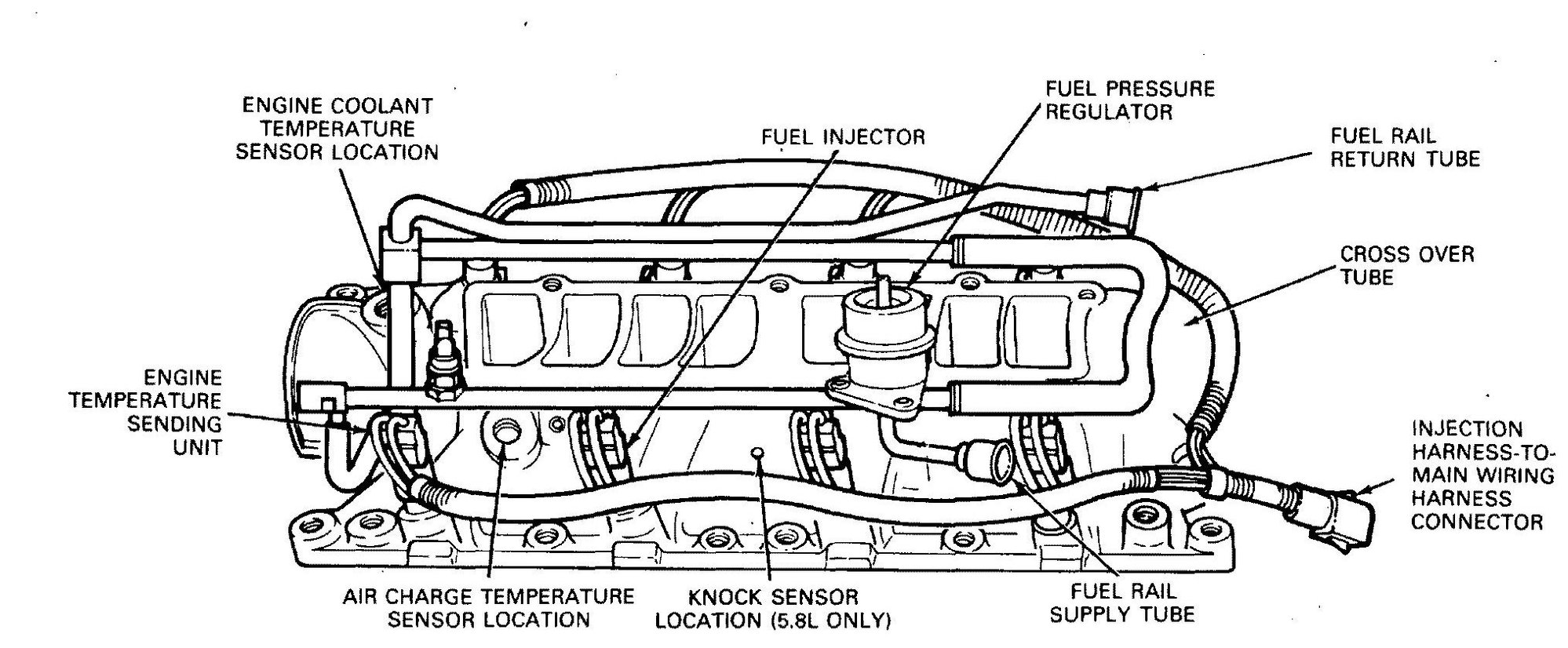

Here is a diagram of the intake manifold and shows the approximate locations of the sensors

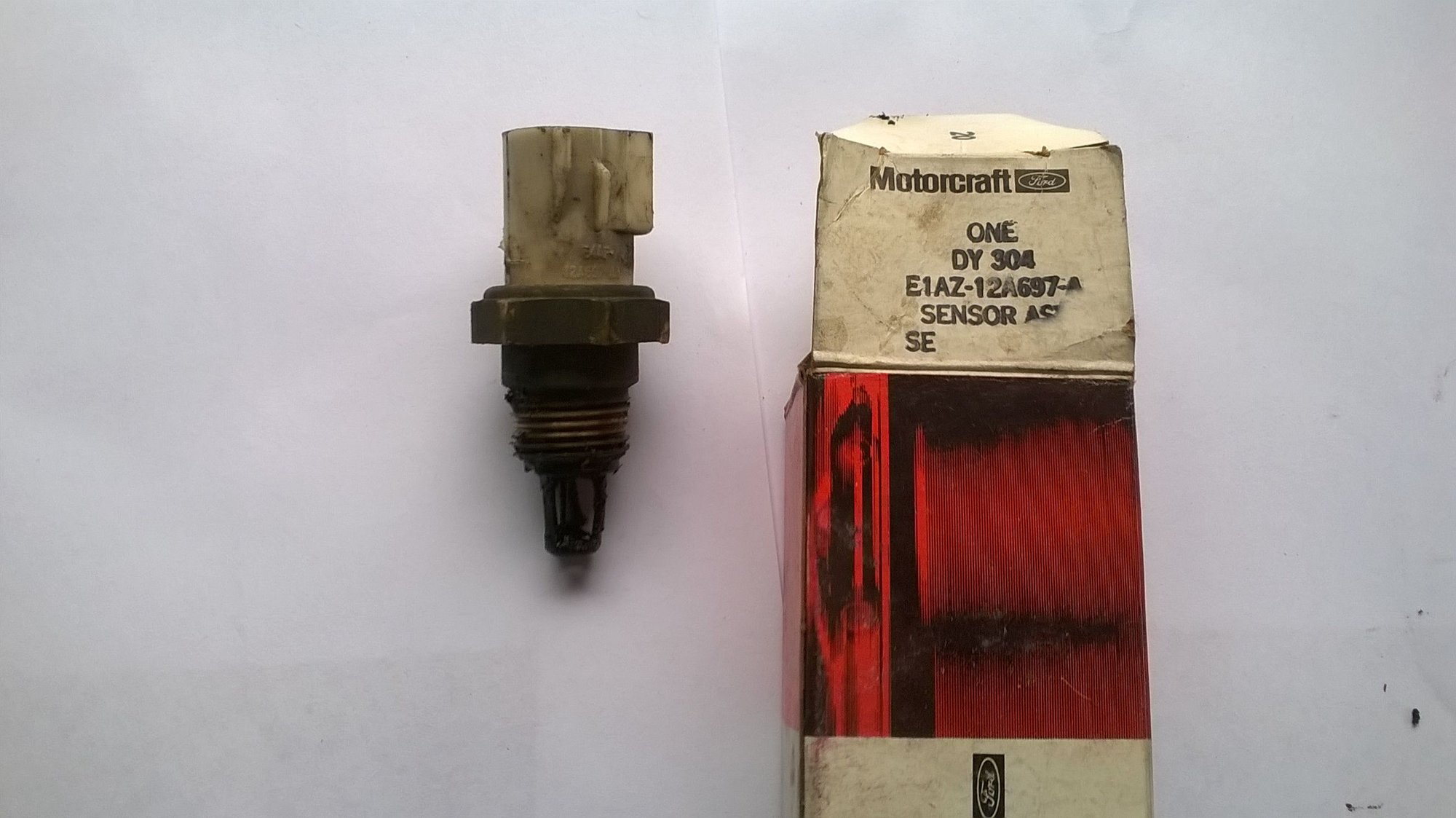

Notice the Air Charge Temperature Sensor. The ACT? looks very similar to the ECT. The ECT senses the temperature of the coolant while the ACT senses the air temperature in the intake manifold. Both are used by the ECM to adjust the fuel trim.

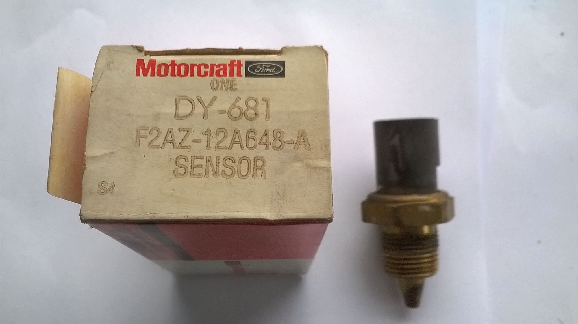

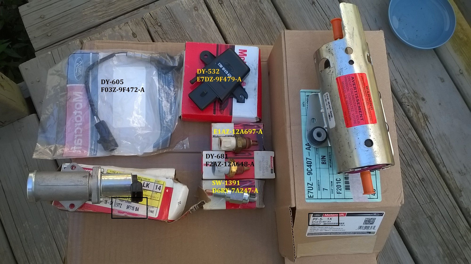

I had been gathering replacement sensors for the past year or so and a few months ago my some helped me change several of them out. Because we changed several at one time, I can't say exactly which one fixed my issues. Though we didn't test drive the van after each sensor was changed, we did start the engine to make sure we didn't create a serious problem. If I remember correctly when we changed the ACT, that made a big difference in how the van idled right after start up..
Here are the Motorcraft cartons with part numbers and the old parts.
ECT
ACT maybe ACTS?
Here is the gauge sending unit.
And all of these sensors fit my 88 E150 with a 5.0 but believe they would be the same for the 89.
