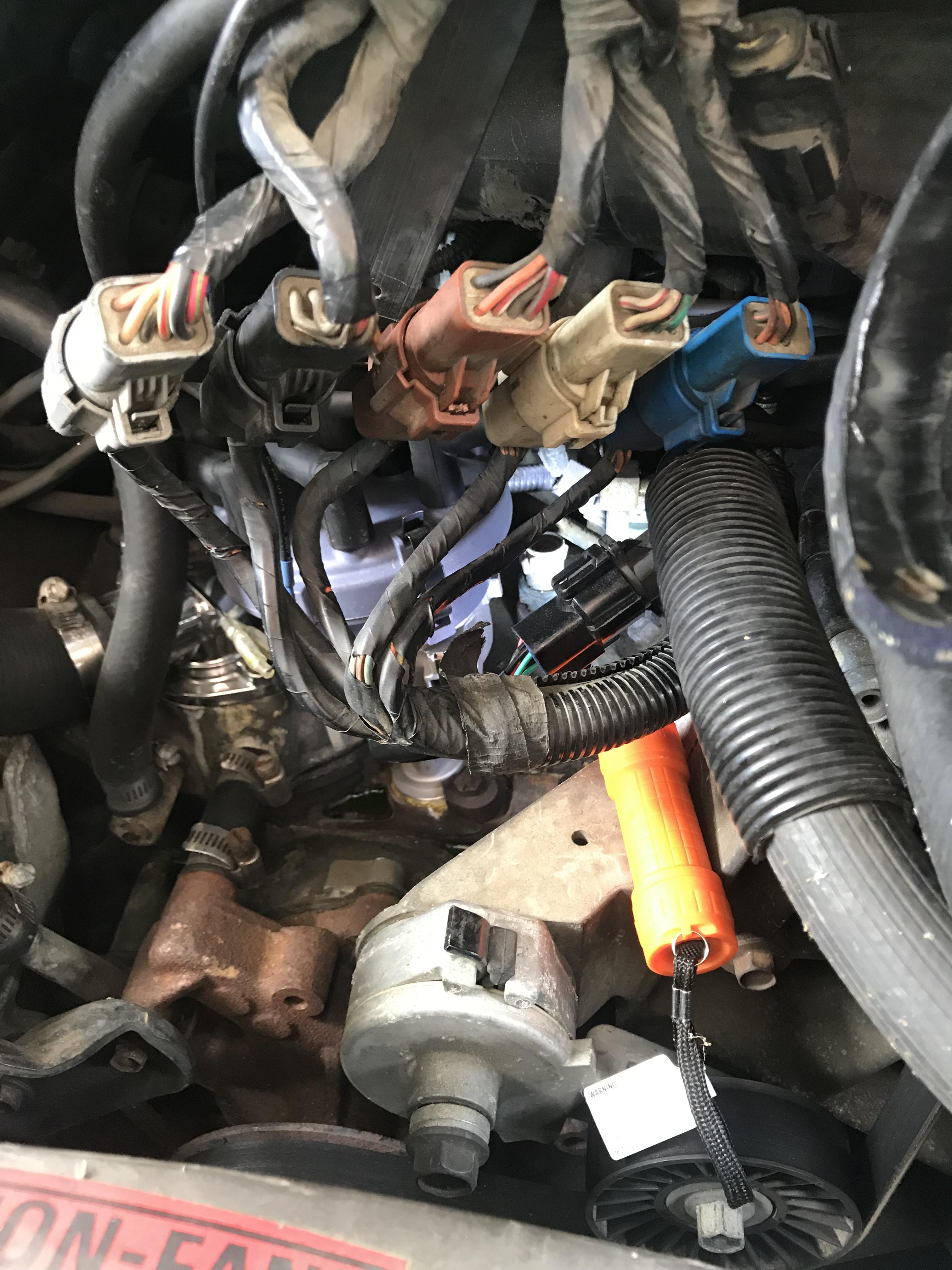

The sensor is right next to and behind the distributor, on the driver's side, in the intake manifold In this photo I have already removed the connector from it. You will need a flat-bladed screwdriver to pry the connector off of the sensor. In this photo, the orange flashlight is shining on the sensor.

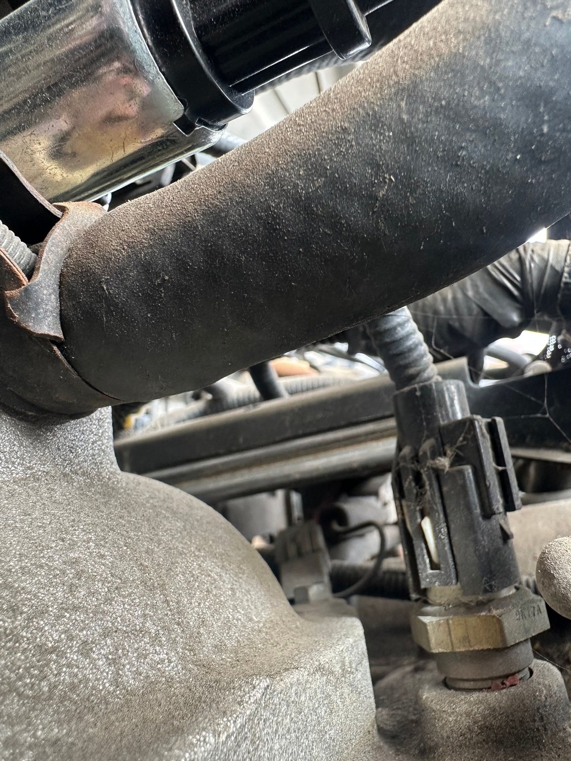

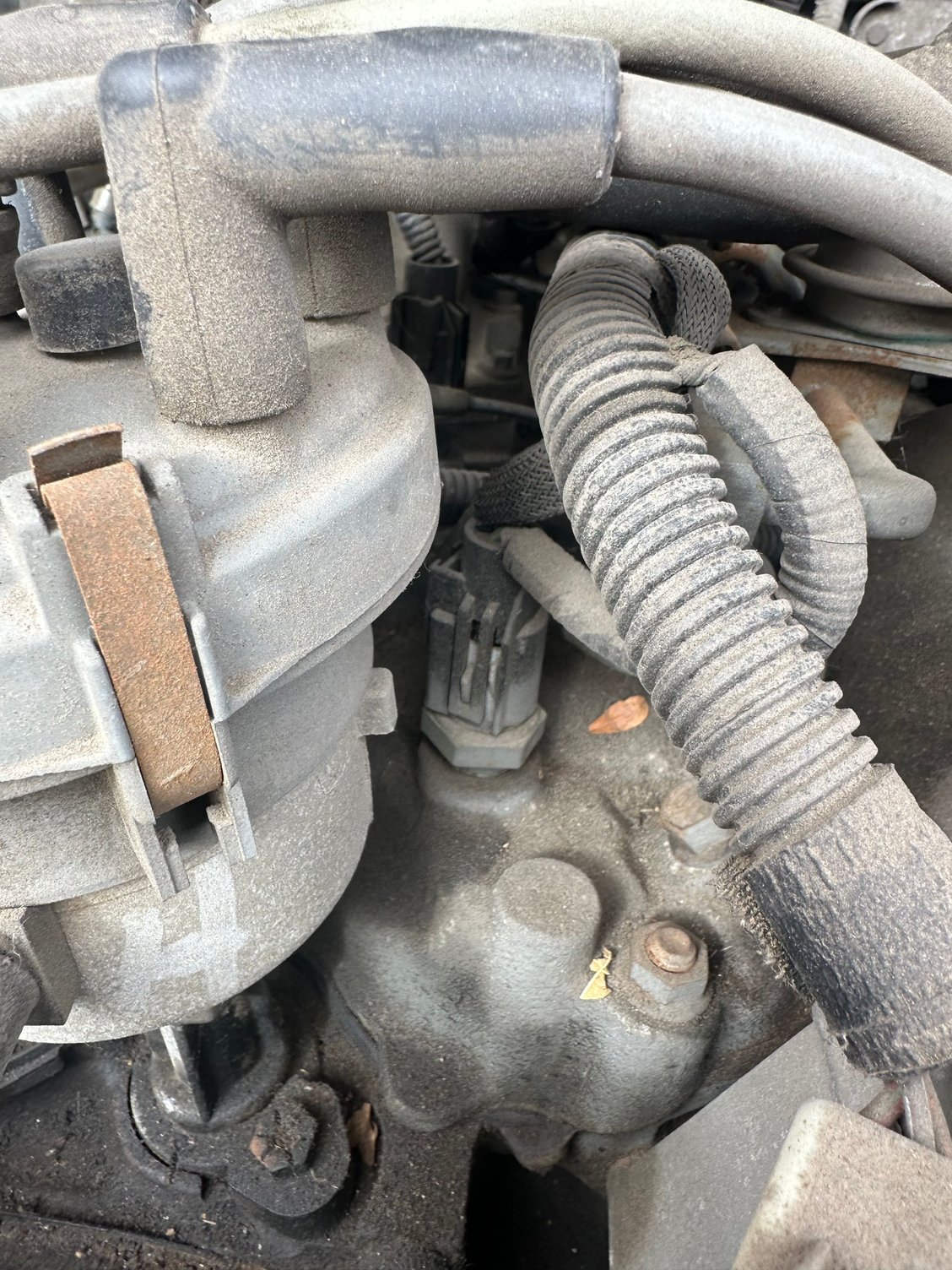

I know this thread was a while back but hoping to get some clarification on the ECT location. There is a sensor right next to the distributor, which looks to be what you are replacing there but I just can't tell. Since there is an almost identical sensor slightly behind the distributor, under the idle control unit. Do you know which one is which? And what the other sensor might be. Here are the photos of them on my 460:

There are two temperature sensors in the intake manifold. One is for the EEC to monitor coolant temperature, and the other is for the instrument cluster gauge.
"The sensor is right next to and behind the distributor, on the driver's side, in the intake manifold In this photo I have already removed the connector from it. You will need a flat-bladed screwdriver to pry the connector off of the sensor. In this photo, the orange flashlight is shining on the sensor."

Hey Steve, thanks for the quick reply. My 1990 F250 has three sensors seemingly then: The EEC, the temp sending unit, and one I can't identify but that looks exactly like the EEC and lives under the idle control unit. I guess it doesn't so much matter if I know what that one does as long as I replace the correct one haha. Thanks for the clarification, and I'll replace the one right next to and behind the distributor.

I believe they have unique connectors so you can't screw it up.
