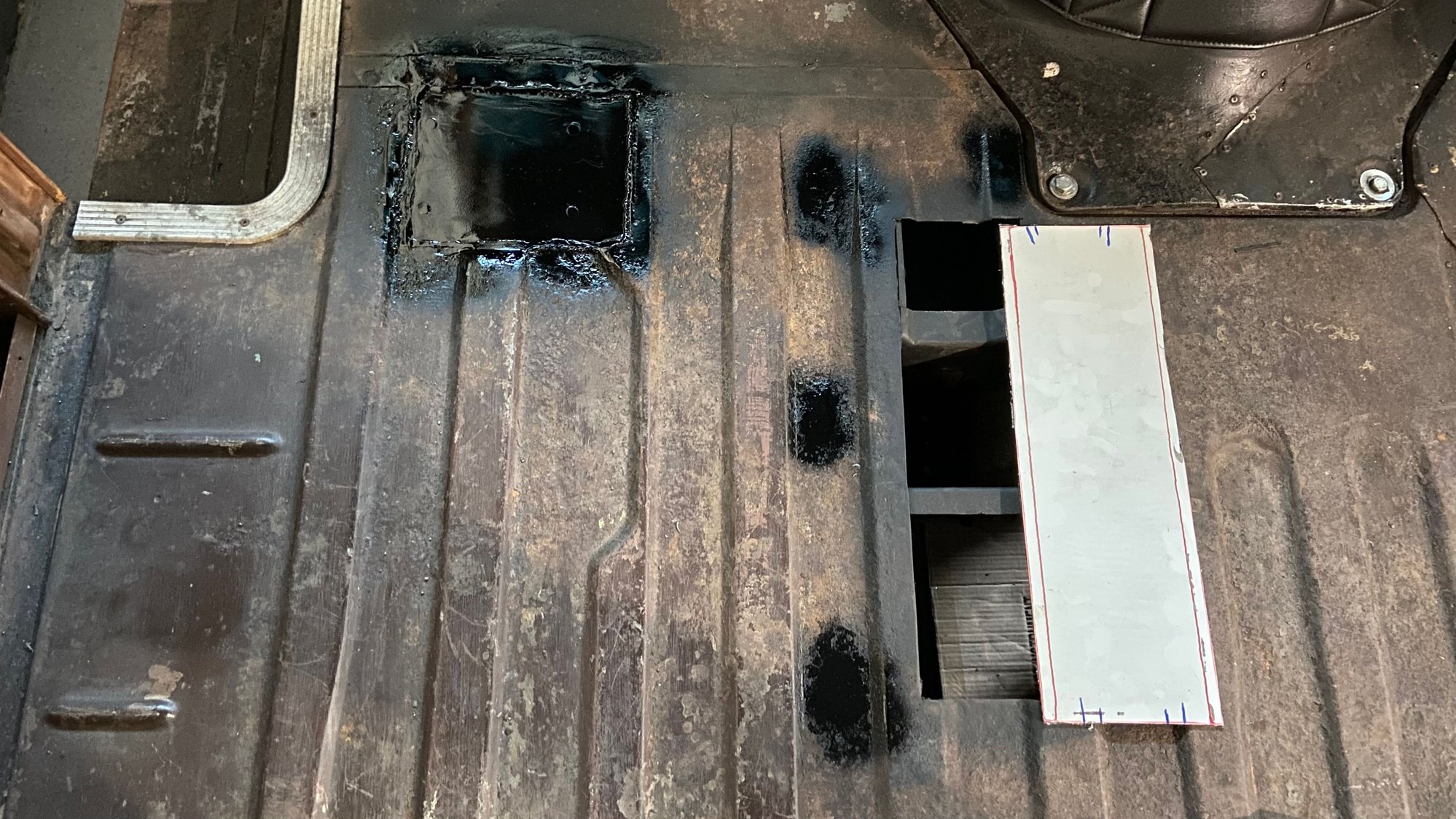

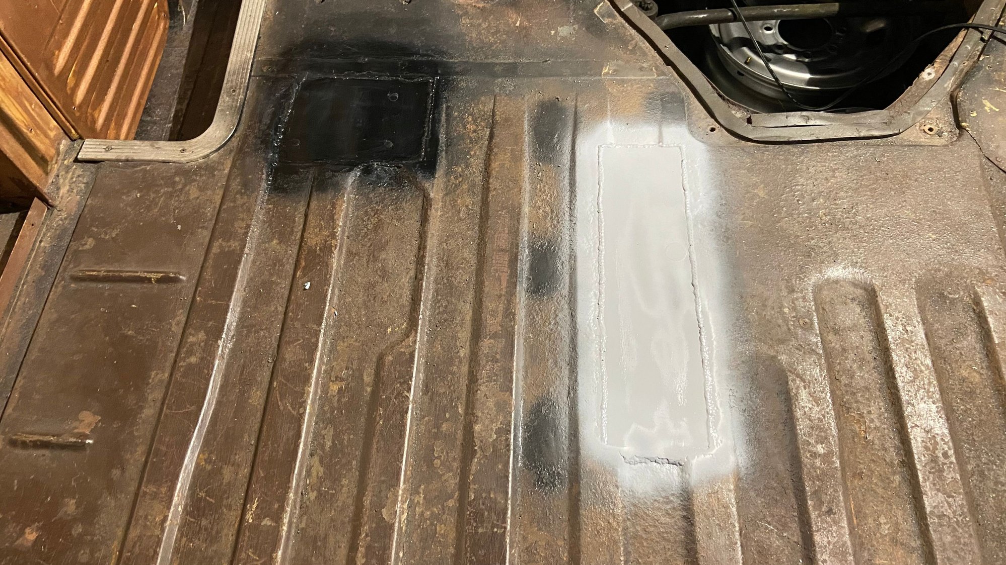

Got some work done finally. Long time coming. Got the one panel welded in after some trial and error with my new-to-me welder. Not the prettiest, but doesn’t need to be. It’ll be covered up by the seat anyway.
Once I get the other panel welded in I’ll be able to go over the entire Van and weld up the spots that need attention.
Then spray the inside with sound deadener.
Spot welds
Filled in some random screw holes
Only had gloss black rust stopper.

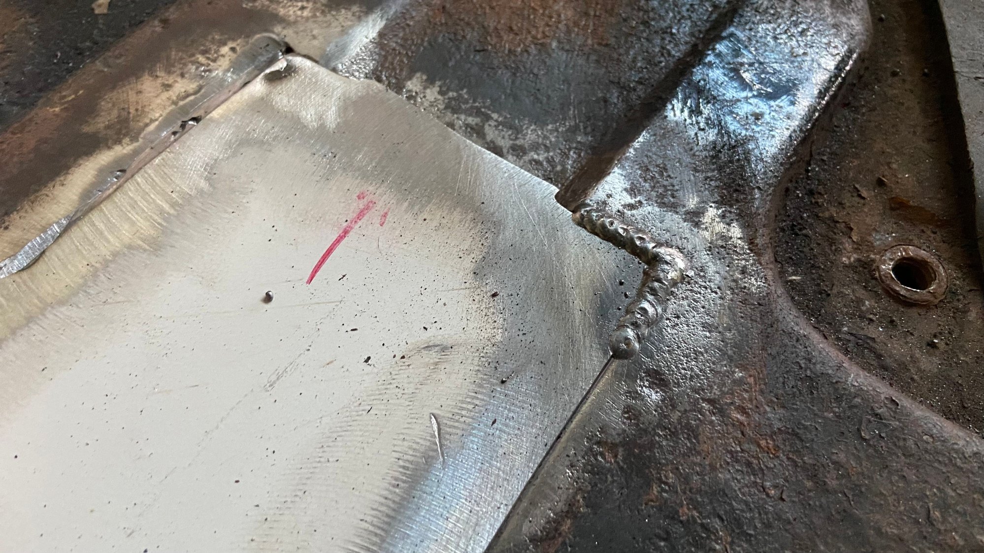

Got the other panel welded in tonight. I think my weld job was way better this time around. Still learning as I go. Ended up scrapping the first panel I made for this section. I found a thicker piece of scrap metal in my pile. Again, I don’t care how it looks for the most part, as long as it’s solid.
I left longer tabs on the end and hammered them down to weld to the indentation portion of the floor.
This side came out better.
Will grind the welds down more when I prep the entire floor for sound deadener. Have a few random spots I want to weld up before then as well.
