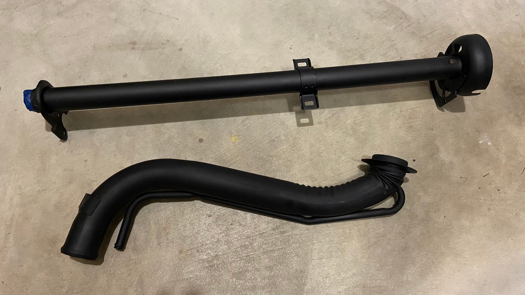

Sanded and repainted the steering column and gas filler neck too.

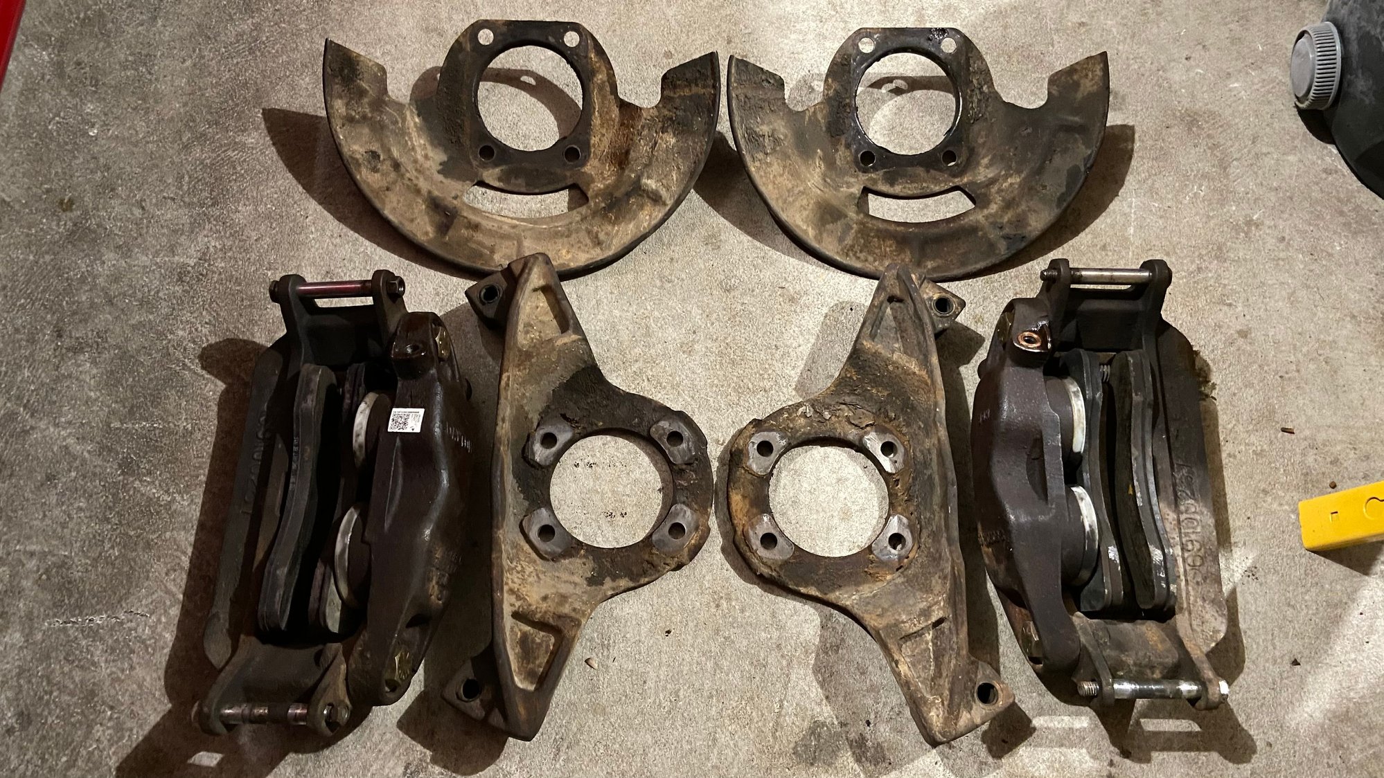

Disc brakes
Originally Posted by BOOM_FIST
So stoked, just scored a complete front disc brake swap on good’ol eBay!
It’s off of a 74 F250. Dual piston calipers with brackets and even the dust shields in great shape!
hey Boom fist. Nice project. Im collecting disc brake parts for my e300. I havnt taken my original brakes off yet. How does the caliper bracket bolt to spindle. It looks like i need another part? Do you have any pics or input. Thanks.
If you can find a parts truck, you can swap over the entire I-beam, you need not separate it, you sure are lucky, I have the E100, I can't do mine without swapping the rear end to match, so no 300 or 200 truck disc brake swap.
Appreciate it - Sorry for the delay. I just received the second half of my brakes today. Was getting worried that USPS lost my package with the other mounting bracket!! All is here and in great shape. These calipers are massive!
So the main pieces you’ll want to get you hands on are the caliper mounting brackets. These are hard to find and pretty pricey when you do. Well worth it in my opinion.
These guys:
These will mount directly to the E300 front drum spindles/knuckles. If you look at the backside of your factory spindle, you’ll see 4 bolts that have the same pattern as these caliper mounting brackets.
This is all in theory, but should be a direct bolt on from the research I’ve done. I will update this as I pull my factory spindles off to do this swap.
