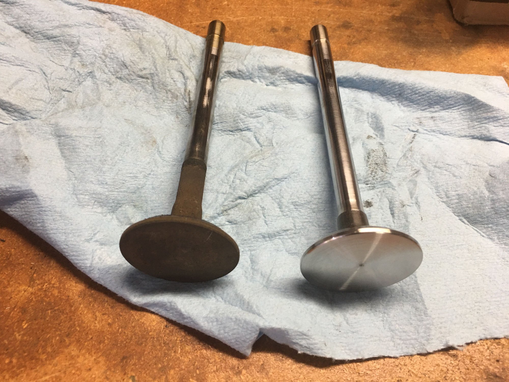

I took the AWD transfer case off and sent the 4R70W to a local transmission shop to swap the tail housing and output shaft to a 2WD set-up. They went through it and replaced seals and gaskets. Said it was in immaculate condition. I started ordering minor bolt on upgrades such as TFS valve spring kit, Scorpion 1.6 RR, ARP headbolts, New FPP hydraulic roller lifter, Comp Cams hardened push rods, Comp Cams dogbones. Even with 124k miles, this motor was immaculate. Pulled the valve covers and not a hint of sludge. Routine oil changes goes a long way guys! Cylinder walls still had great cross hatching. Didn't feel the need to touch the bottom end at all. Pulled and cleaned both heads, cleaned and lapped the valves, new gaskets throughout the entire motor. HV oil pump, ARP oil pump shaft, new water pump, harmonic balancer, front cover seal, double roller timing chain, ARP crank bolt and cam bolt. All new sensors, new bosch in injectors, all new everything. About 95% put back together...

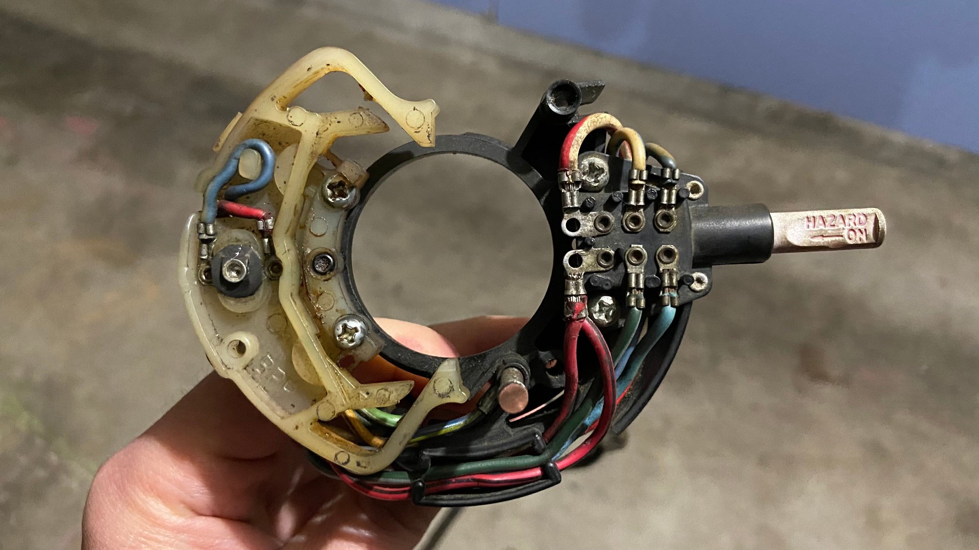

Also cleaned up the old turn signal assembly. Hard to find a replacement for these. One on eBay for $150, ouch. Maybe go dash mounted push buttons with self-cancelling module??
