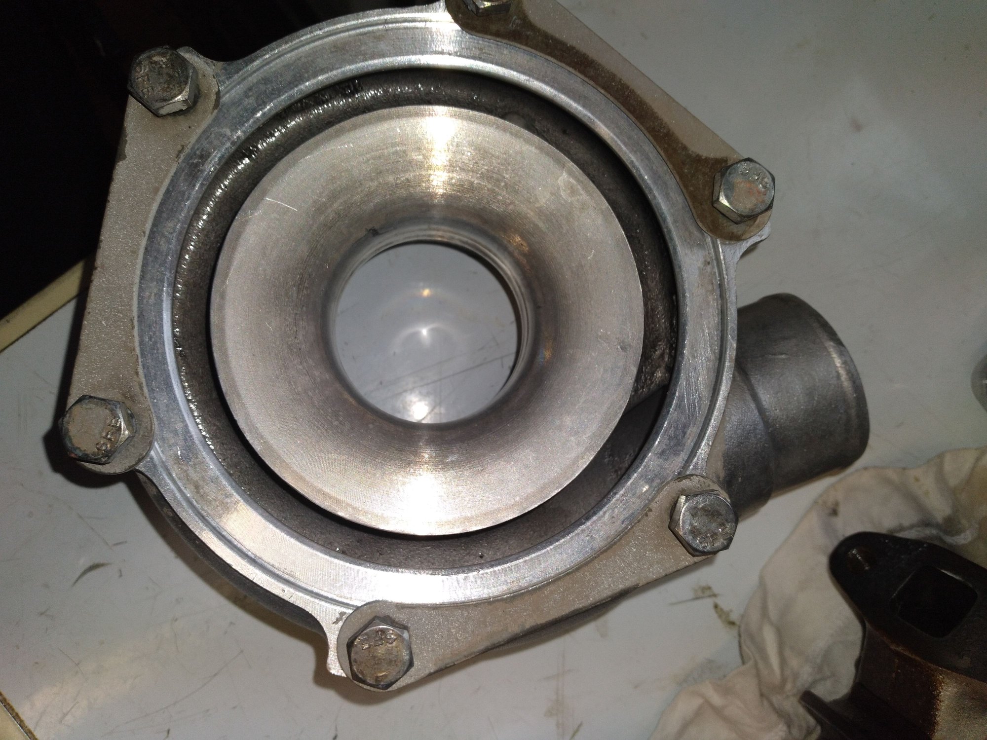

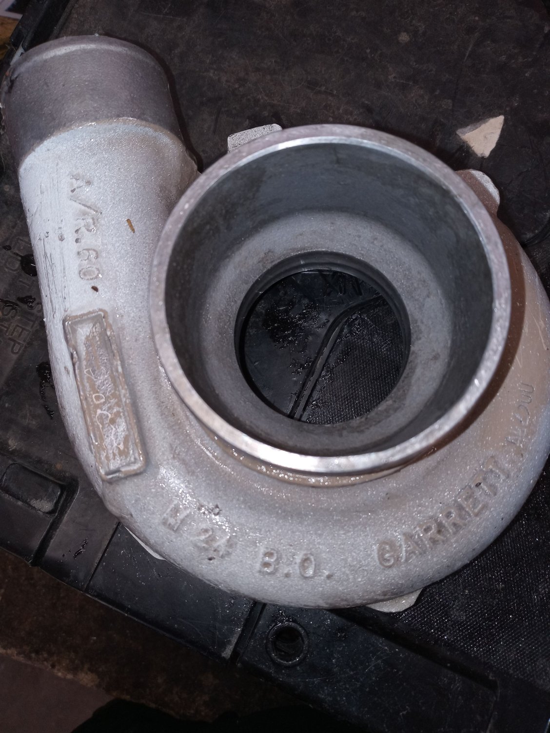

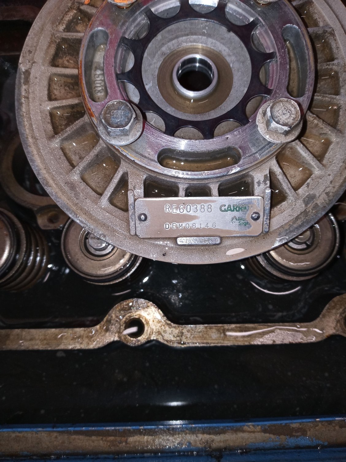

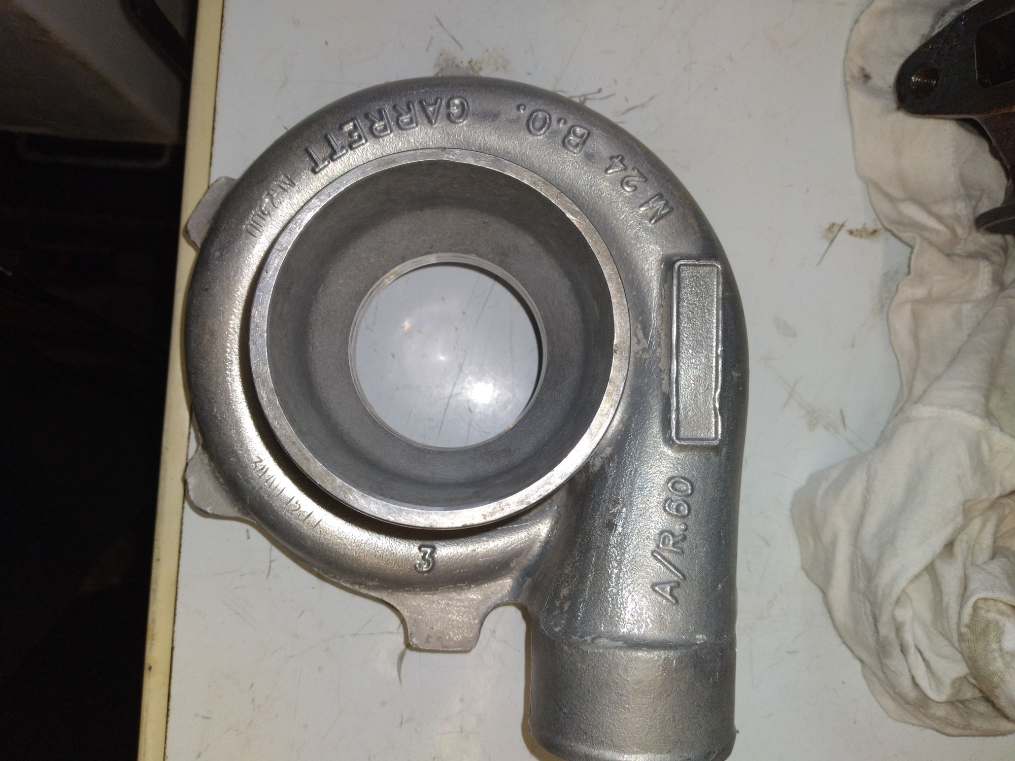

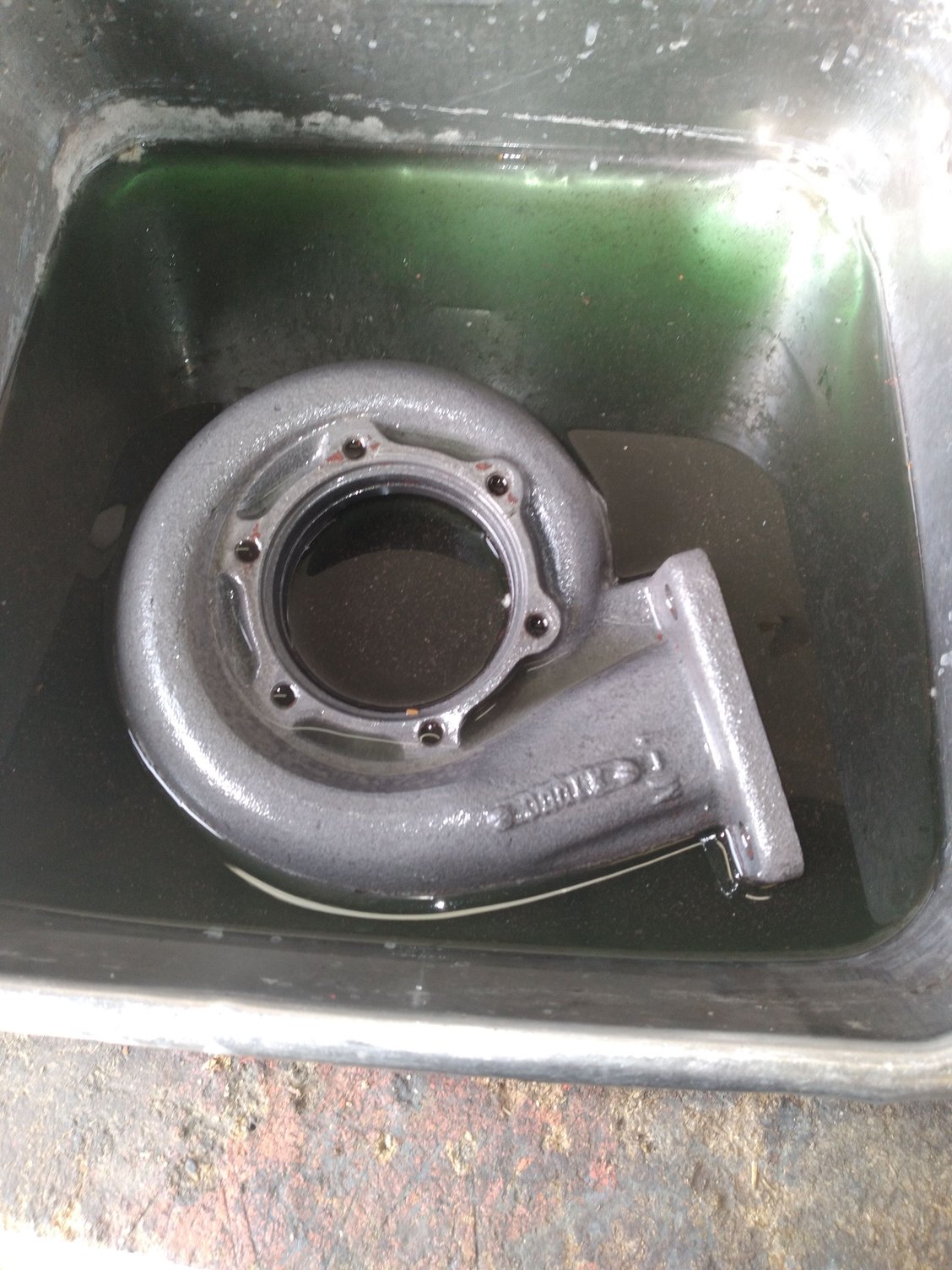

Trying to find a rebuild kit for a turbo a work and cant seem to identify what model it is, if anyone can help out it would be great. Thanks in advance.

A little internet browsing kicked up a mid 80's Buick Grand National from those numbers. That spits out a T-3 or T-4. No idea if it's right or not, just what Google told me, and everything on the internet is true. Sooooo, yep good luck.

Adam, I am not sure if you found the answer you were seeking and the post by udsuth78 provided enough interest for me to take another look. I really liked the Grand National when it came out many years ago.
Searching for Garrett RE60388 - I came across some cross reference numbers for a John Deere application on UK based websites.
- https://turbo-diesel.co.uk/product/t...4-new-garrett/
Also US based website that listed that part as a cross reference to Borg Warner.
- https://www.mddistributorsstore.com/...ross_reference
I suspect the DEM08146 is the serial number as there were no results for a search term of Garrett DEM08146.

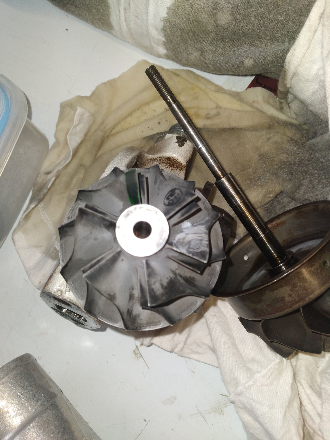

Thanks for the responses, I took a gamble and ordered a rebuild kit for T04 turbo as the bearing measurements are Identical and the parts look identical to the parts I disassembled. If not Buying a new one from a military parts blow out.

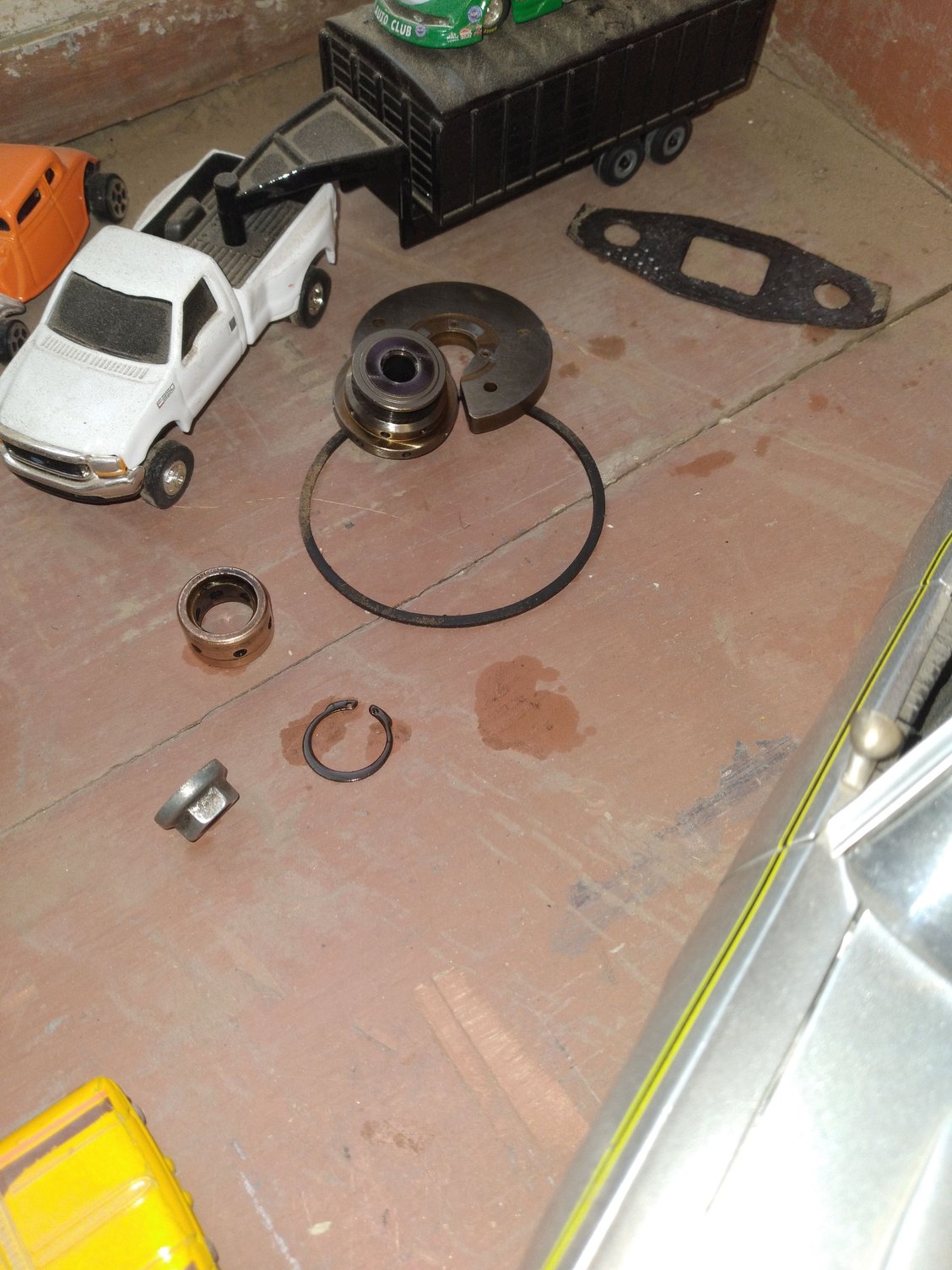

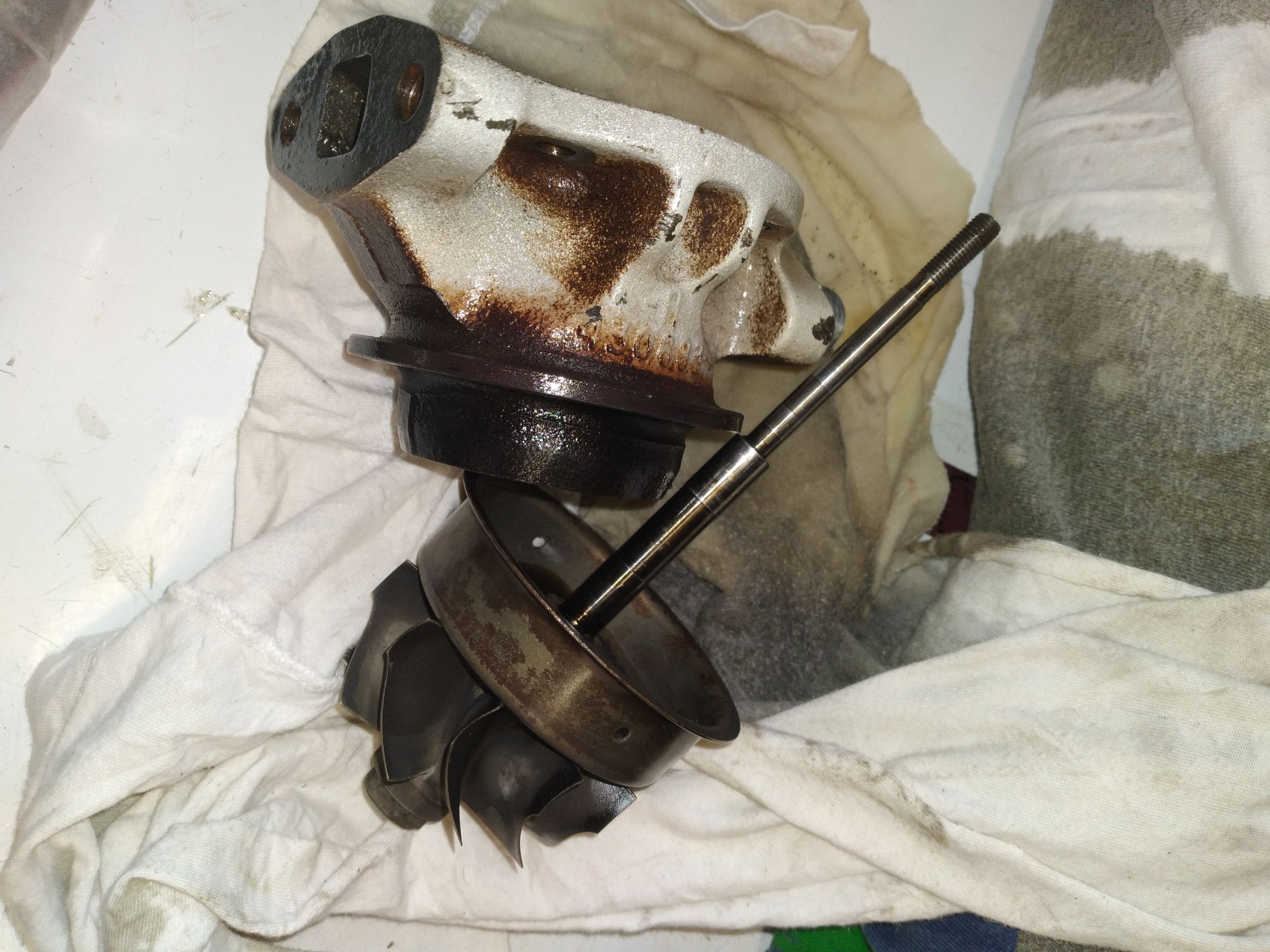

Did some cleaning, bushings were pitted and black from sitting so long cleaned them of with fine brilliant pads, rear oil seal was leaking.
