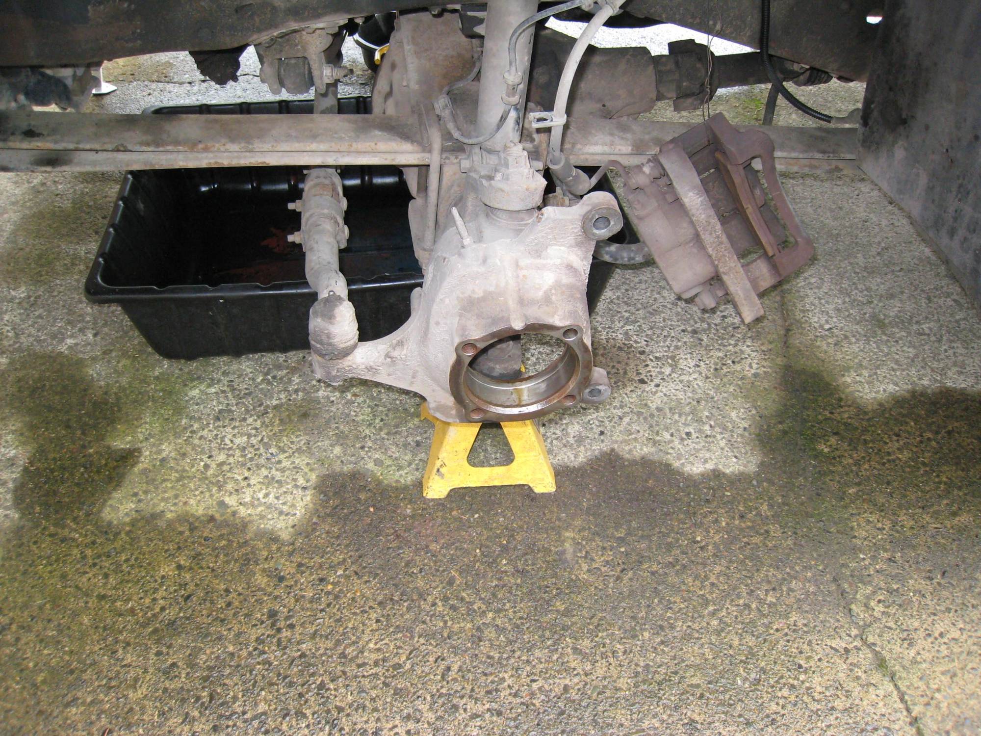

I would probably remove the front unit bearings and pull the front axle drive shafts to see what is wrong and do overhaul.
You will see what was grinding if you take it apart.
Maybe good to get Haynes, or simlar manual if you have not worked on these previously?
