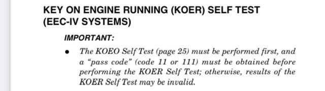

44 - thermactor air
13 - RPM idle out of range/ low
25 - knock no sensed during dynamic response test.
Code 25 was probably operator error if you didn’t momentarily floor the gas pedal when prompted.
What codes did you get when doing the KOEO test and are they active or stored codes? You are supposed to repair any of those codes before running the engine running test.

44 - thermactor air
From Innova 3145 manual
I can’t remember the number off hand but it was high voltage and that was the only one. I’m attributing that one to my park brake not turning off right now. Just another thing to fix
I disagree. The parking brake is not tied into the PCM. A problem with the brake lamps could cause a torque converter lockup code but that does not apply to your manual transmission truck.
