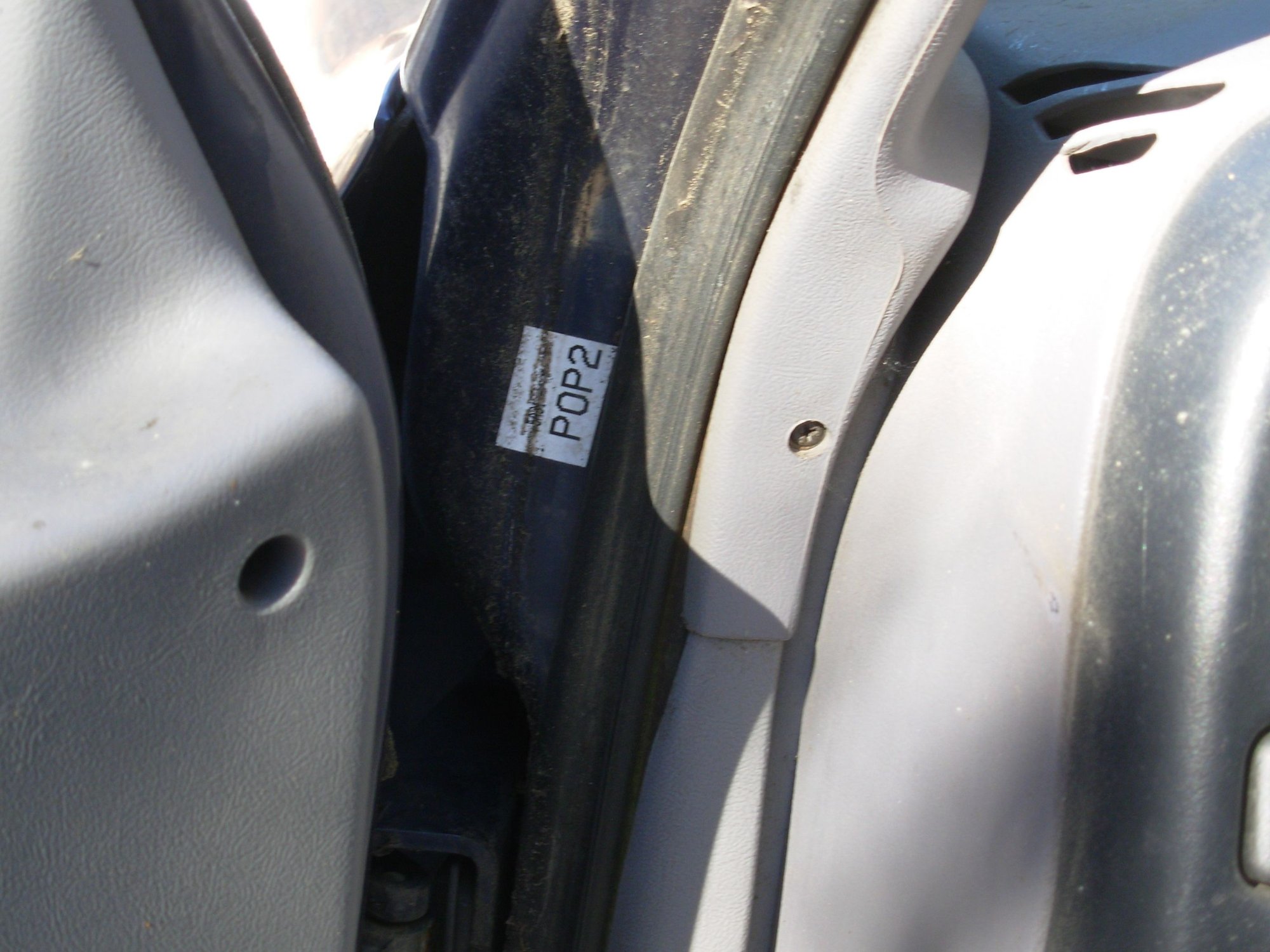

Below is an example of what I am talking about. The 3 or 4 digit code is easy to cross reference to what EEC came from factory, and to find a replacement. Maybe pre 90s trucks did not have that?
More than likely, any 1987-89 6cyl manual computer will work.

The little sticker is the 'Strategy' or the software that is running on the EEC-IV.
There are many sites and lists of what 'Strategy' will run on what hardware.
If yours is missing, maybe truck has been painted.
For the EEC-IV in question in this thread, the "Calibration Sticker" has revealed all parts to do with Vehicle Emissions, including the Engineering/Service number for the EEC-IV.
What is still missing, is the EEC-IV hardware and software versions/revisions. That information can be found on the EEC-IV itself, or on the sticker on the A-pillar.
Guessing, since MAF wasn't on the truck in 1989(AFAIK) it will be a Speed Density(SD) system, probably with EEC-IV hardware "EFI-SD22x".
The software code, will be specific to 6cyl, standard trans, timing, etc, "The Tune".

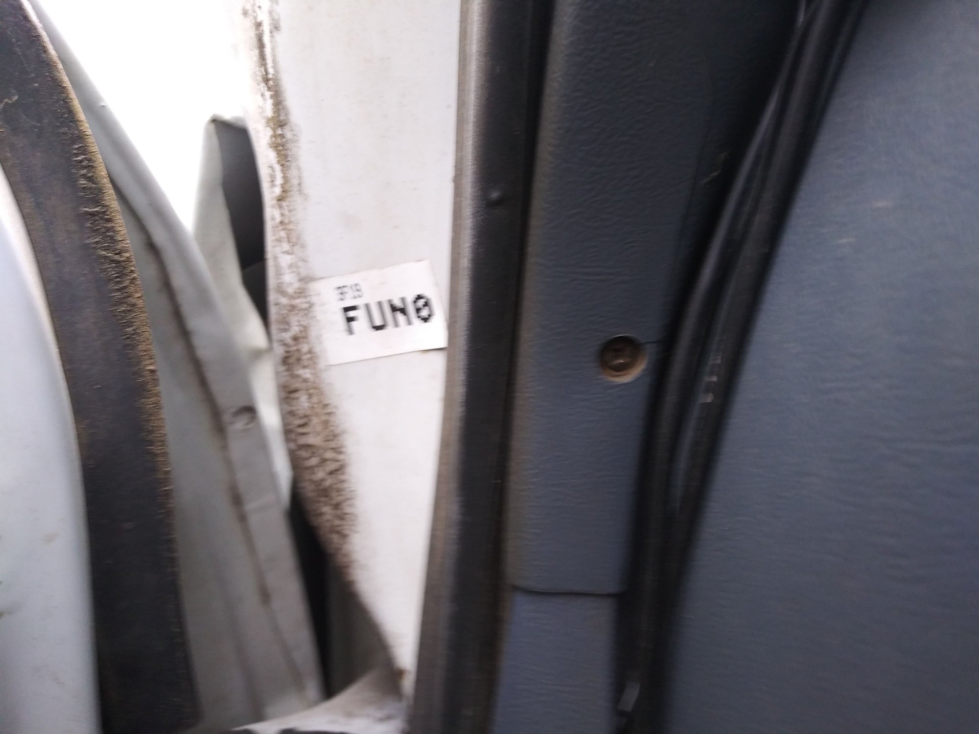

Here is the one of the A pillar on my 93

FYI:
FUN0 4.9L speed density with E4OD, probably has hardware EFI-SD47x
Next revision would be the more popular FUN1
