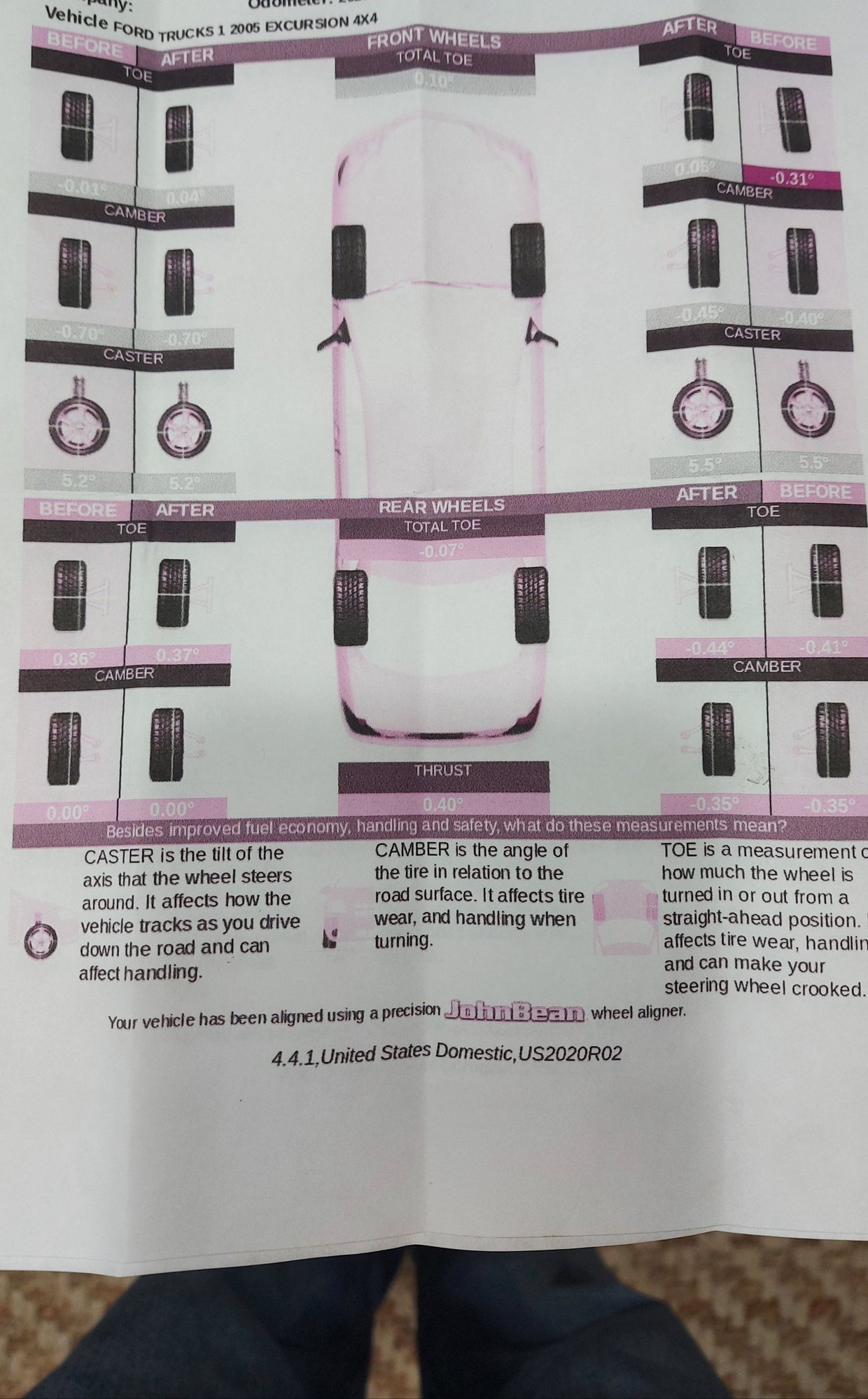

Wouldn't one think that removing a 5" Rough country lift and then installing ATS X code and modded C code springs, would improve positive caster? Caster with old springs were 3.9* left, 4* right. Atleast those are the numbers that the alignment shop gave me.

Thanks for the reply. I was hoping the new springs would give me about a degree more of positive caster and put me where I need to be but it seems that I may of lost some. New springs are great compared to the old and the feel of the truck is much better but still have the wandering. It's going to a different alignment shop in a day or two, hopefully they can dial it in. Just ticks me off that the last alignment shop who does tons of lifted trucks didn't bother to touch the caster. .

Had I known before hand about putting these trucks on the high end of the spec on caster, I would of definitely asked for it. But again, you are absolutely right. They said caster was in spec, which technically it was. Live and learn. It's really my bad, I should of put the 2* axel shims in while I was doing the new springs. Needless to say I called around to a couple places we deal with and have an appointment next Monday to get it done. I told him where I wanted to be at, and that I wanted before and after measurements. No problem. I'll post up measurements after the work completed.

Sorry guys, got really busy at work. I finally got the pig in the shop and have preliminary numbers. Gonna go with cam/caster bushings to hopefully put me where I need to be. I will post the final report after work is done.

Wow!! What a difference. This even helped tracking at low speeds too, 35-45mph in traffic, or when having to brake hard at a light. Straight as an arrow. Returns to center much better and steering is more responsive. Thank you
