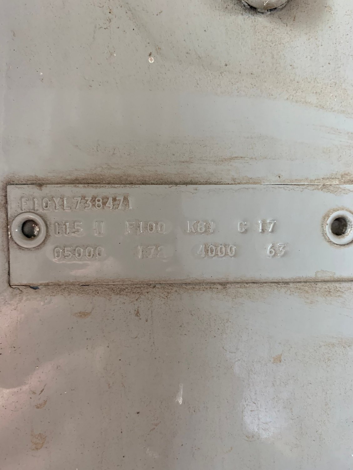

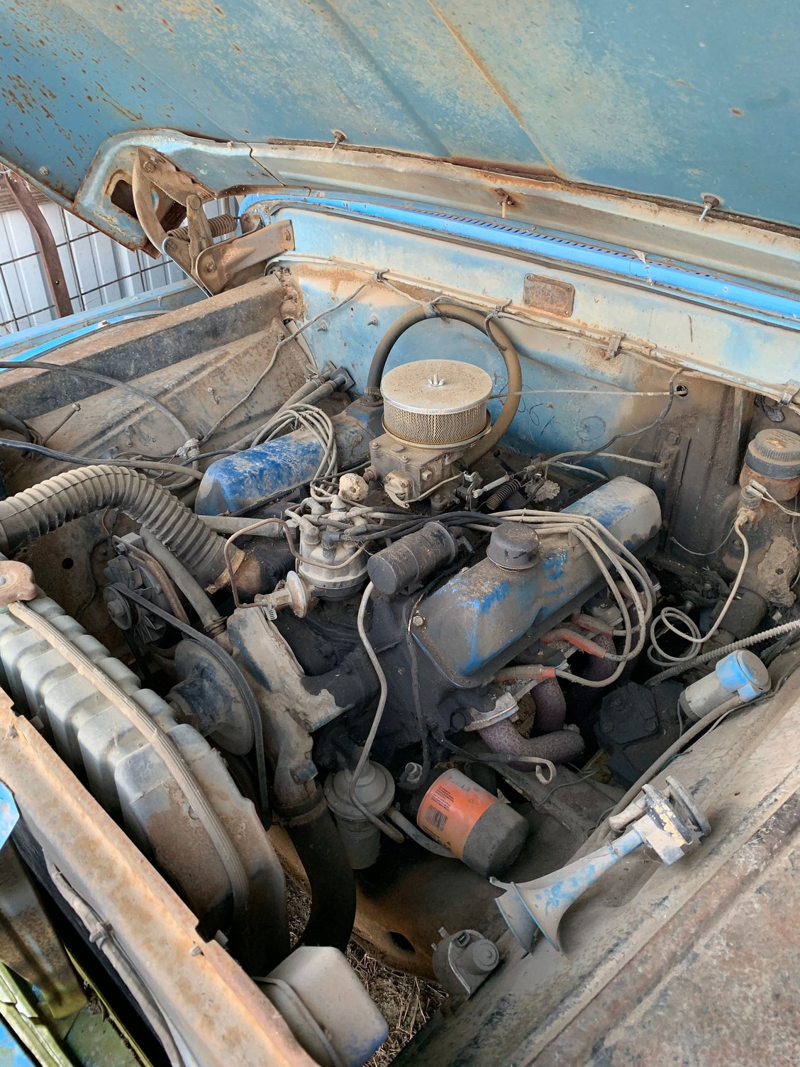

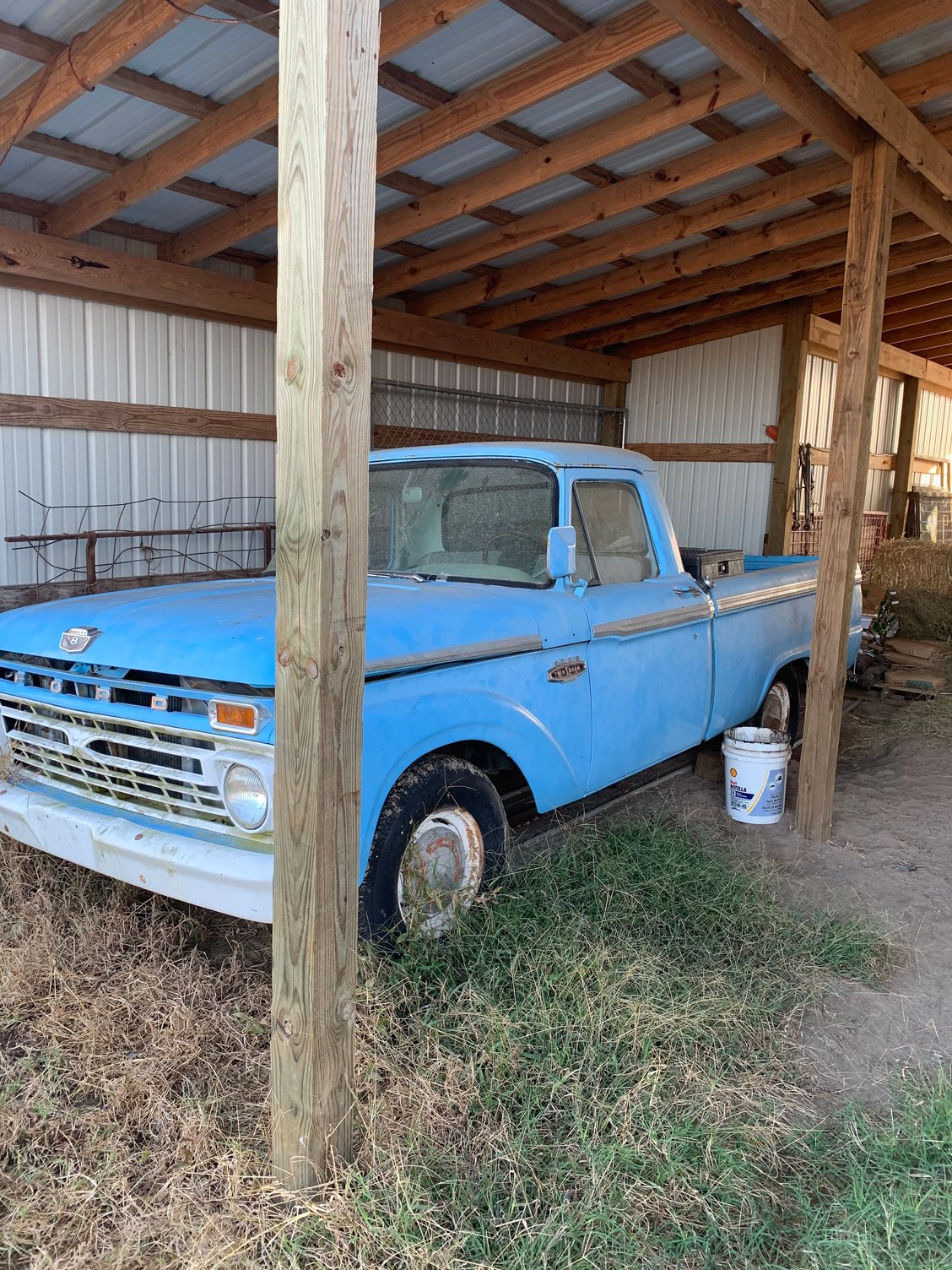

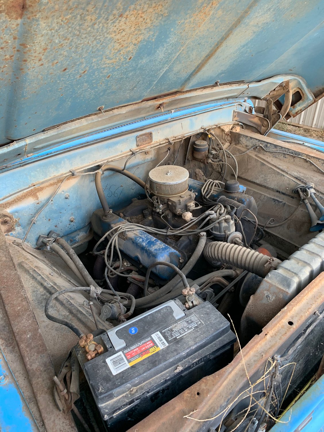

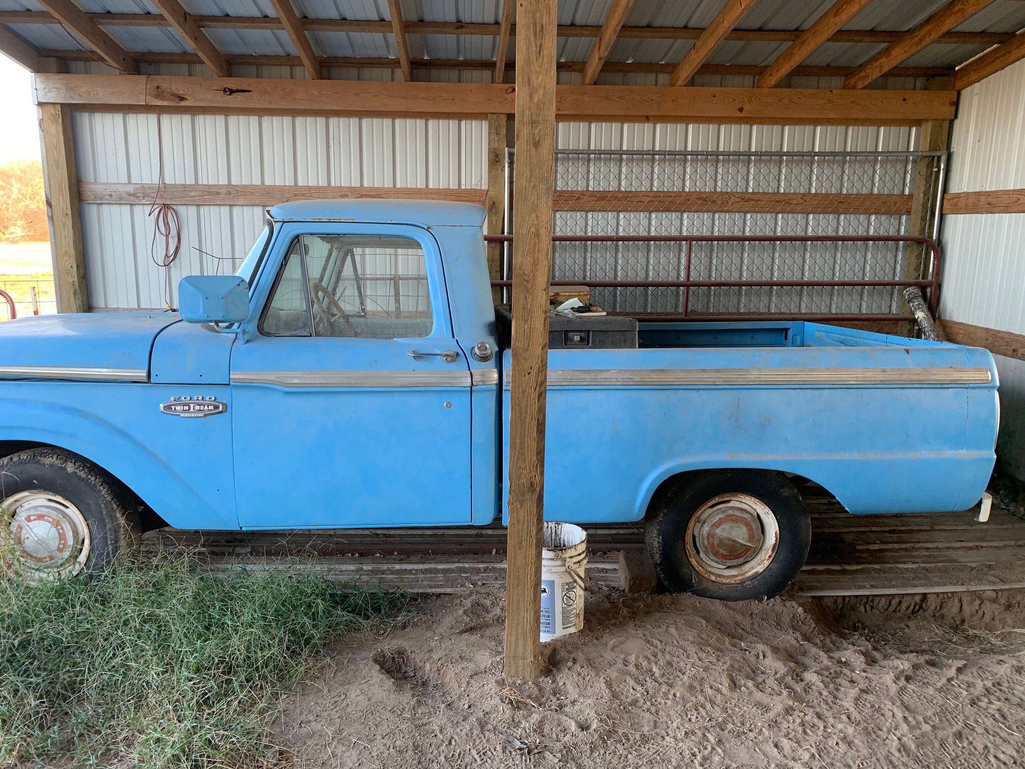

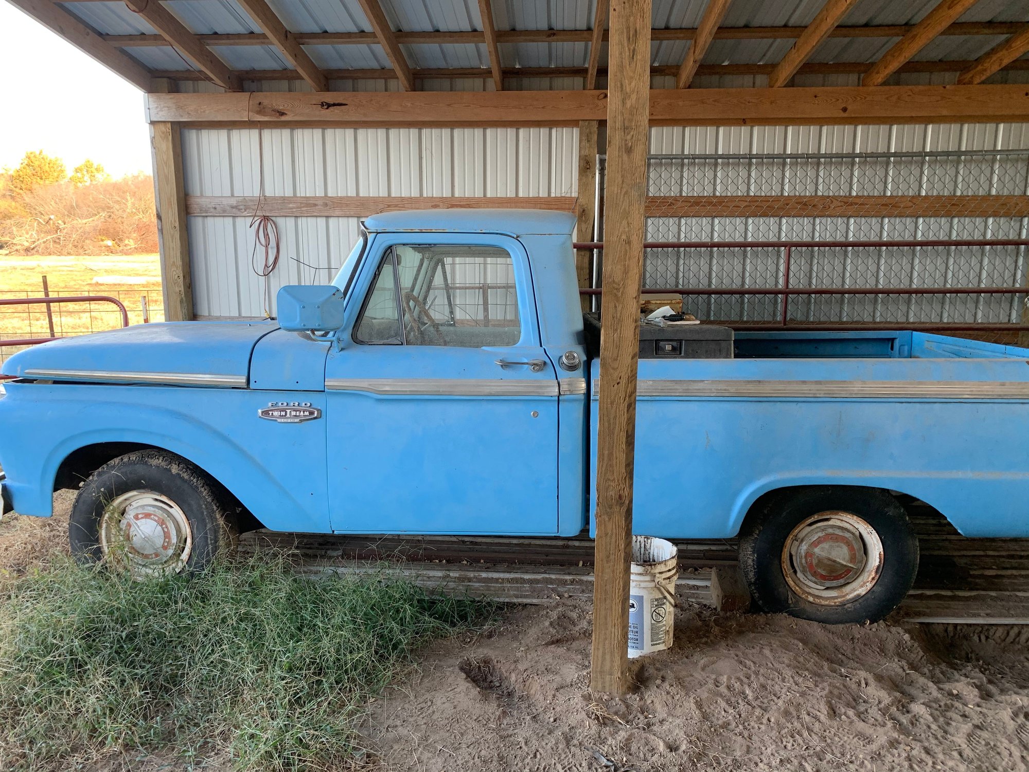

I’m second owner of my 66 F100 short bed iv owned since 99. We are searching for someone to do a full restore but not sure if we would be better off doing a frame off or not. Also wondering what model I have. It has no custom cab emblem or interior look and has aluminum molding on the sides. Trying to keep all original. Thanks in advance.
Last edited by Bkglover; Nov 17, 2020 at 06:53 AM. Reason: Here is the door plate. Looks like original color was Marlin Blue

It is a standard cab for sure. Seems pretty solid. Been painted blue it originally was Wimbledon White by the looks of it. I detest blue so I would repaint it but that is just me. Post a picture of the warranty tag on the drivers door and it will soon be decoded by someone here.

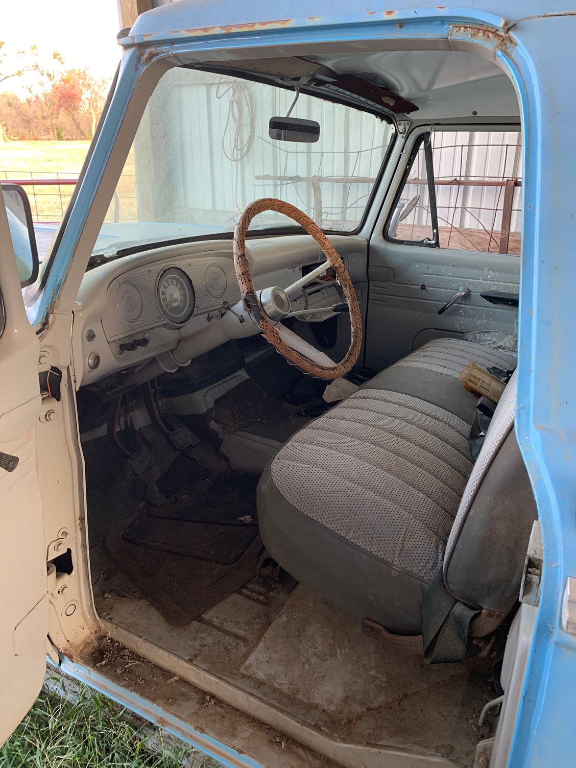

Looks like a very basic F-100 with the only options I can see being:
V8 (352)
Standard heater (no temp control)
Passenger sun visor
Armrests.
Bedside trim.

Door plate attached
Photo of door plate

Hoping that I got the color code right - Looks like a W from here. If I got that wrong let me know.
F10 = F100-4x2
Y = 352 2V V8
L = Michigan Truck Assembly Plant
738471 = August 1965 - 1966 Model Year
115 = Wheelbase in inches
W = Marlin Blue
F100 = F100 4x2 5000 Gvwr
K81 - K = Medium blue crush Vinyl and medium blue cody pattern - 81 = 81A Standard Cab
C = Ford 3.03 3-speed light duty transmission
17 = Ford 9" 3.25:1 ratio non-limited slip
5000 = Gross Vehicle Weight rating
172 = Horsepower at
4000 = RPM
63 = Memphis TN District Sales Office
