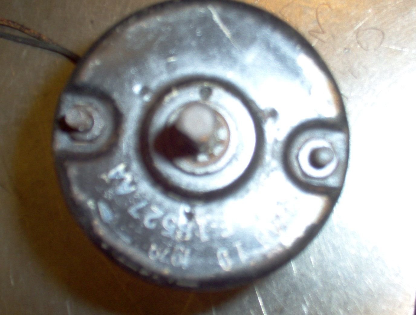

If it hasn't been growling for long you can drill a small hole on each end of the motor at the motors top just above center. Make it just big enough to get a oil squirt can in and give it maybe two squirts, it doesn't take much to fill up the bushings oil wick then just fill the hole over with silicone. I know it's a pia to change one with ac but they seem to run fine again after getting some oil in their wicks. Picture is not so good but you can still see the hole I drilled.
