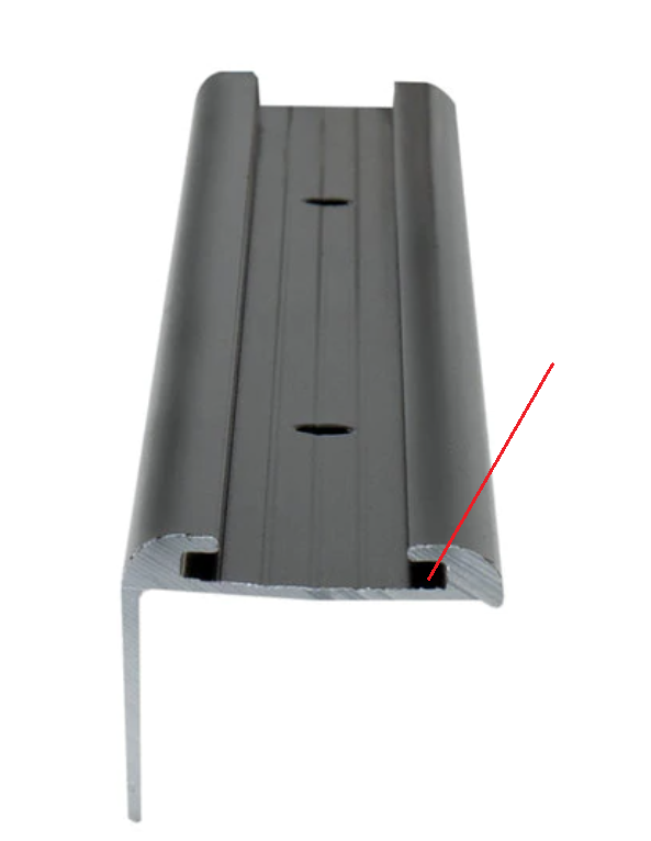

I put in a wired camera on my last two travel trailers. One bumper pull and the new 5er.
I ran the cable along the corner trim to the bottom side of the camper and in both cases zip tied the cable to the propane pipe which ran almost the full length of the units.
To get from the camera to the bottom, I followed the edge trim and drilled small holes in the trim flange that allowed me to use small zip ties to attach it to the trim.
On my 5er, I entered the front storage/battery compartment from the bottom and then ran the cable between the front bedroom floor and the skin covering the bottom of the overhang to the pinbox. It was easy to use a flexible fish tape to pull it thru that area without much trouble. I then zip tied the camera cable to the 7 pin cable.
