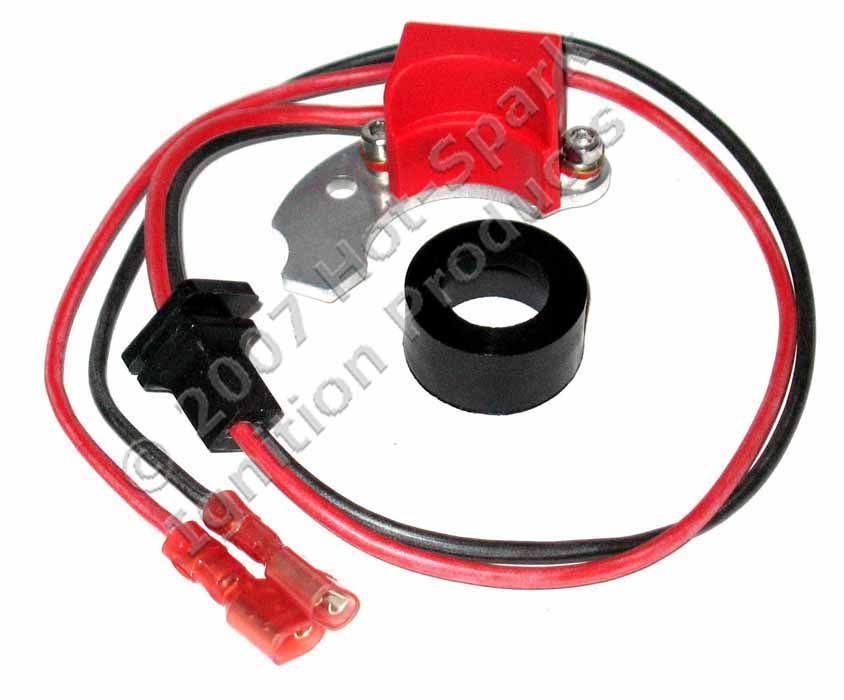

I'm sure this is a periodic subject but has anyone on the forum converted their Loadamatic vacuum advance distributor to electronic ignition via the "Hot Spark" setup [https://www.hot-spark.com]? If so, how does it perform? Are you happy with it? Did you need the "hotter" coil and/or the ceramic resistor? I'm having a real struggle keeping points in my signature truck. Thanks! Bob H.

Thanks, Robert. Weird about the link but that picture is the deal. Pertronix didn't have a solution for the 223 on the website I visited.

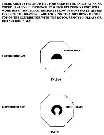

I used Pertronix part number 1266 on my '63 with a 223. That's the original Pertronix I, but there's also a Pertronix II available, part number 91266. I think some of Ford's later 6-cylinder engines like the Falcon 144 & 170 used part number 1261. The picture below shows the difference.
