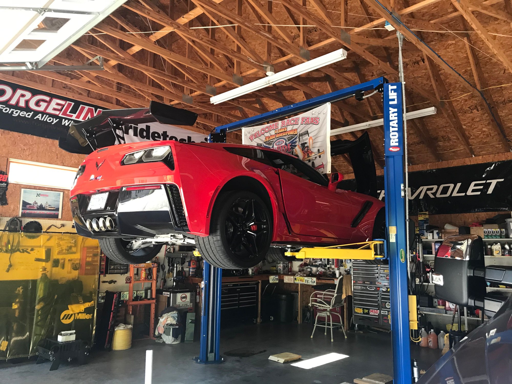

Rotary all the way. I think I would look at a 12K lift for a diesel truck. I like a little margin of safety!

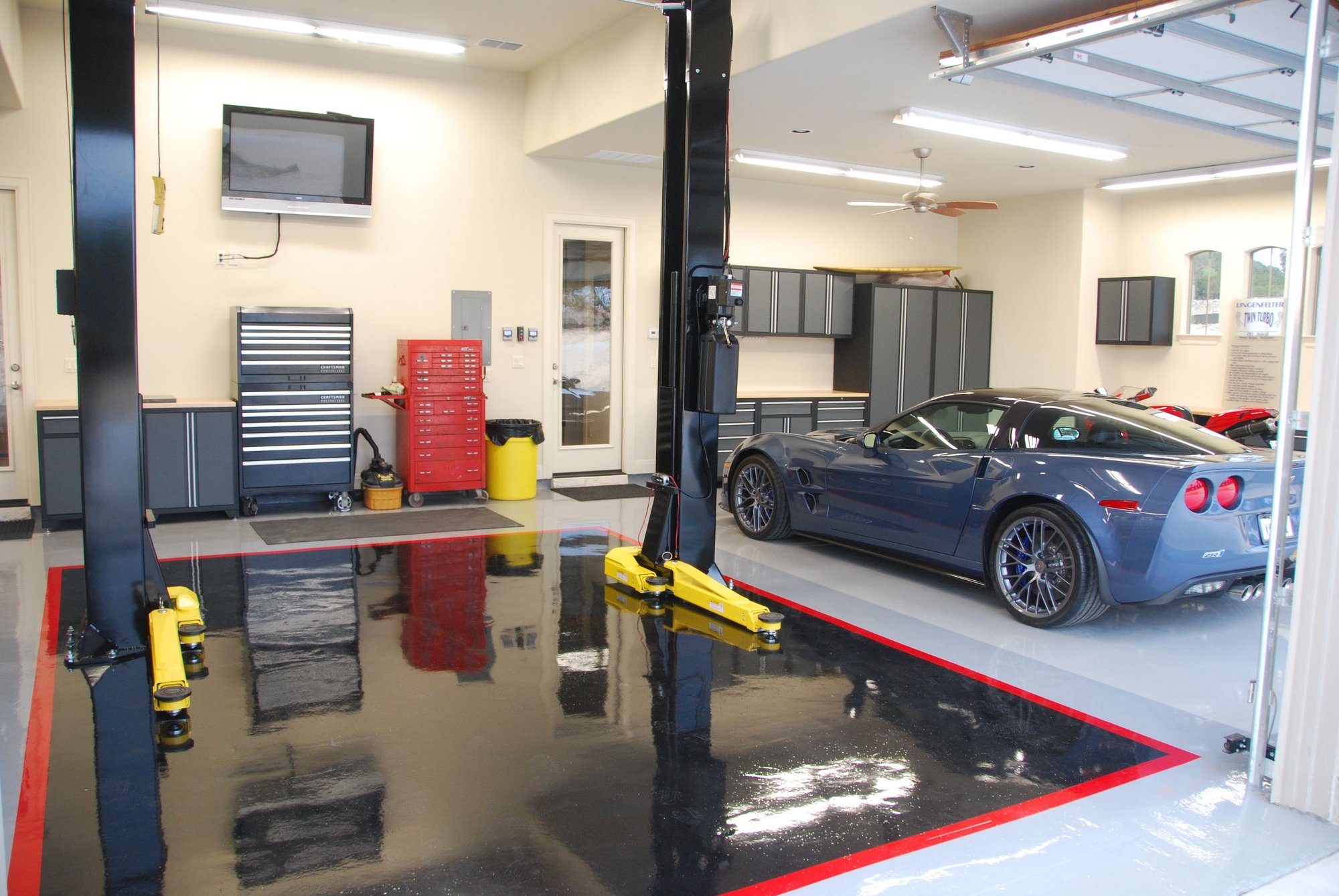

I had a Rotary 9K lb 2 post lift at my previous house but installed a Challenger CL10 10K lb 2 post lift when I built my current house.
It is 12' tall so I can't lift some vehicles as high as I would like.
Sam's and Costco both use this same lift so I expect it has proven the test of time.
I just finished my shop and installed another Challenger CL10 lift with 14' height so I can drive through it to get out the back of the shop.
The distance between the lift arms is 105" so it can get tight for some trailers, campers, etc but it works.
I tied the top of each lift column to the I-beam building truss structure just to give it more support.
These columns don't move!
My concrete contractor was not the most trustworthy so I don't know that I got the 3000psi concrete I specified.
I drilled 6" deep for the anchors and did not break through the bottom side of the concrete so I have at least a 6" think slab.
The Challenger lifts have been very reliable.
I installed the one in my shop which was not too hard but you need equipment to move the heavy columns.
They weigh about 1000 lbs each so be careful.
I feel better working under my F350 knowing the lift has some extra capacity.
Good luck with your lift.
I cannot live without one!
