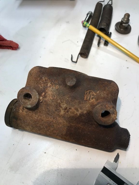

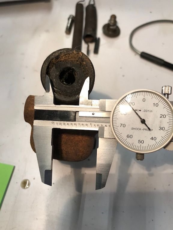

Measured "original" Master Cylinder
My new Raybestos arrived today. I thought I'd take the time to compare the MC that came off the truck with both the Raybestos and "Mid-Fifty" MCs. I split the info across 3 posts to avoid confusion. We'll start here with he original MC.
The original MC as removed from truck
The measured Piston bore is ~1.9"
On the hydraulic output side, some structure is visible (should be a pressure hold check valve). I measured the depth from the outside of the casting to the top of the structure to be ~1.625"

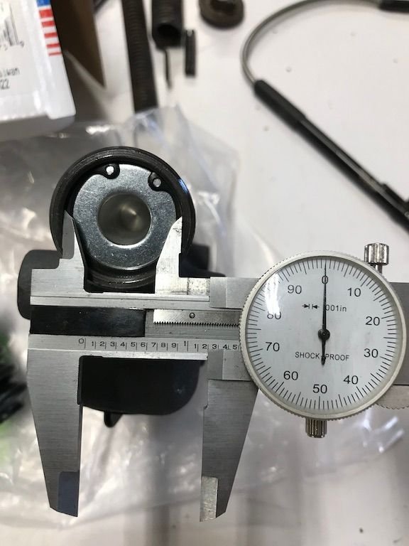

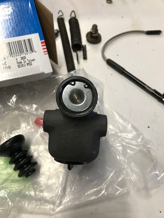

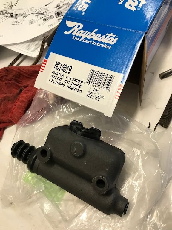

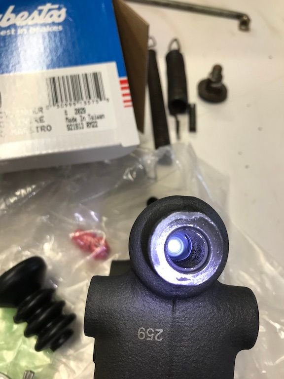

The Raybestos Master Cylinder
Now we have the Raybestos MC14019
Very noticeable is the black finish. Some sort coating has been applied.
The MC14019 and the box it came in
View of the piston bore end
Measures 1.20" diameter
The hydraulic output end. The "structure" in there is 1.65" down from the threaded end of the casting

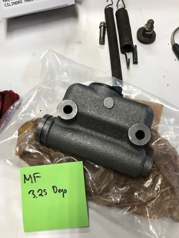

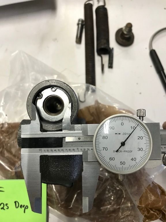

The "Mid-Fifty" Master Cylinder
Now we show the Master Cylinder purchased from Mid-Fifty. Part # 0512
First note the cast iron is left bare.
The piston bore diameter is 1.11"
The "structure" visible in the hydraulic output cavity is missing. I measured the depth of the cavity as 3.25".
This suggests that the pressure hold check valve evident in the other 2 MC is not in the Mid-Fifty unit.

I just rebuilt my MC recently, and if 56 MC's are made the same way, measuring the bore outside the snap ring is not the same as the actual piston bore. The bore at the end is larger. For the small difference between a 1" and a 1-1/6" bore, that dimension could actually be the same on both. If you want to pull the snap ring, measuring the bore or the piston would be the most accurate.

That Raybestos MC is identical to the MC I purchased from NAPA, even the part number. Only difference is a NAPA box as opposed to a Raybestos box. Yes, that's the residual check valve visible inside the outlet port.
