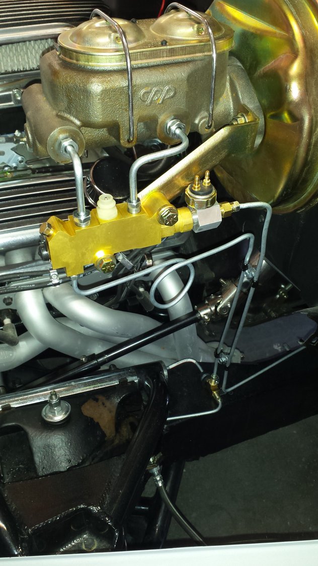

Old Feb 21, 2020 | 07:22 AM
avf100's Avatar
avf100
Joined: Oct 2010
Posts: 2,091
Likes: 599
From: Lancaster, CA.
Don't know if this will help. Here is a pic of my setup. Just eliminate the booster.
I am using the CPP bracket & peddle assy.
I don't think you can use a disc proportionate valve with disc brakes.
