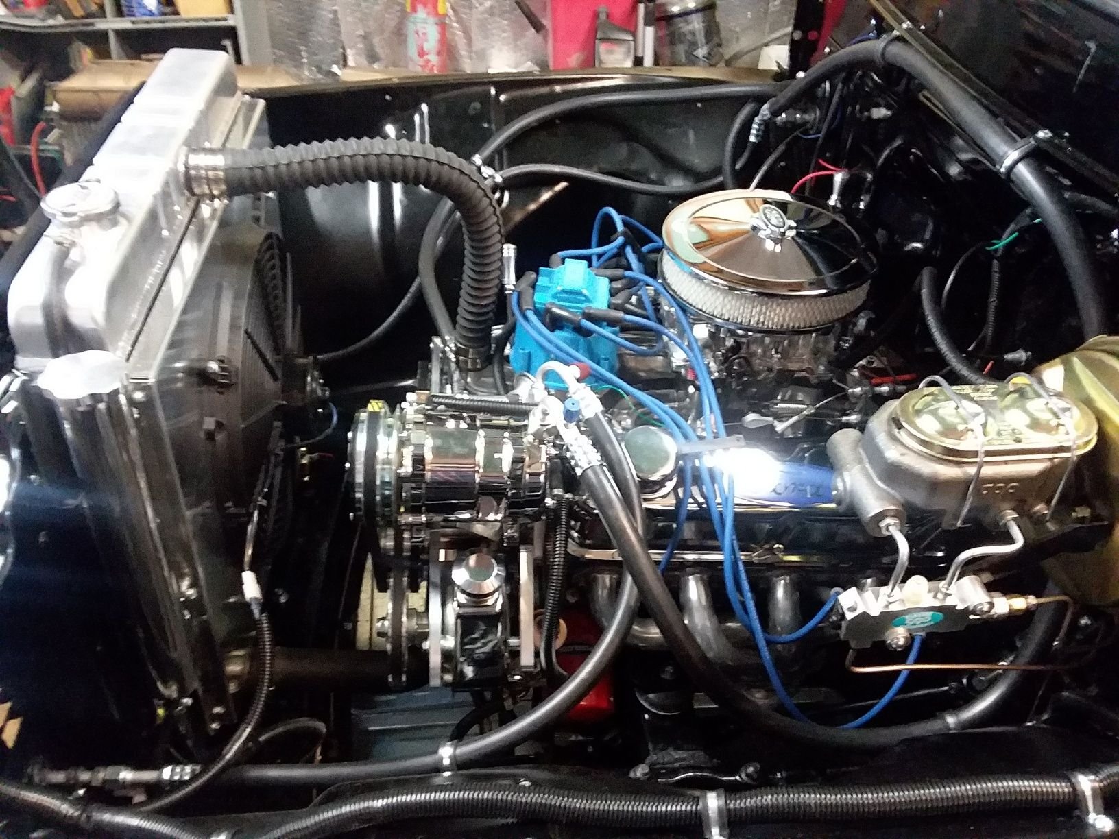

Firewall mount
Got mine at Mid fifties SUPER unit correct valve body installed---- Always used the frame mount units in my last 3 builds ( THIS unit puts them to shame) -- the only problem is the pedal is a little high, I think the price is real reasonable for this quality unit -- good luck
