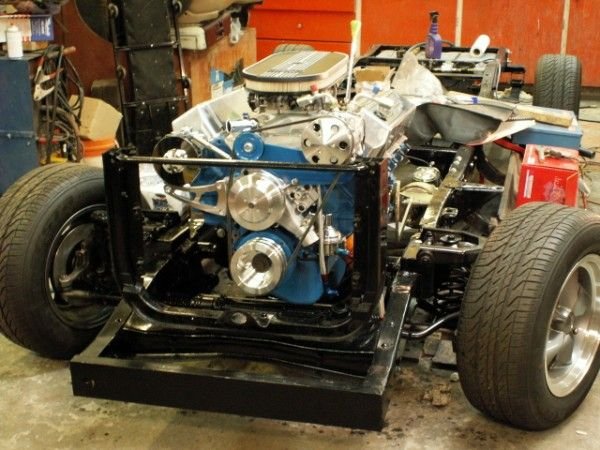

On my '51 f1. I think it was a CPP and my error but I could never get it to work right, sometimes good hard petal sometimes low soft petal, very inconsistent.
Sold the truck last year and when the guy showed up for a test drive (with me) the brakes were good, after the test drive with the city driver going too fast into corners and hammering the brakes there was none. I got his money, he got a truck with no brakes.
Sorry, only poor picture that I have of the MC, heidts economy MII.
