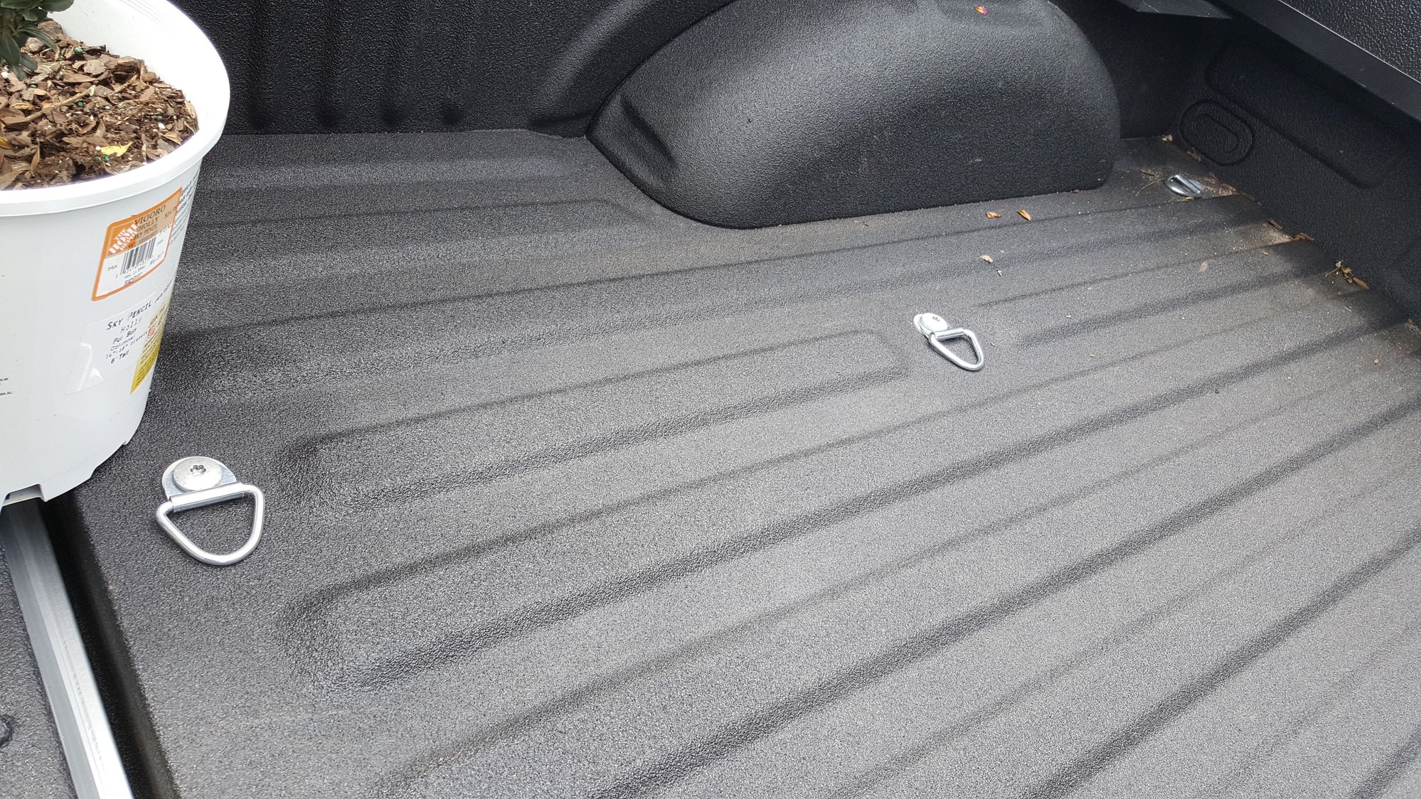

On my F150 I pulled all the bed bolts and put D ring hooks under them. Plan to do the same thing with my upcoming F350. Gives you a sturdy tie down at various locations directly to the bed.
Here's an example:

I really like that idea and would do that on my truck except Ford sprayed the bolts with bedlinen before it was delivered. I wasn't a fan of it

Thats awesome. Where do you get them? I know they're not typical D rings like the ones I'm searching for the hitch out back to allow my trailer chains to actually hook onto

Got them from Amazon:
Amazon Amazon
You have to widen the hole because the bed bolts are a little wider.

dumb question, on the newer trucks, what's the metallurgy on the bed bolts?
Just curious what material rings you'd have to buy to prevent dissimilar metal corrosion.

Not really a dumb question. My F150 had aluminum bolts and I bet the super duty is no different now that the bed was switched to aluminum too. The D rings I linked are steel and I had that same concern. I'd say best option would probably be to coat the D rings in a tough enamel, paint, or even a coat of spray on bed liner if possible.
