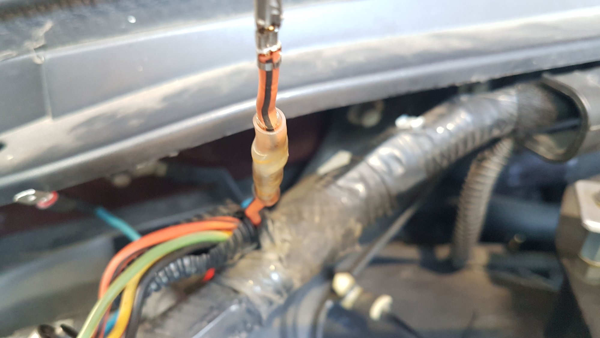

Originally Posted by Hartwig
I would not only solder. For such jobs there are crimp connectors that solder automatically when heated and seal the ends with glue.
The connectors are first crimped and then heated with a hot air dryer.
