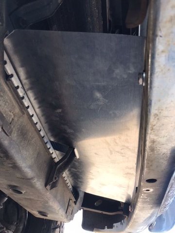

howdy, little update, so when i got this truck it didnt have the vented front bumper but i got that soon after (didnt have it when i was going up that steep grade) i made this air dam to force more air thru the bottom of the radiator, hope it helps, thanks again guys for the info and support, appreciate ya

bad fan clutch you guys were right, put a new thermostat too, didnt look bad but at least i have a baseline now of what i know to be new
