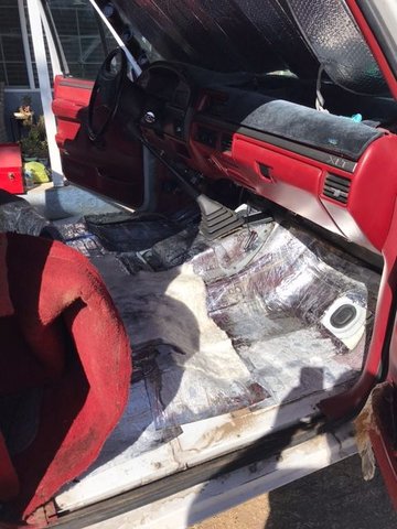

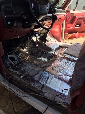

on a side note, i put down a bunch of sound deadening/heat barrier stuff (summit version of dynamat) and that really helped decrease noise level which is nice.
i also swapped my rear seat to the front as it was like new, simple little job swapping the back side of seat but more comfy. felt like a genius.
