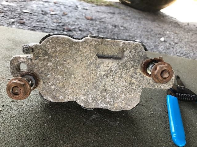

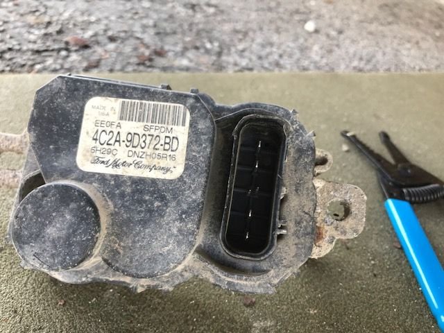

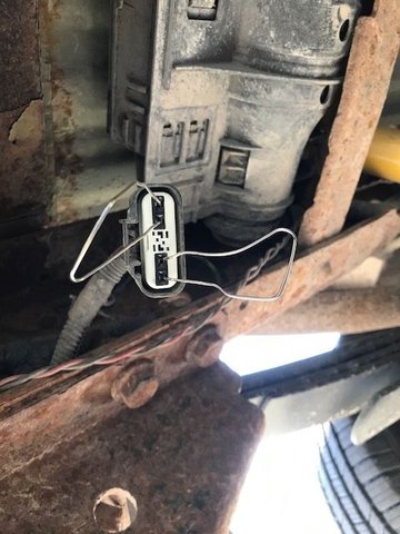

I jumpered the fuel pump driver module connector and now KOEO FPR was at 73psi.
Picking up a new pump driver module this afternoon. ***Module made a little difference. KOEO psi is around 39-40. still starts hard***
Any suggestions?
Jumper photo attached.
Front and back of module

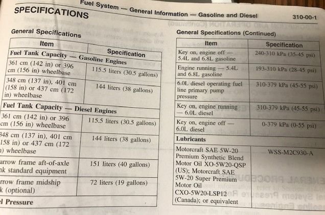

Finally found the specs from my workshop manual. It appears the fuel pressure may be ok now? Something else must be wrong also.
