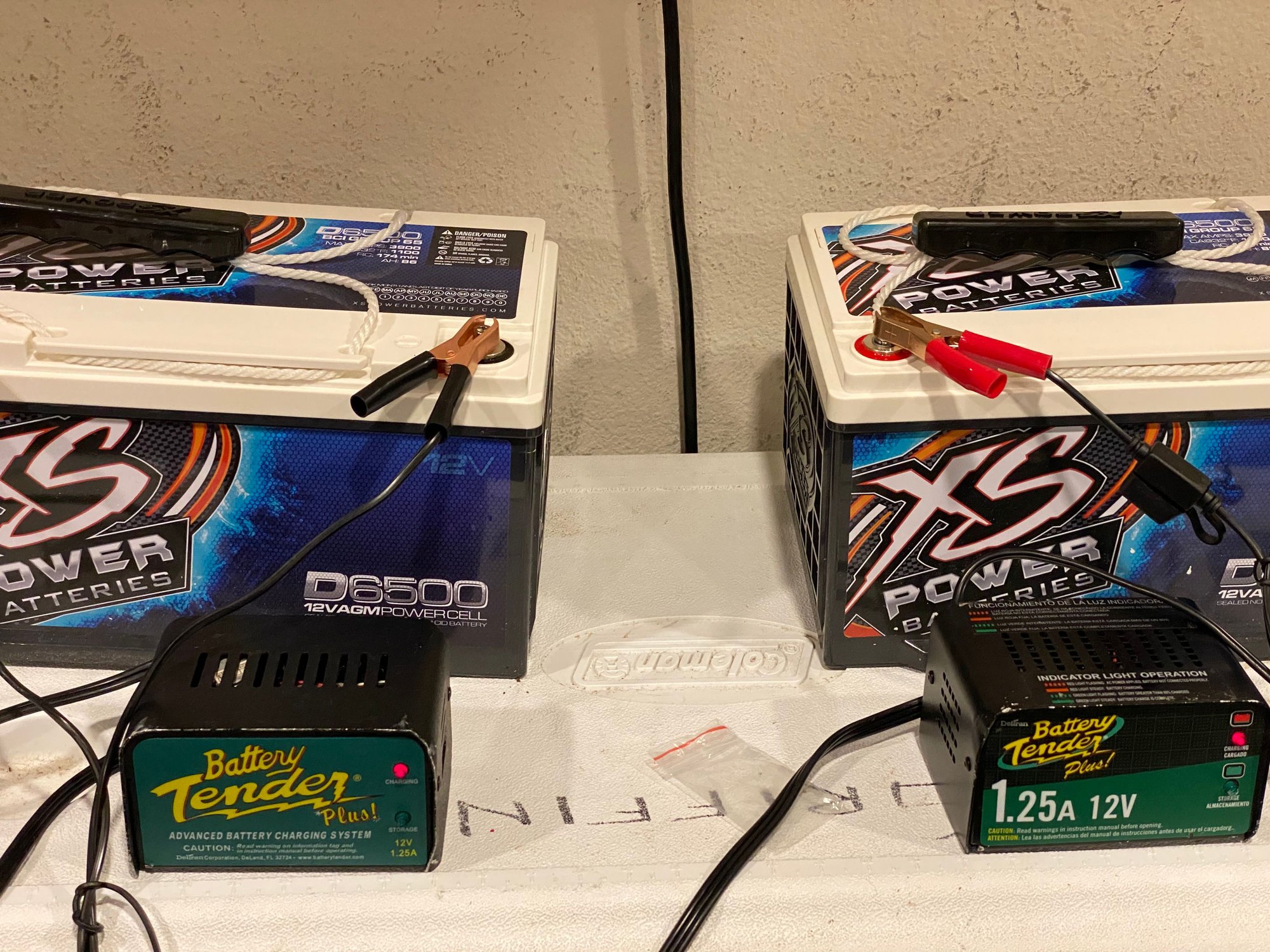

You are correct, Sir! I double-checked today before ordering my custom battery cables and discovered it WAS indeed the block heater...that scared me at first! Whew!
My starter cable is currently super beefy...I'm going to replace it regardless and continue my cable/electrical upgrade saga. Good on the outside does not mean good on the inside...without the sealed connections, lots of corrosion gets in! You should see the inside of my terminal cables at the battery...straight-up green and oxidized!
Here's a pic of the battery terminals I'm employing:
https://cdn11.bigcommerce.com/s-746g...487909.JPG?c=2
I'm going with new battery terminals and the new cables and NEW AGM batteries. One was free and the other a purchase. I love Summit Racing, their return/customer service is top-notch. Bad battery under the 3-year warranty? They ask to send them a pic of the testing receipt, and immediately shipped me a new battery!
Two new batteries now topping them off for install in the AM:
Batteries getting topped up before installing in the AM.
Here we go...
