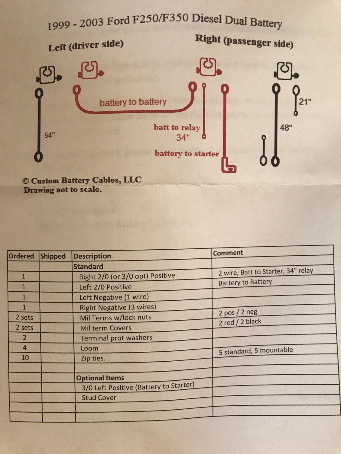

My new cables will be here on Thursday from https://www.custombatterycables.com . I spoke to Vince (I believe), and he was very nice and helpful. I ordered the 3/0 starter option. He said I was buying at a good time since prices were going up in a couple days. I guess the price of copper is increasing.
Today one of my shop inquiries called quoting me 2 hrs ($260) labor for installation ($130/hr x2). Seems like a pretty easy choice! My order is scheduled to arrive Thursday so I think by the weekend I will have this project completed, and I can move on to other wallet heavy projects.
Also, I decided to go with the Mil Spec battery connectors as I really don't have an excessive number of accessories, only my audio, and an HID headlight relay harness. I'll post pictures when it's complete.

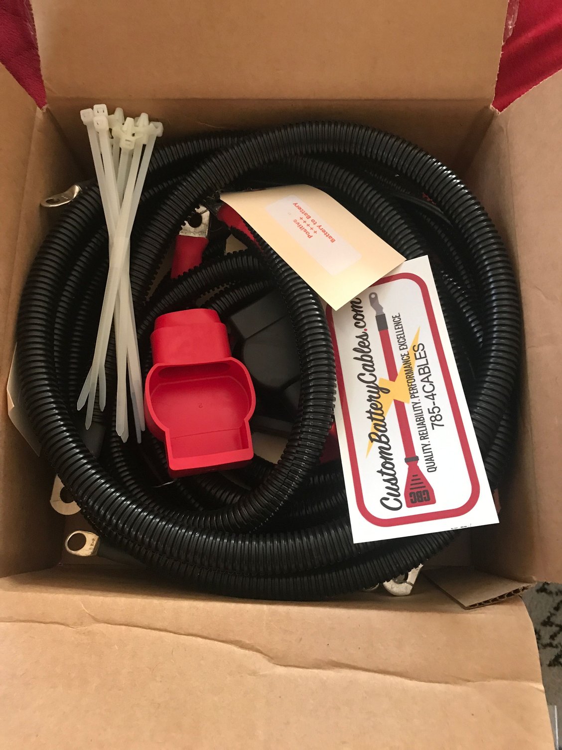

New Battery Cables
Just arrived today from Custom Battery Cables https://www.custombatterycables.com. I purchased the 3/0 starter battery cable set. Hoping to have them installed tomorrow and I'll get a couple pictures to share so stay tuned!

Rainmaker,
I did this exact job on my 04, it is really easy. The hardest part is getting to the nut holding the harness between the starter and the front of the engine. Took me about 2 hours to get the entire job done by myself and I wasn’t working very quickly. The nut I did not reinstall. It was a factory cable so yours might be a little stiffer than the original.
Good Luck
Jeff

Installed !!
New Battery cables installed today. I was in awe with the improvement new bigger cables make. The engine turns faster and acceleration seems improved.
