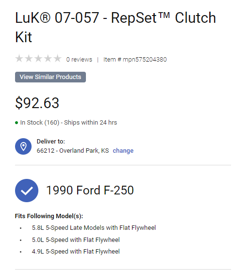

The LUK clutch kit apparently fits all three engines...so theoretically the RAM should also? I did see one mention that although the 300 flywheel was drilled for an 11" clutch, the holes take a different bolt than the 10" pattern...not sure if that is true, but one more thing to cross of the "checked" list...
