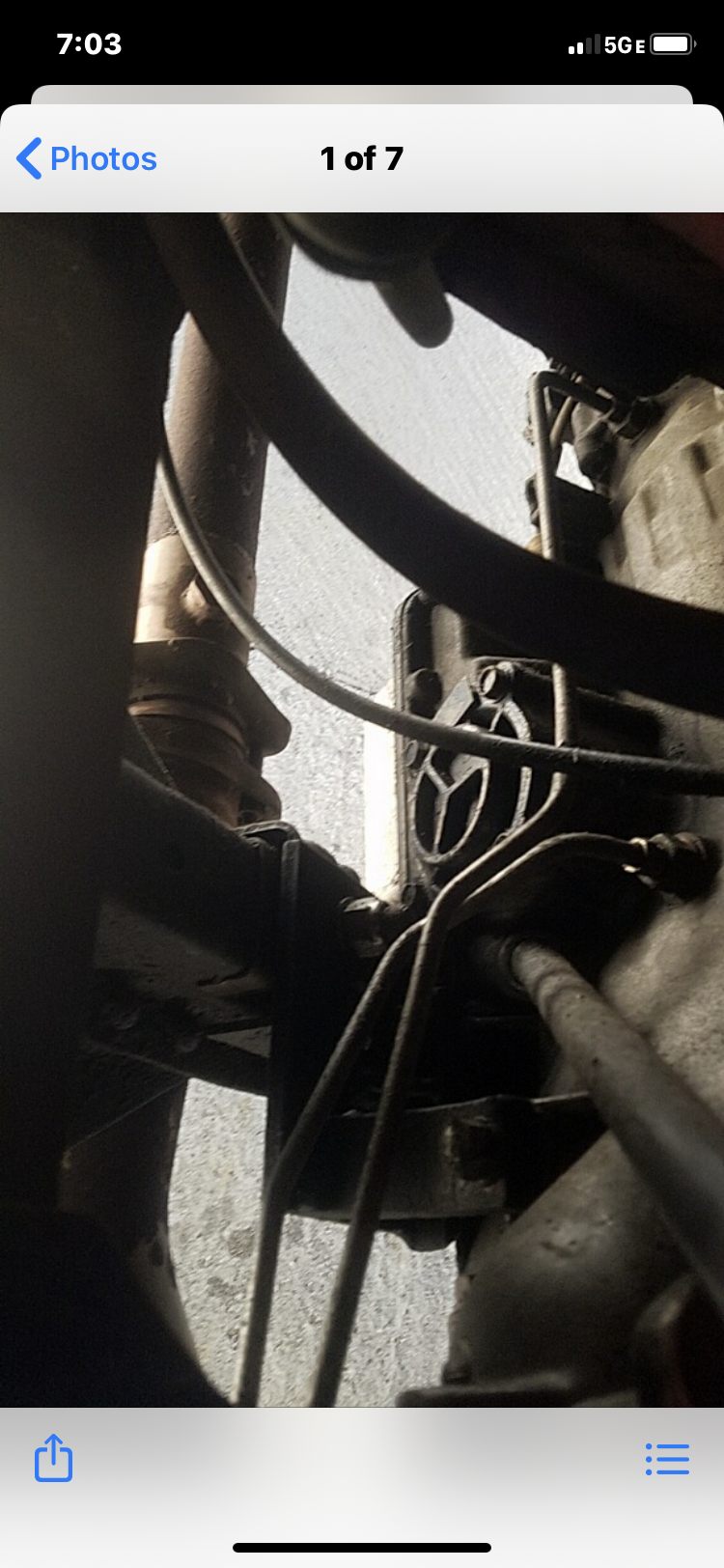

Hey folks first post here I think after looking around here for some time now. I’ve finally run into a problem I can’t seem to resolve. I’m trying to find a C6 for an FE engine that has the mounting bosses cast at the front of the pan area right where the bellhousing transitions into the body of the transmission. These were utilized using the mid mount where as the transmission basically hangs in the air. They will have the fixed/bolt on yoke. I’m wanting to use one in my 1963 F250 4X4. The transmission casting that I do know exists has casting number on the transmission case
D0TP-7006-A. If anyone knows where I can get one or two of these please let me know. Bracket pics I’ll try to include.

Craig, the gentleman that sent me the pics has it behind a 428. He’s never seen another one either.
The brake came off of his original 1958 automatic out of his truck so doing it this way was 100% bolt in even the driveshaft bolted back in.

I think you are right, those brackets were used on F and C 600's with the 300/C6. Not many were made but they did exist.

I wonder if the Highboy transmission is what you are after, or will work? Later in date, but as I stated mine has a mounting hole in the spot you state. I am pretty sure the same general design was used from 60's into 70's.....a lot of the drive line parts were the same across the body styles of the F250 4x4s anyway. I know they have some quirks other, later, C6 cases do not.....that part has a D1-TA in it so it appears to be 71-Truck. I just looked at some of my C6 build pics and but all I have is a side shot of the case. The holes I am refer too were on the side and on the bell part. Not on the part in from of the pan. There is not a lot of space there.

d0tp-7006-a. Is the case casting number! It is special. The drum brake did not come on this transmission! It was installed from an original Fordomatic from the 50’s as stated. Thanks for all of the responses. I believe this to possibly be an exclusive U-Haul item. Does anyone have a pic of a C6 from behind a 330 XD or any other FE powered UHaul? Jim

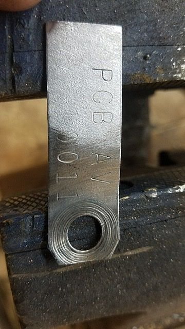

Tag from transmission in question. All the info I have and this is the only tag on it. The number is 10011.

D0TP-7006-A. Is the case casting number! It is special. The drum brake did not come on this transmission! It was installed from an original Fordomatic from the 50’s as stated. Thanks for all of the responses. I believe this to possibly be an exclusive U-Haul item. Does anyone have a pic of a C6 from behind a 330 XD or any other FE powered UHaul? Jim
Casting number: D0TP-7006-A = Ford part number: D0TZ-7006-A .. C6 Transmission Case - 1970/71 F600 330 2V

Thank you NumbersDummy. Mounts show up as M450/M500. The case was the hardest part to decipher. Thanks for the final piece of the puzzle. Do you have one laying around by chance?
