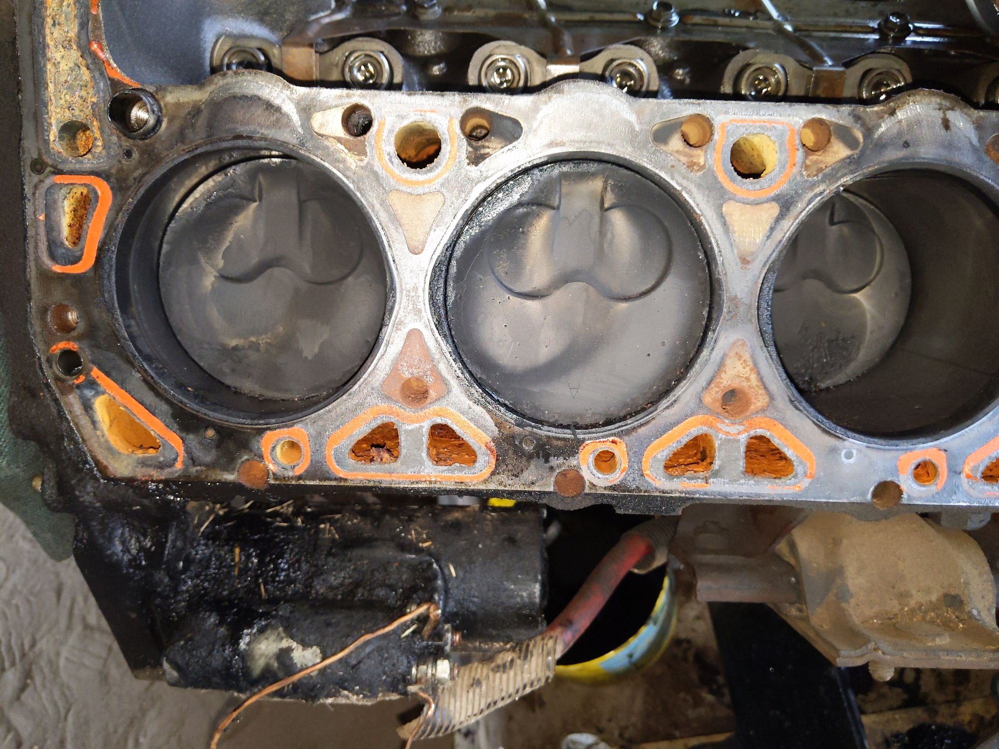

So good news! Was doing some reading up and don't know how I didn't realize that my cylinders are glazed over and I needed to get that off to see what I've got.
One guy was using steel wool and wd40, that left scratches so I couldn't tell. Used wd40 and a brass brush and this is what I got..
I think it's plenty good to ball hone and rering with custom filed rings. I will need some good standard bore 6.9 pistons though..
Passenger side didn't look as bad though
They also do have head damage though...

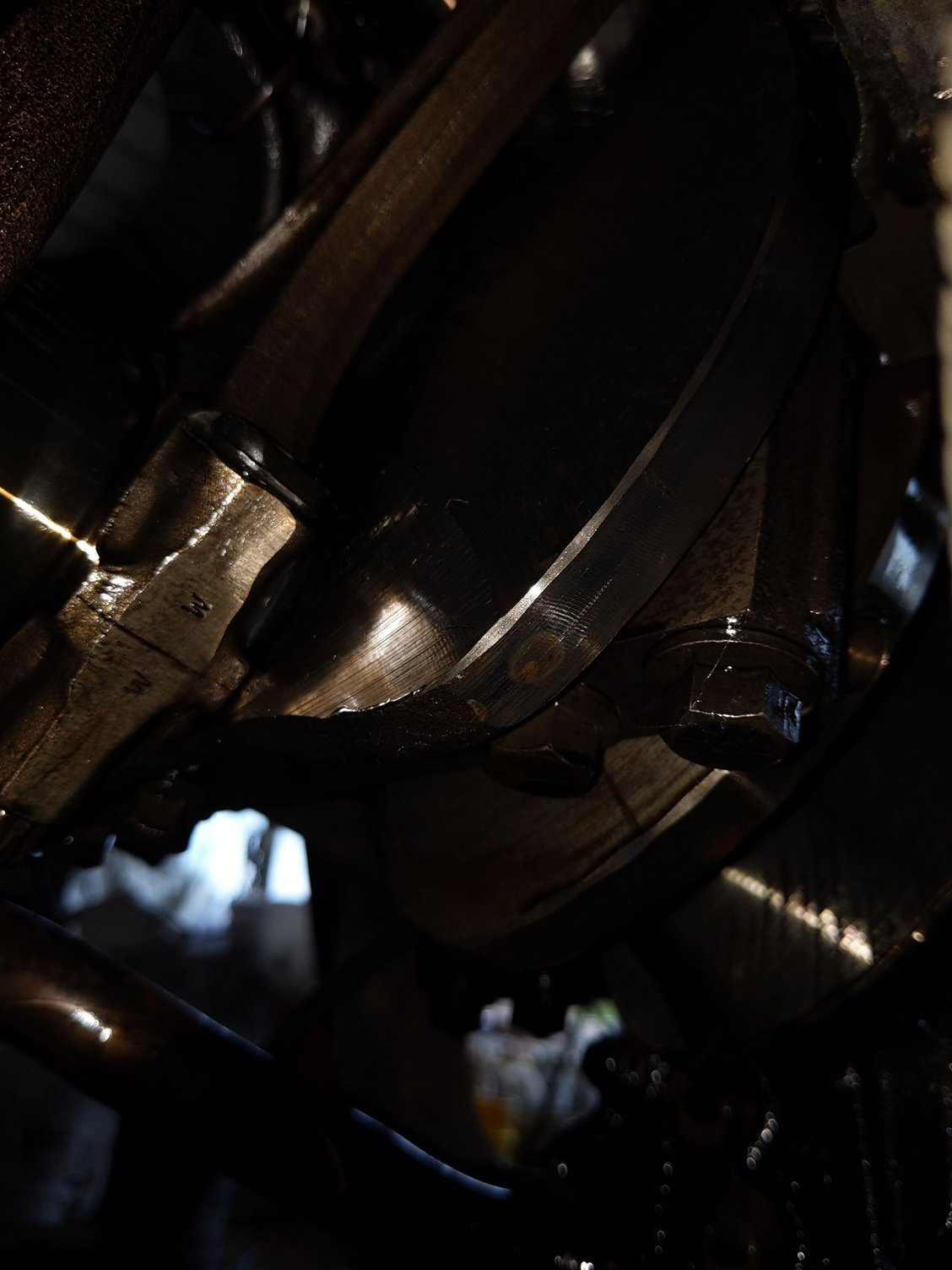

But yeah, rod bearings looked great and the mains were only down to just a really small spot in copper. The crank looks all shiny too
Sounds like I need to get online and start ordering parts...
