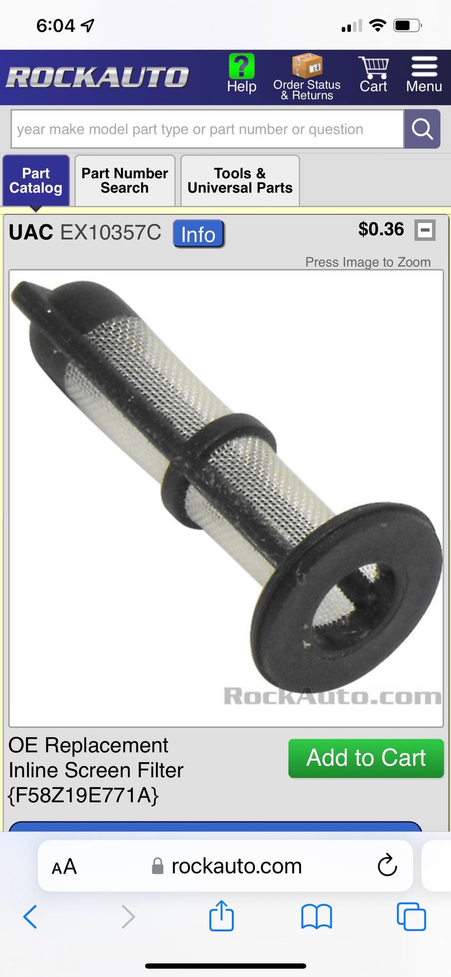

There is no "filtration" of the Freon to the rear system, .
actually there is a replaceable filter/screen for the rear before the Txv. It is underbody on the small metal tube at the spring lock quick connector.
i just changed mine along with the TXv and rear evaporator
Yeah, I caught that when you posted earlier. Now you have me wanting to go back and replace it. I'll wait till I have an Issue, it's probably clean as the rear works really well, and the front strainer was barely dirty. I've opened up my system probably 4 times now since I bought it, 3 times just in the last year.
