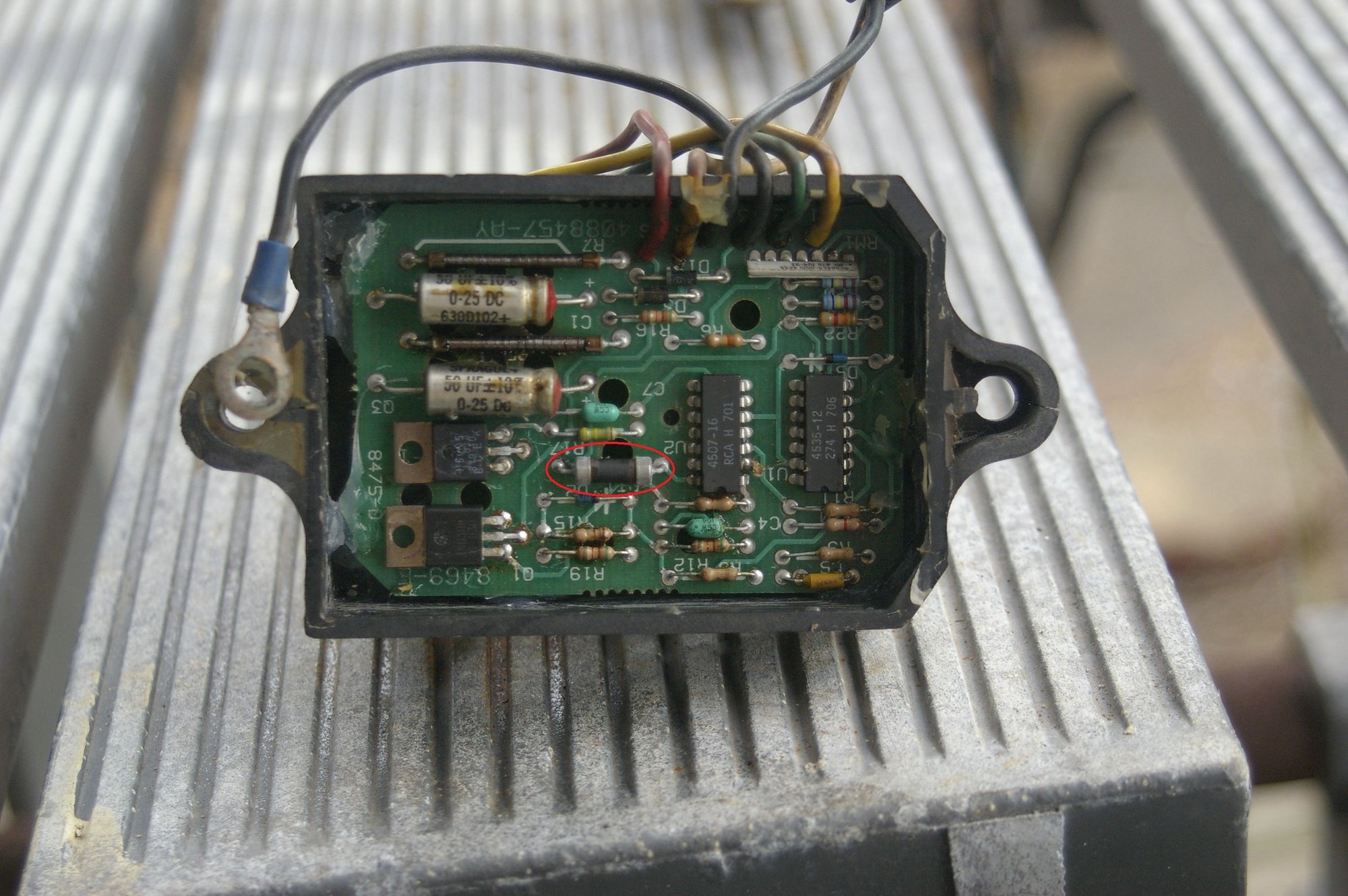

The Thermistor that senses the Glow Plug Controller Temperature is Located about center of the PCB of the controller itself so you cannot Relocate the controller to a Cooler area as this will cause premature Plug Failure if you do.... current sensing is done by reading Voltage across the Shunt.... the Buss Bar looking thing and using wrong Plugs will change the Current readings and the controller will fail and destroy Plugs.

yeah that Location still gives enough heat for the Thermistor in the Controller to work
I'm not trying to say you cannot mount the controller on a fender well... you can mount it any place you want, I'm just saying the reason it was mounted on the engine is to detect engine Temperature.
here is one I have repaired in the past.... the Thermistor is circled in Red......
