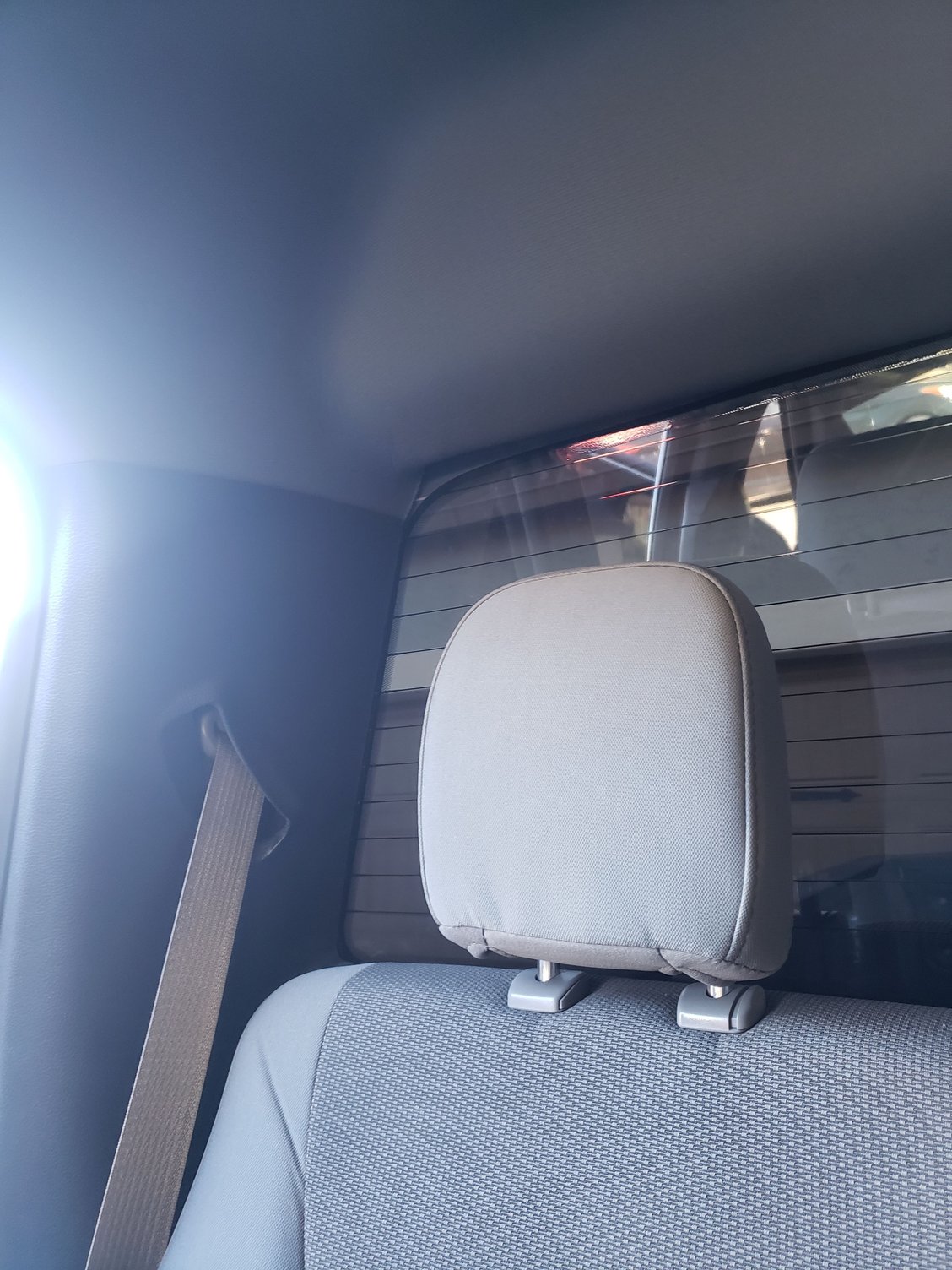

  3. Replace the Tire Pressure Monitoring System Receiver with the new one. (It is located inside the vehicle, on the passenger side, along the top corner of the rear window under the headliner. Its directly above the passenger headrest. I have not been able to add a pictures yet. I will continue to try later this week. I just gently pulled the headliner a few inches away to expose the module. The module snaps in place from the rear. Then unplug it. Install the new module.)
