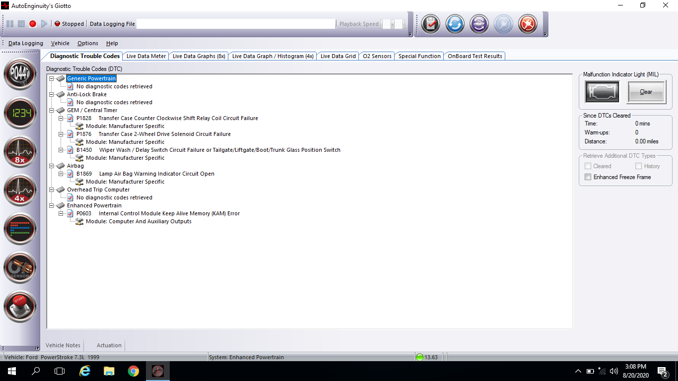

I'm going to post my trouble codes from my Auto Enginuity scanner. This is the first time I've used the tool so I am not familiar with all of its functions.
I was suspicious of GEM before, and it looks pretty clear here but I would like another set of eyes on it before I shell out the money for a new one.
Also, the transmission light (on the shift ***) is blinking. Could this be part of the GEM issues?
The help is much appreciated. This truck is a fraud case. The odometer was rolled back and has many problems that I am trying to sort through now. Unfortunately, with COVID and race riots, the police and lawyers aren't being very motivated to resolve it. I guess I'll just move on and fix the POS. This is the first of many diagnoses I'm sure. If you have any suggestions for this scan tool, let me know.
Thanks!

AE should be able to pull the trans codes....that is what the blinking OD is telling you. You need Ford Enhanced on AE to get them.

I have the Ford enhanced. Do I need to specifically select the transmission sensors or should they have shown up in that list of codes?

What is the model and year of the truck?
Are you having issues with the transfer case shifting and with the wipers?
If you clear the codes, do they come back again? Want to make sure they are current codes.
If these issues are current, you can pull the GEM out and look it over for water damage. They can fail from a windshield water leak.
You can also run through the pinpoint tests in the service manual to isolate the GEM as the cause from several other possible causes (wiring, shift relays, transfer case encoder, connectors).
Some good information in the Tech Folder at the top of this forum, Electrical section, for troubleshooting GEM issues.

Its an early 99, F350 PS, Crew Cab, Long bed (looks like yours).
The transfer case selector does nothing at the moment. The wipers come on but they are erratic, sometimes stopping mid way and resuming seconds later.
I have never tried to clear the codes, this is my first time scanning it.
I have heard about the GEM failures because of water. I haven't inspected it yet, I will this weekend. Unfortunately the truck is total fraud and is not what it was reported to be. The odometer was tampered with, and I doubt they took care not to damage other parts ion the process. The interior has started to smell musty so I am suspecting a flood or leak in its past.
I did not know about the pinpoint test but I will definitely find it and perform that test. These GEMs are neither cheap nor easy to find. If I need a new one, It looks like I'll have to order from a dealership that can use a VIN check to verify compatibility.
Thanks you for taking the time to reply. It's a big help. This is my first personal use diesel, and its a dud so far.

I don't see obvious signs of GEM failure at this point, but it is possible. I think you have some auxiliary system issues, not a GEM failure.
There are also pinpoint tests for the 4WD system in the tech folder. Work your way through the pinpoint tests and get back to us.
